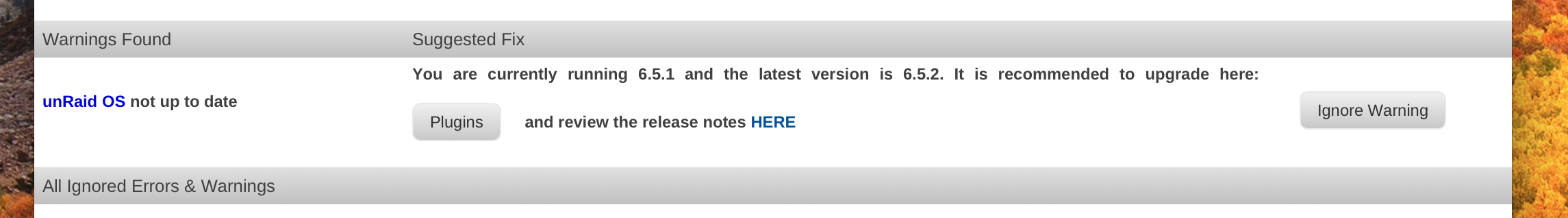

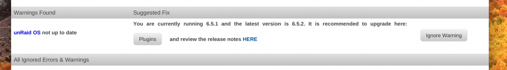

Probably a know issue. The update button of unRAID in the CA is still pointing to the plugin tab and not to the tools tab. Not sure if this has something to do with backwards compatibility. I don't know when "updating unRAID OS" was moved to the tools tab.
