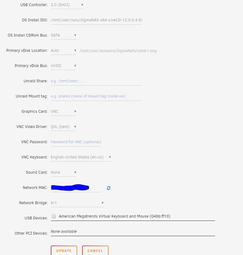

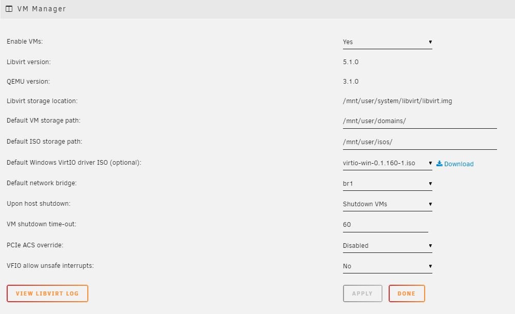

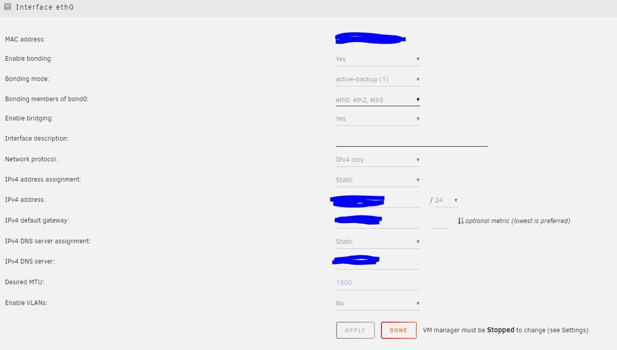

I am searching everywhere on the forums, youtube, and online to find a tutorial on how to get a VM network bridge working but I cant find it anywhere. If someone has a link please share but for now here is what I am trying to do and what I have done so far maybe someone can help.
I am trying to get a virtual NAS program to run inside unraid so I can copy data from it to unraid before deleting its partitions and then giving the rest of the disks to unraid. I have to do this because its all inside one chasis.
The issue I am running into is that when I get the NAS program VM up and running inside unraid it doesnt see a network interface and the router is not pingable. I have attached screenshots of my various unraid screens but any tips would be appreciated on what I am doing wrong.

A couple of things. i see in the vm template you are using br1 as the brigde try br0
If that doesnt work then i  am wondering if the vm you have created doent recognise the virtio nic type that is used in a vm by defualt.
try editing the vm xml. goto the template and toggle to xml view in the top right and change the follwing. You will see in the xml something that looks like this
   <interface type='bridge'>
      <mac address='00:00:00:00:00:00'/>
      <source bridge='br0'/>
      <model type='virtio'/>
    </interface>
this line here is the nic type (virtio here)
opps pressed post by mistake . Anyway carrying on from above. Change it to
<model type='e1000-82545em'/>
This is an emulated intel nic. That then may work in the nas vm

took down the VM and changed it to br0 no change
then i edited the xml to the emulated NIC and still no change
If I go into the shell for the nas OS shouldnt I see a NIC of some sort? All I see is this
Do you have any idea of what NIC types are supported by the VM?
