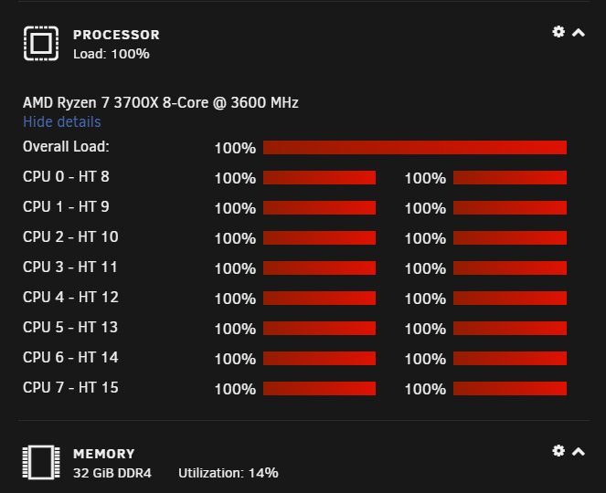

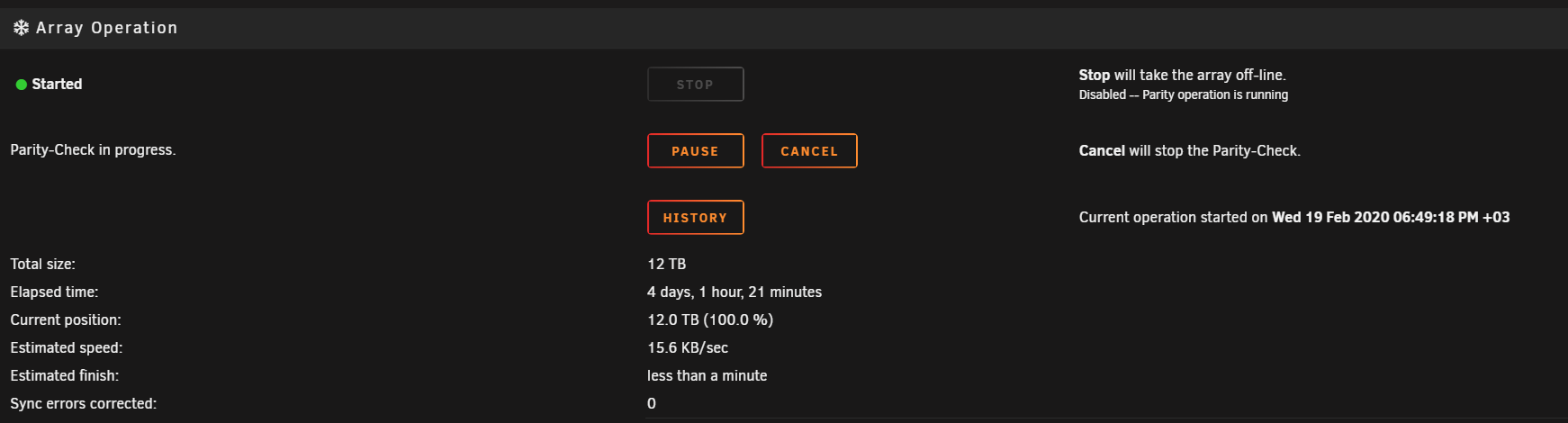

* Parity is stuck now for the third time in a row 😞.
so the parity check will take 3 whole years to finish 😞
so this is the 4th time I tried to operate the parity then got stuck.

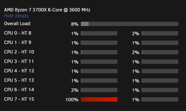

* I just notice one of the threads is stuck also!

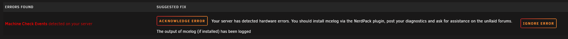

but now Fix Common Problems detect hardware errors after suddenly the parity check triggered!:
error logs:
Apr 16 11:57:06 MoathCenterr kernel: mce: [Hardware Error]: Machine check events logged
Apr 16 11:57:06 MoathCenterr kernel: mce: [Hardware Error]: CPU 10: Machine Check: 0 Bank 5: bea0000000000108
Apr 16 11:57:06 MoathCenterr kernel: mce: [Hardware Error]: TSC 0 ADDR 14798839663c MISC d010000000000000 SYND 4d000000 IPID 500b000000000
Apr 16 11:57:06 MoathCenterr kernel: mce: [Hardware Error]: PROCESSOR 2:870f10 TIME 1587027393 SOCKET 0 APIC 5 microcode 8701013
Apr 16 12:07:25 MoathCenterr root: Fix Common Problems: Error: Machine Check Events detected on your server
Apr 16 12:07:25 MoathCenterr root: mcelog: ERROR: AMD Processor family 23: mcelog does not support this processor.  Please use the edac_mce_amd module instead.
Apr 16 14:13:07 MoathCenterr kernel: Plex Script Hos[29328]: segfault at 0 ip 000014f2ee0a8d37 sp 000014f2e540e130 error 4 in libpython2.7.so.1.0[14f2edf71000+19f000]
Can it be CPU failure? 😥

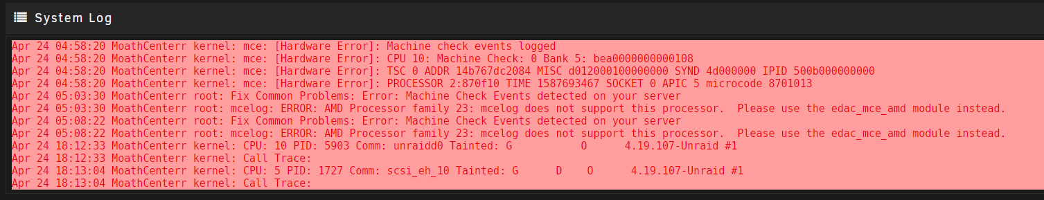

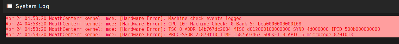

This is become annoying:
Apr 24 04:58:20 MoathCenterr kernel: mce: [Hardware Error]: Machine check events logged
Apr 24 04:58:20 MoathCenterr kernel: mce: [Hardware Error]: CPU 10: Machine Check: 0 Bank 5: bea0000000000108
Apr 24 04:58:20 MoathCenterr kernel: mce: [Hardware Error]: TSC 0 ADDR 14b767dc2084 MISC d012000100000000 SYND 4d000000 IPID 500b000000000
Apr 24 04:58:20 MoathCenterr kernel: mce: [Hardware Error]: PROCESSOR 2:870f10 TIME 1587693467 SOCKET 0 APIC 5 microcode 8701013
Apr 24 05:03:30 MoathCenterr root: Fix Common Problems: Error: Machine Check Events detected on your server
Apr 24 05:03:30 MoathCenterr root: mcelog: ERROR: AMD Processor family 23: mcelog does not support this processor.  Please use the edac_mce_amd module instead.
Apr 24 05:08:22 MoathCenterr root: Fix Common Problems: Error: Machine Check Events detected on your server
Apr 24 05:08:22 MoathCenterr root: mcelog: ERROR: AMD Processor family 23: mcelog does not support this processor.  Please use the edac_mce_amd module instead.

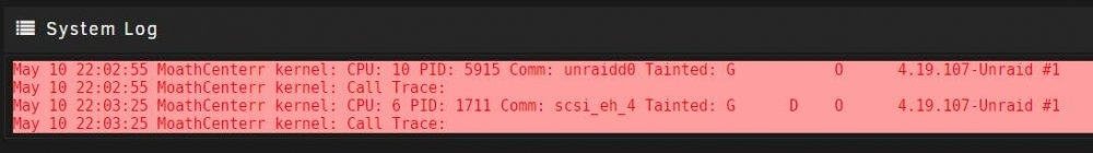

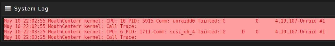

Apr 24 18:12:33 MoathCenterr kernel: CPU: 10 PID: 5903 Comm: unraidd0 Tainted: G           O      4.19.107-Unraid #1
Apr 24 18:12:33 MoathCenterr kernel: Call Trace:
Apr 24 18:13:04 MoathCenterr kernel: CPU: 5 PID: 1727 Comm: scsi_eh_10 Tainted: G      D    O      4.19.107-Unraid #1
Apr 24 18:13:04 MoathCenterr kernel: Call Trace:
That's a hardware issue, most likely RAM, CPU or board related.
I changed the RAMs, GPU and motherboard, so most likely CPU issue!
or could it be RAM not supporting AMD CPU?
Edited by Muath

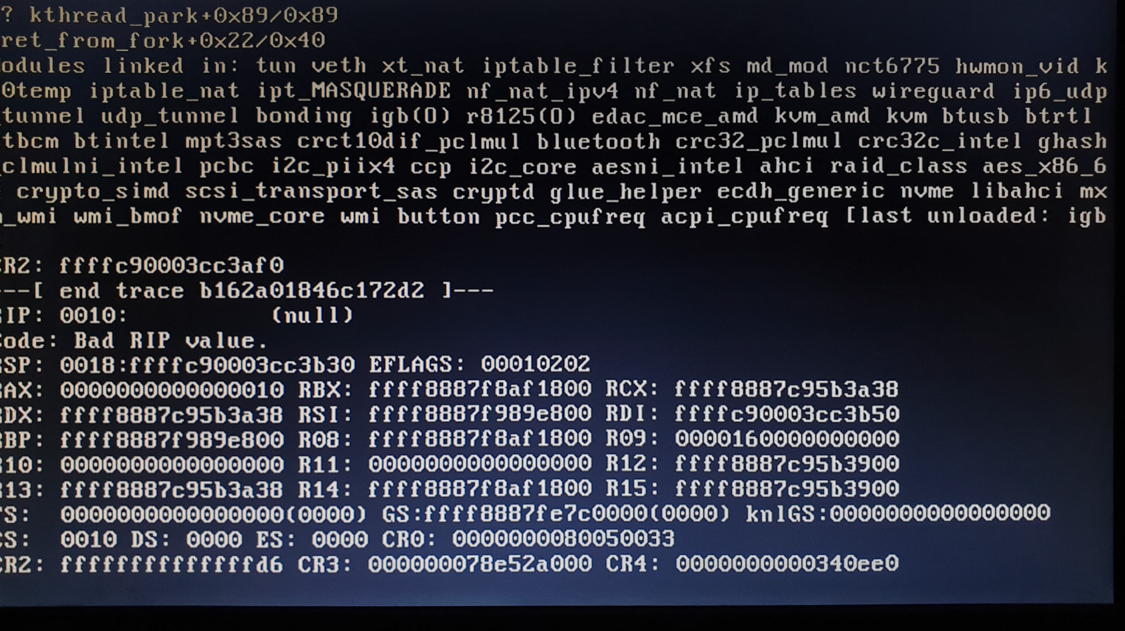

2020-07-07 - OS suddenly shut down and the message below shown:
