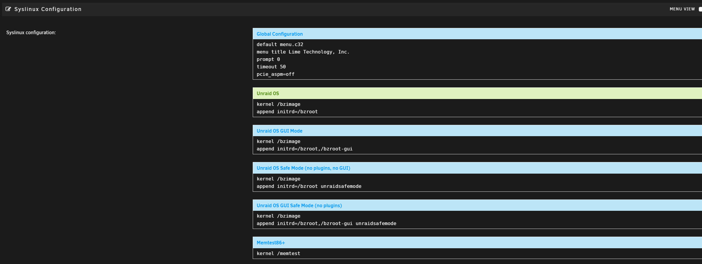

once i select memtest86+ it goes black for 2sec then returns to motherboard manufacturer's logo!
That's a symptom of UEFI booting. You need to legacy boot to be able to select MemTest86+ from the boot menu.

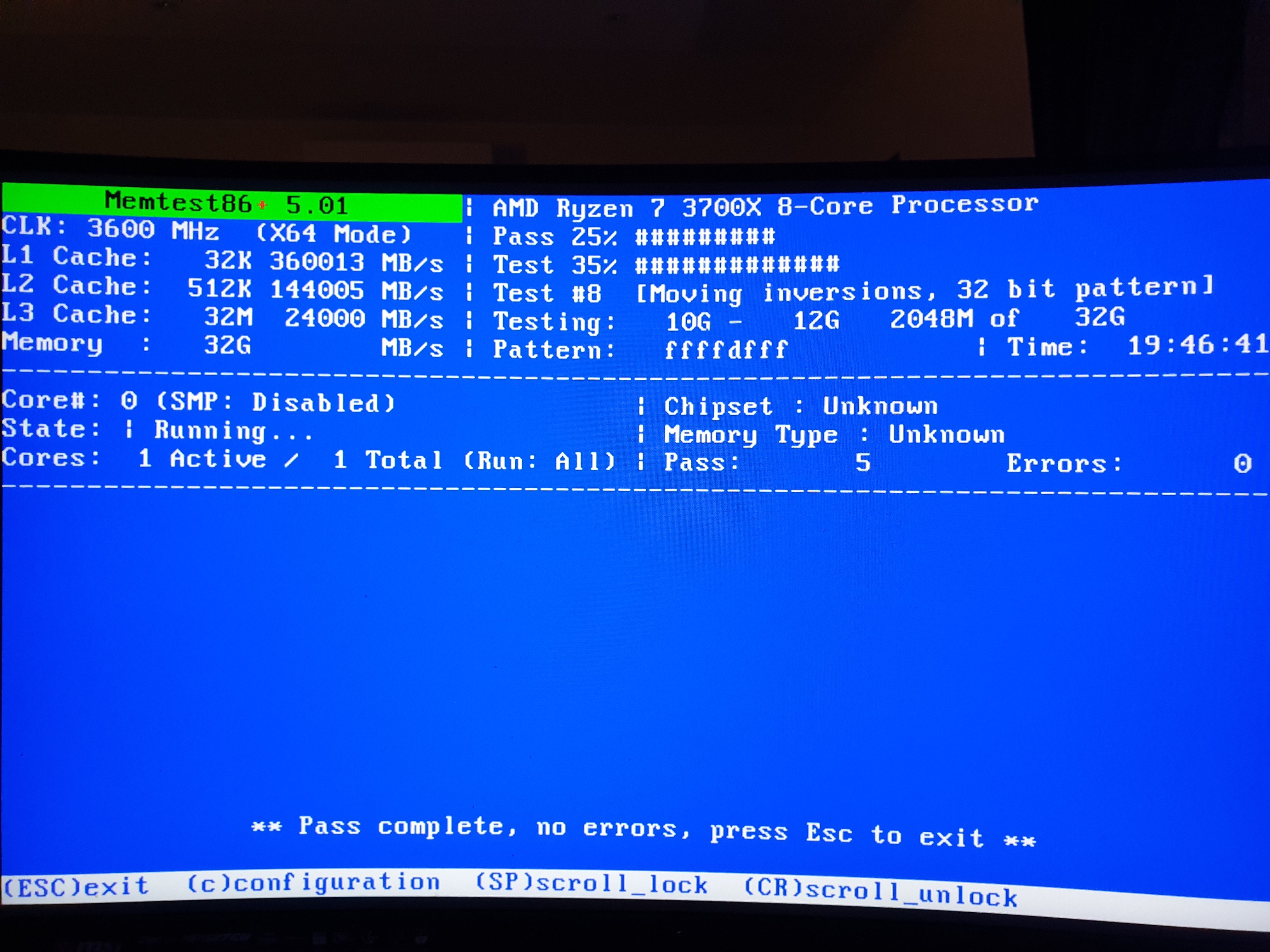

so now based on the photo did my RAMs passed the test? or should i leave it for more time? or is there some specific test i should try?
No errors so far, which is good. I'd let it run for 24 hours or more.

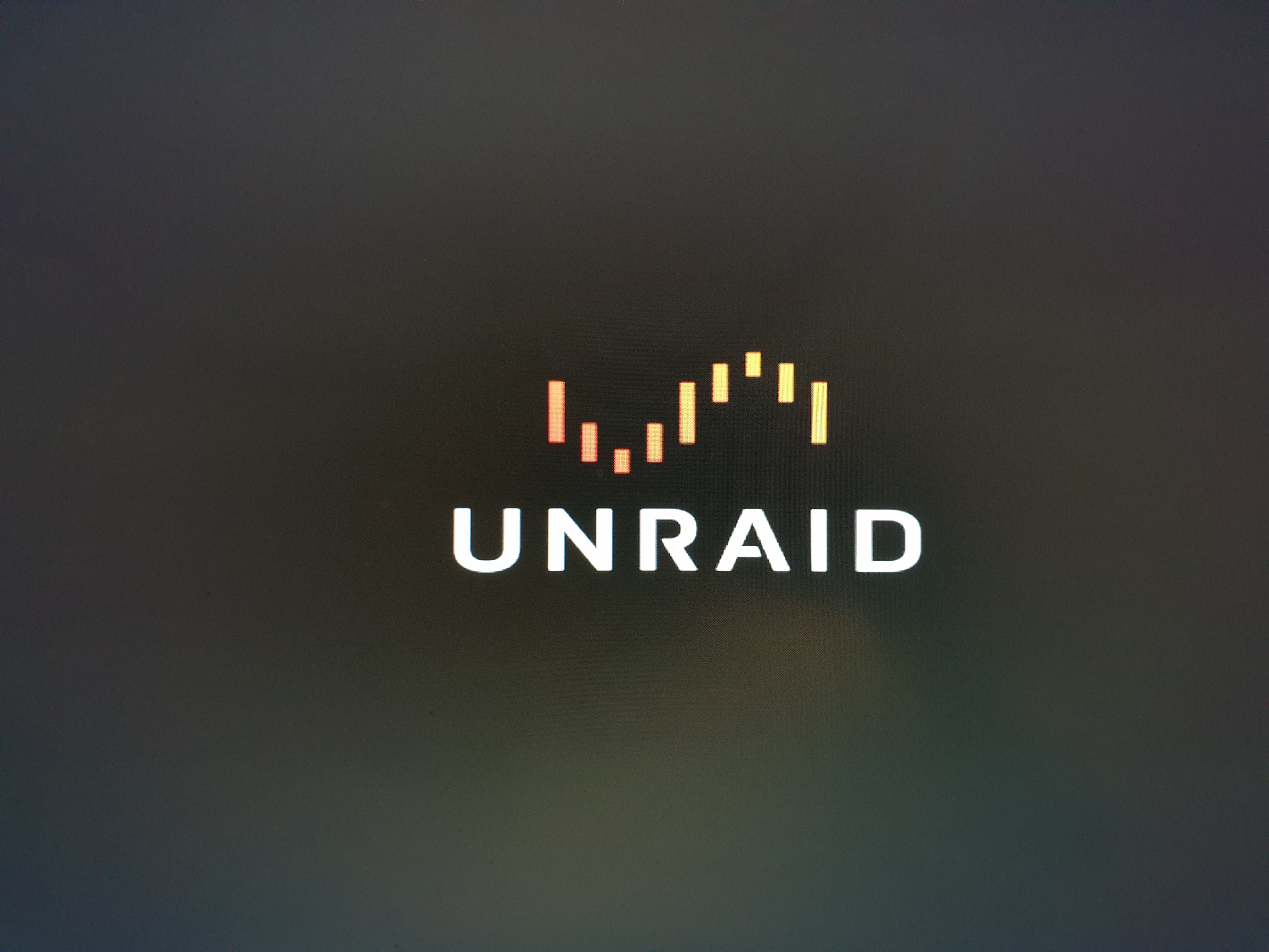

I ran the test for more than a 24h and no errors. but still, I'm kind of facing the same issue.
now I'm on 6.7v which at least I could use it before it hangs but then after less than a 24h it hangs but now I can navigate UNRAID page but I can't run firefox also when I command (reboot) it doesn't respond and reboot the system!.
Maybe the USB flash what causing this issue? even though it's new and USB 2v which is the recommended.
when I logged out it showing me UNRAID logo without option to log in (as the photo attached)

Well .. I've updated the BIOS and now it's not working at all 😔💔
What do you get when you try to boot now? Possibly it is just a case of the BIOS resetting so it isn't trying to boot from the flash now.
I've set to boot from the flash, but after the motherboard logo and attempt to boot UNRAID it goes into a black screen and all the fans work weirdly some fans speed up and other slow down or even stopped, and when I try to forcibly shut it (via the button), it does not respond!
so the only way to shut it down is by PSU!
I'm thinking maybe all these issues from the motherboard (ASRock X570 Steel Legend).

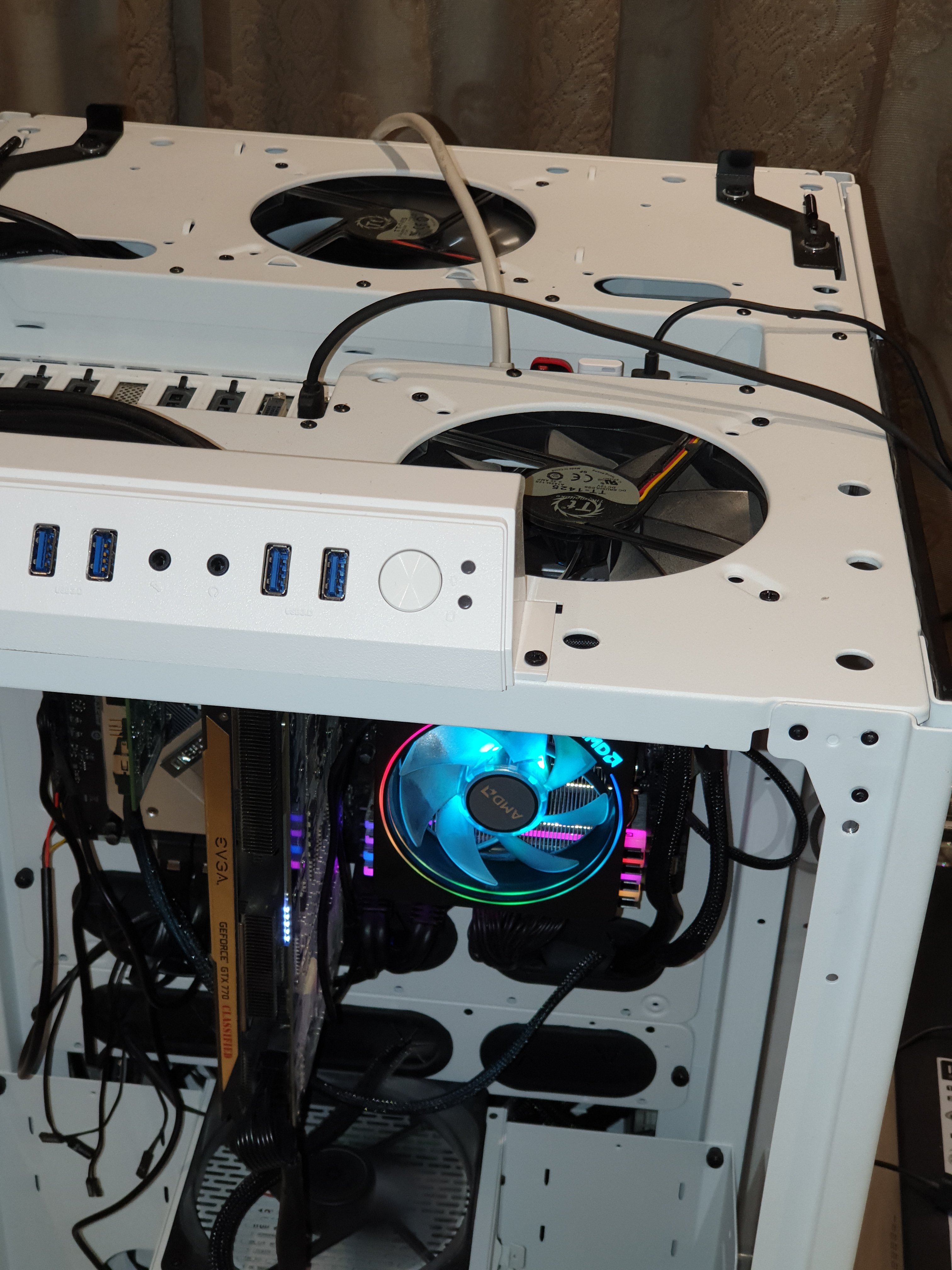

*I remember now, any fan connect to the Motherboard don't work properly, as the picture show now CPU fan doesn't work at all after booting UNRAID.
GPU fans working fine.

sorry I didn't update my current situation, I tried to clear the CMOS then update the BIOS but didn't work, then I tried to update the BIOS to a different version and still not working, then I returned back to release version and it worked and the system boot-up!. (BIOS Update page.)
then the main issue happened again to me, so after some search seems there's an issue with ASrock motherboards with Linux in general, but there's some suggestion to fix the issue one of which:
pcie_aspm=off to "Syslinux Configuration" (not sure if I did it correctly kindly see the picture if it's correct or not)
so now server will work for a couple of days or so, then OS will stop (the main issue).
Not sure but I think that would need to be added to the append line.
at first, I added it to the append line but then the OS won't boot up.

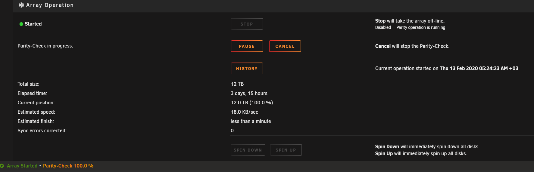

a quick update on my issue here, so this issue is still occurring every two weeks~  (since the server working fine the rest of the almost two weeks I adapt to this issue)
after last hang parity-check triggered due to forcing the shutdown, now the parity-check is stuck!!
* This is not the first time happen to me, when I tried to reboot it will hang

Can't see nothing on the log to why it's stuck, what happens if you pause and then resume?
Below link is a recording when I tried to pause it, and when I reboot or shut down using the system it hung so then I force shutting it down.
