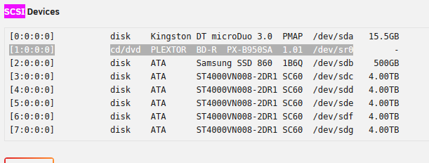

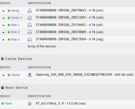

That metric of disk placement is only marginally useful with unraid. You need to keep a list of drive serial numbers and the corresponding slot assignments, parity, diskX, cache. A screenshot of the main GUI tab is one way of doing that. The /dev/sXX designations can possibly change from boot to boot based on timing or a drive failing, and will change if you modify hardware. Unraid doesn't care about /dev/sXX at all so it can be migrated to different systems without data loss. All you need is your drives, what system they are plugged in to doesn't matter as long as unraid can match up the serial numbers reported by the controller.
This is one of the huge advantages of unraid over traditional RAID management systems.
Oh, thank you.
So with this information I can rebuild the raid on any computer:
Any computer with a standard disk controller that doesn't mangle serial numbers.
