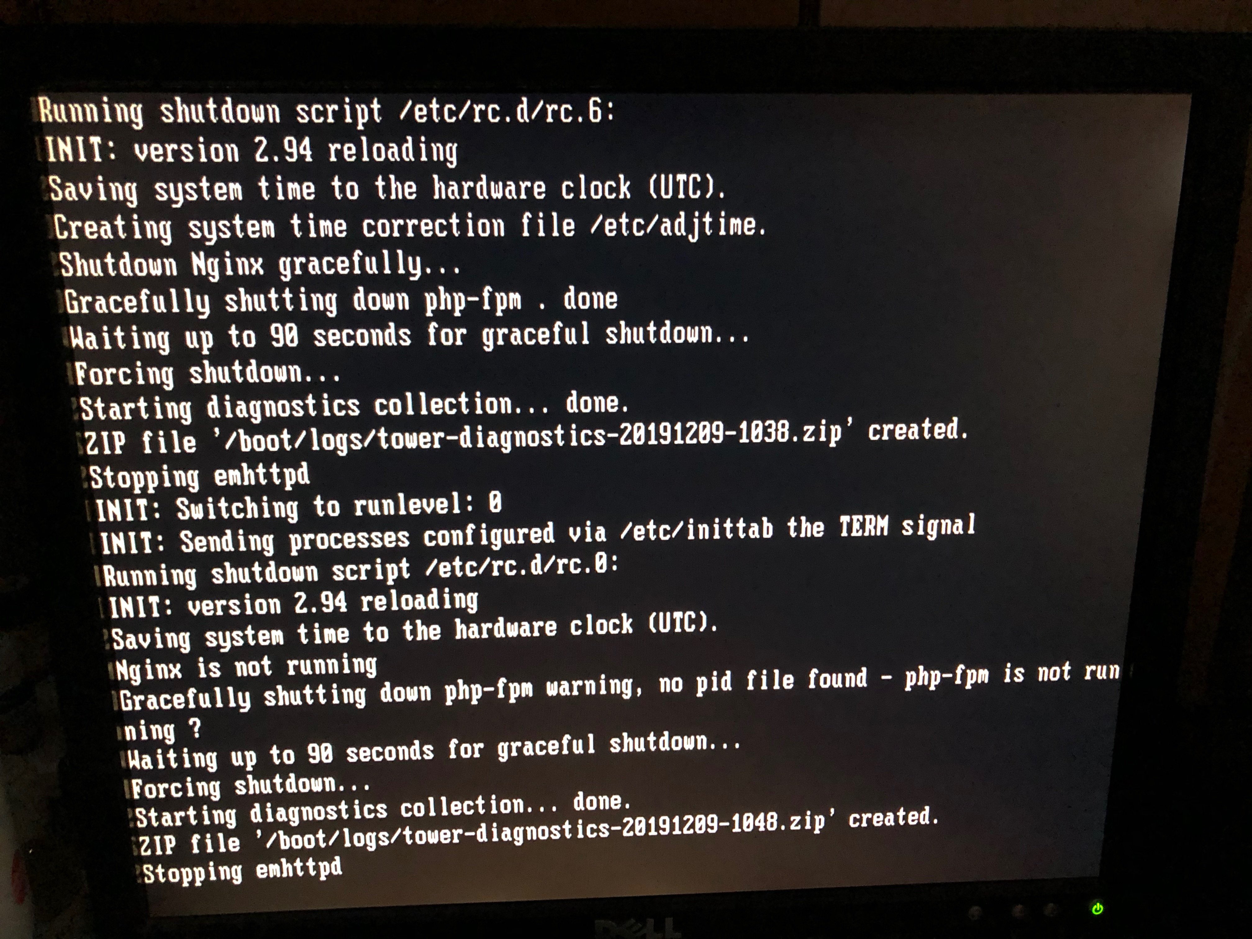

Sorry but I'm quite inexperienced at unraid, and I'm in a bit of a mess...
I was having issues with space on my cache SSD drive.
So I started messing with the shares that were using the cache, and turned off the cache on some of the shares, Then I got an alert from I think fix common problems saying there were files on the cache that were not copied onto the array. So Not remembering which ones were on or not before,  I turned everything onto "Prefer".
Next, the cache drive TOTALLY filled up and mover was stuck, in the log it was constantly saying something like "Cache Drive Full"
I could not stop mover from running (I tried "killall rsync" and nothing, I tried "pkill mover" and nothing) So I did a restart from the restart button in the GUI.
Unraid booted up and mover was no longer running, so I tried turn the cache off on all the user shares, leaving it only on the system ones that I had not created. But the cache drivve was still full and the system was not running correctly (No VM's no Dockers)
I went back into the shares to try and re set teh cache drive, but unraid crashed, and now wont boot.... showing the following screen..
PLEASE HELP!
Plug your USB stick to another machine and attached in your next post the 2 zip files in the screenshot (tower-diagnostics-20191209-1038.zip and tower-diagnostics-20191209-1048.zip - they are under \logs folder). Someone on here probably can help have a look.
