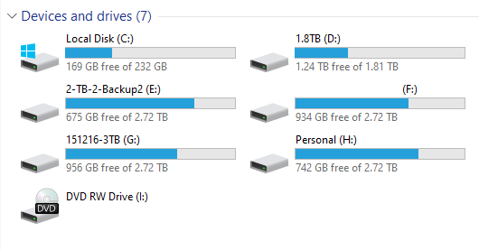

So I'm getting closer to moving over to Unraid, but in preparation I need to decide which existing drives I can use and which I should buy. Because chk dsk has occurred during start up on my 'to be' server, I do need to buy at least one new drive in the short term.
It seems I have:
12.69 TB total storage capacity
4.5 TB of free space
8.14 TB of data
The actual question bit:
So the E drive is the one misbehaving, a bit odd as some drives are 4 years old, but the one having problems is only 2 years old and has only been used in this machine. Luck of the draw I guess!
So far I'm thinking of giving Seagate IronWolf drives a shot, starting with a 4TB model for £88 / $115. Only thought of these as they've been mentioned more positively than other drives. I just wonder, if I would like 2 redundant drives (I hope/think that means I can lose 2 drives), should I think about populating with 4TB drives or 3TB drives?
Other info if helpful:
Monthly New data: Around 5-10GB worst case (images/video for work)
With the eventual new unraid machine, I intend to:
data server
video/film network share
virtual OS (1 nos.)
I've attached a screenshot, in summary:
C Drive: software, NVMe drive (256GB)
D Drive: Older drive I've re-used, only store things I can afford to lose
E Drive: Motorcycle video's I've not used (might try Vlogging when I have a moment), as well as disk images of other computers I have. Prefer not to lose.
F Drive: My company (one man band) files, very important.
G Drive: Movies, older backups of other computers I own
H Drive: Personal files, images, hosting backups, cloud occasional backups, Audio files, very few documents.
Backup: I use BackBlaze for online backup and it's run at 2 weekly intervals as very little changes, also because I figure doing so will minimise drive wear.
Cloud: I have 1TB of cloud backup that I use for regularly accessed or needed files
Thanks!!!

Doing quick calculation it looks like your raw data exceeds 8TB used based on your screenshots, so I would recommend - if you want to get started cost-effectively;
* Getting a second SSD for the cache/VM drive.
* Getting an 8TB drive for the parity drive. Two for dual partity if you can afford it.
* Keep your remaining drives in the system as is. You have the S-ATA ports for it. It's only some controllers that can cause issues - I am using one myself Marvell/Intel but haven't had any issues - although your mileage may vary.
* Replace any drive as soon as it fails/starts to cause issues or you run out of capacity with another 8TB Drive.
* Replace any other drive as soon as it fails/starts to cause issues with yet another 8TB drive.
Based on your growth estimates and usage that should see you with 4x8TB drives inside some reasonable time-frame, at which point you can retire all smaller capacity drives by removing them from the array entirely, leaving you with only NAS capable high capacity drives.
It will also spread your investment over a longer period of time, allowing you to use your hardware for longer which is better for the wallet, if nothing else - and leave you with fewer spinning drives when finished, with a clear upgrade path for the future. If 12/16TB drives become more cost-benefitial down the line, you can always replace a parity drive with one, and re-add the parity as a data drive.
This is pretty much how I started my home-server journey before actually starting to spec them out from scratch.
Oh, and in answer to your question; both main server and backup box is running UNRaid - using Resilio sync to keep a working copy. Cost per TB for the low-cost server is much lower. And for my amount of data (near 30TB) more cost effective than online backup solutions. Using Resilio it can also do backup via internet so the backup box can be physically located anywhere without issue, just have to get them to switch it on when it needs to be backed up. But in my case, a 1:1 copy with no versioning is totally fine. If you want versioning and more granular backup levels there are other docker containers for that, like duplicatii which can even handle multiple sources as backup destination. I believe backblaze might be an option, too, if not, there's always amazon and the like. With duplicatii your backups can also be encrypted before transit ensuring your privacy.

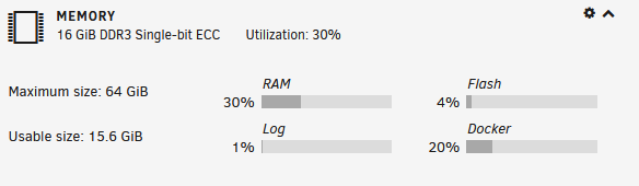

I know I should look this up, but will 16GB of RAM be OK for my storage size do you think? I can probably get another 16GB if needed, should be quite cheap as it'll be slow stuff.
Thanks again!
Dude I have 16 GB memory for 30TB of data and 9 docker containers - and I'm barely using any at all.
Do not worry about it.
Sample pic;
Edited by Froberg
unRaid is NOT ZFS, which has a recommendation of 1GB memory per 1TB of storage (never could quite understand why a filesystem doing nothing else than being a filesystem has such ignorant recommendations).  As a pure NAS, you can quite easily run 200TB+ all parity protected with only 2GB of memory.   unRaid's memory requirements are more or less based upon the applications that you're going to be running on it, in particular VMs.
