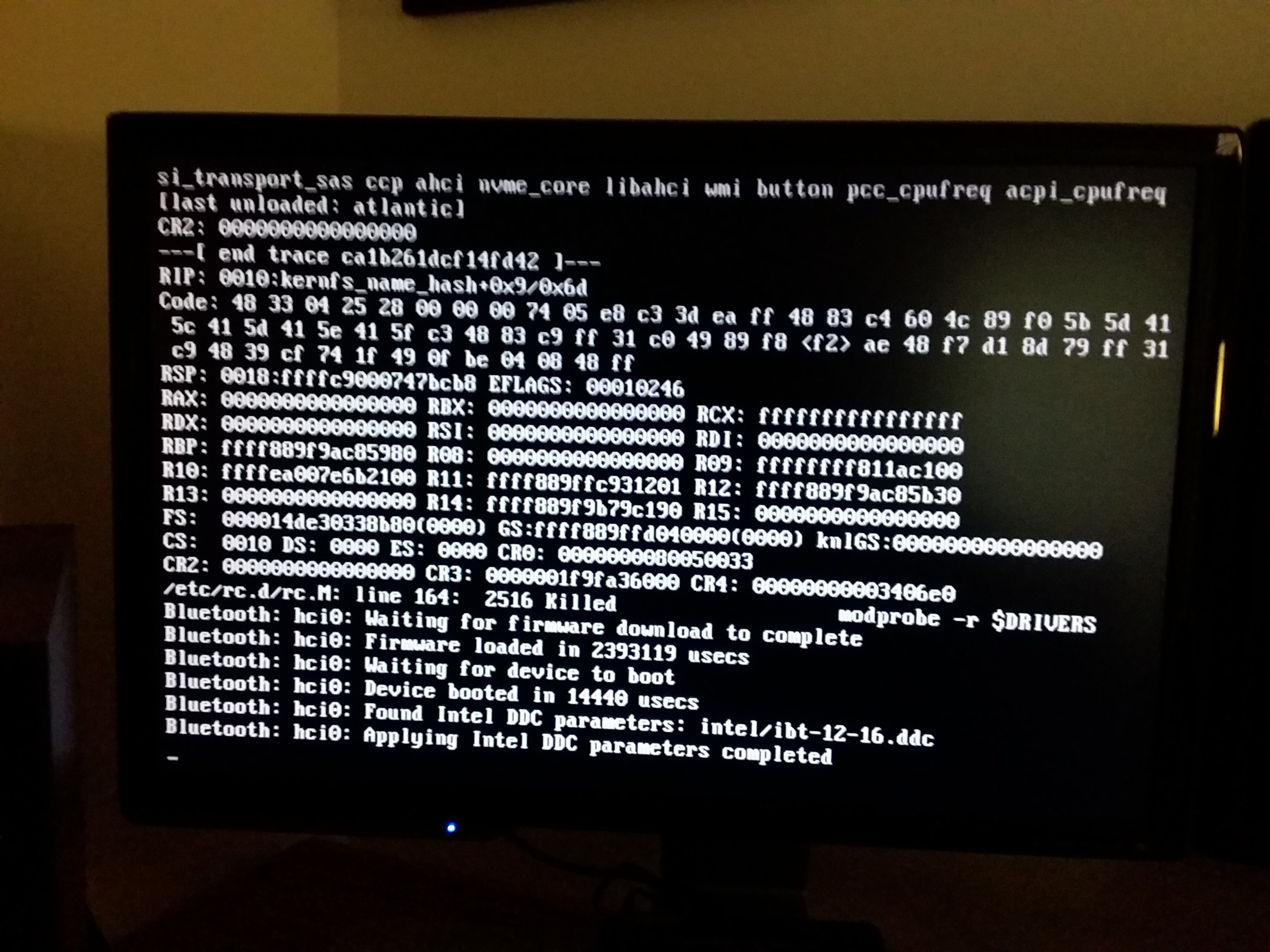

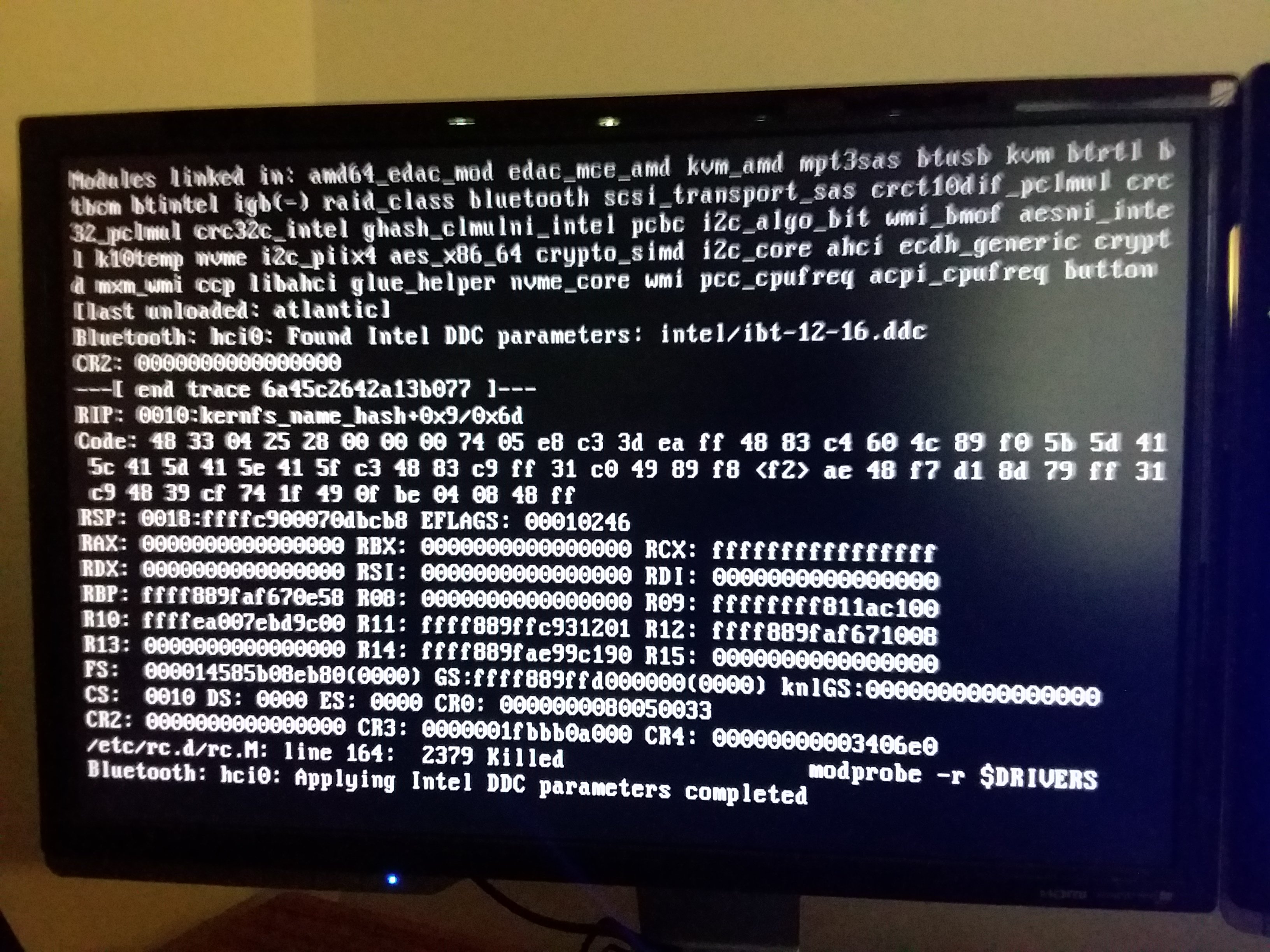

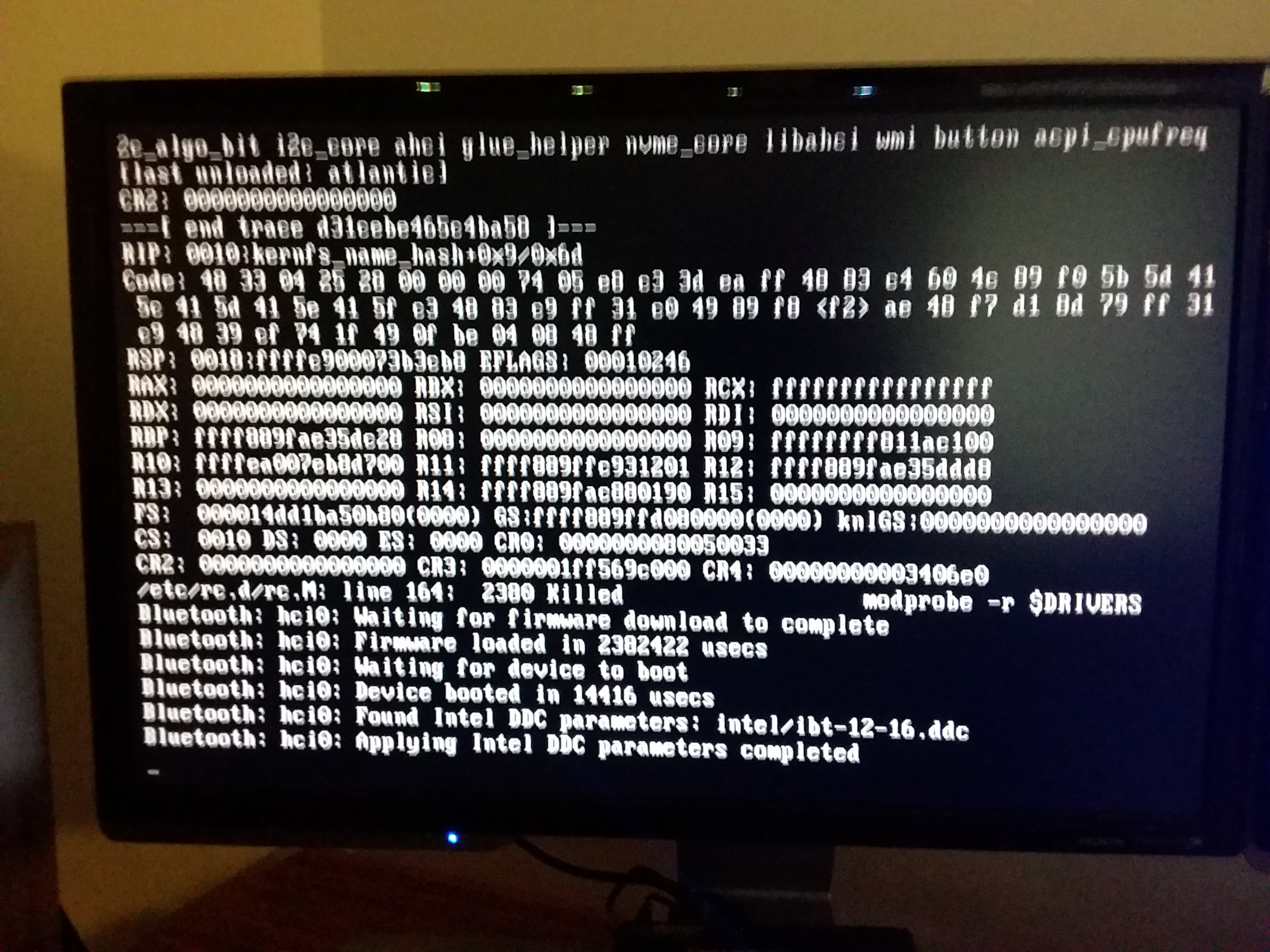

I have attached three pictures I took when the O/S was booting. I am not a programmer/software engineer so forgive my logic.
Most often the O/S stops at the modprobe line. However, occasionally it seems to progress but halts soon after. Usually at different spots. It seems to be processing something in relation to bluetooth.
I have reimaged again, copied over the same files as listed above. This time I ran the diagnostics for you. They are attached. I rebooted and the system fails at the modprobe error again. Hopefully the file dump is helpfull.

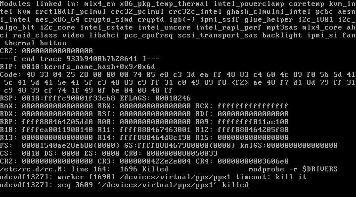

This seems to be happening to various users, in fact it just happened to me after updating one of my servers to v6.8.1:
I'll create a bug report about this.
Done:
