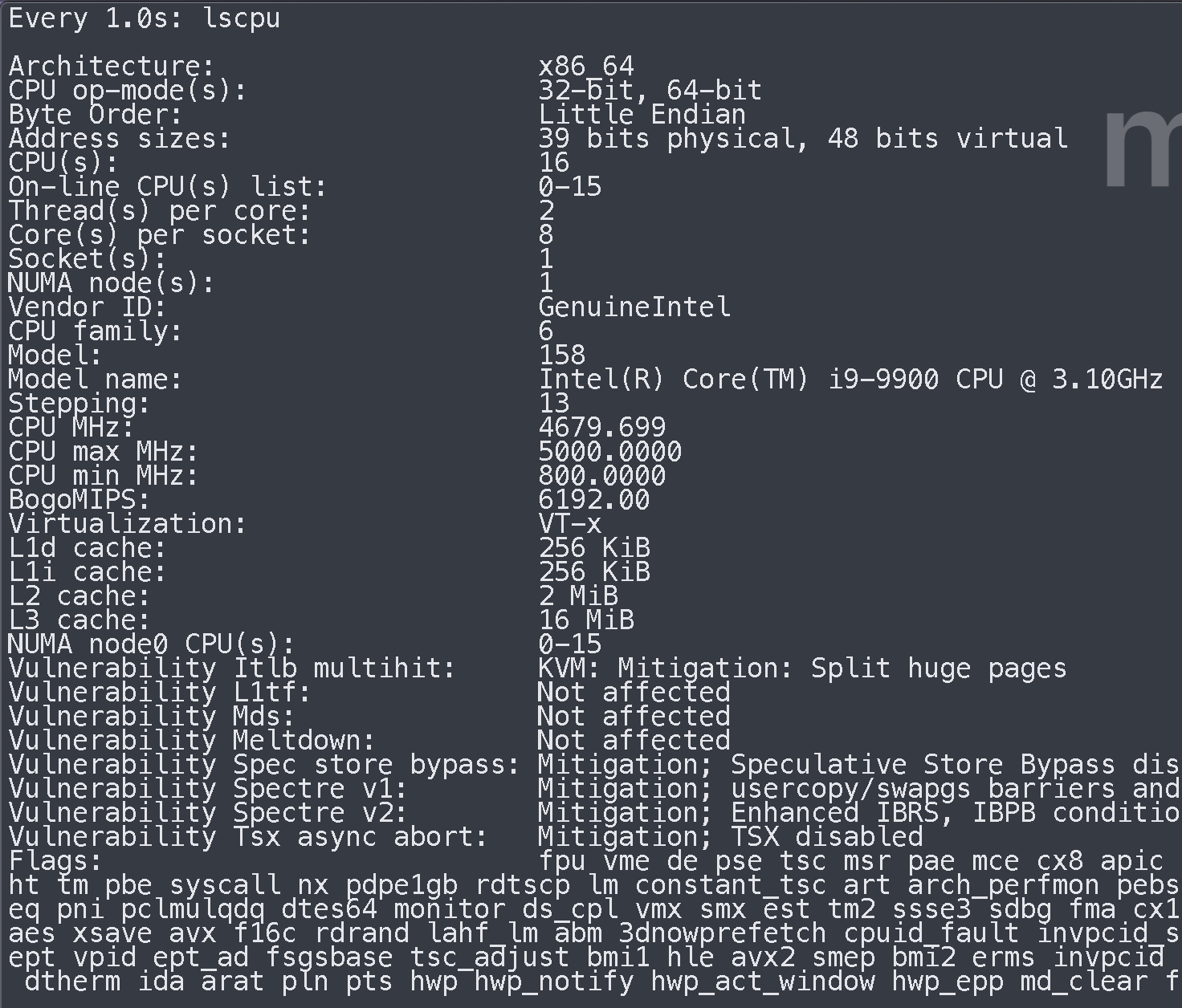

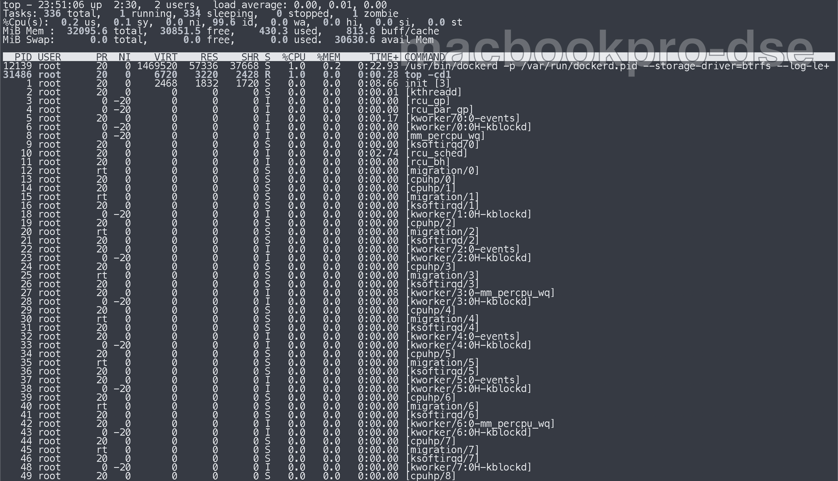

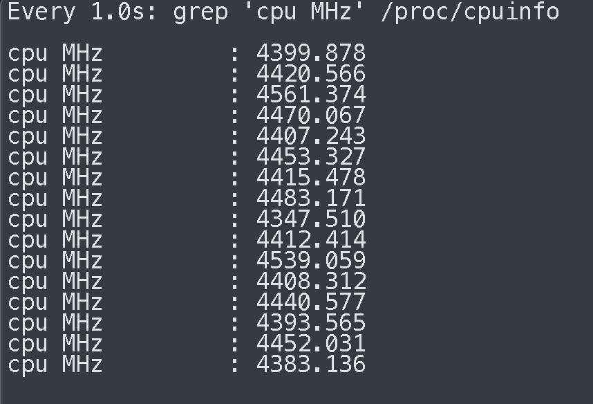

im using a Core i9-9900 (not k version) and a Gigabyte z390 UD Mainboard with unraid 6.8.1 and the cpu does not go in power save mode. In Gigabyte bios all settings for power saving are active but the cpu is not clocking itself down. Also in unraid i have tips & tweaks installed and "CPU Scaling Governor:" set to "Power Save". The cpu is always over 4GHz and only goes down to 1GHz for a second and then again immediately over 4GHz. Cpu usage at all cores are at 0 - 1%. Are there currently problems in unraid 6.8.1 or settings that I need to adjust? I don't know what else I can do. There are no more settings in Bios.

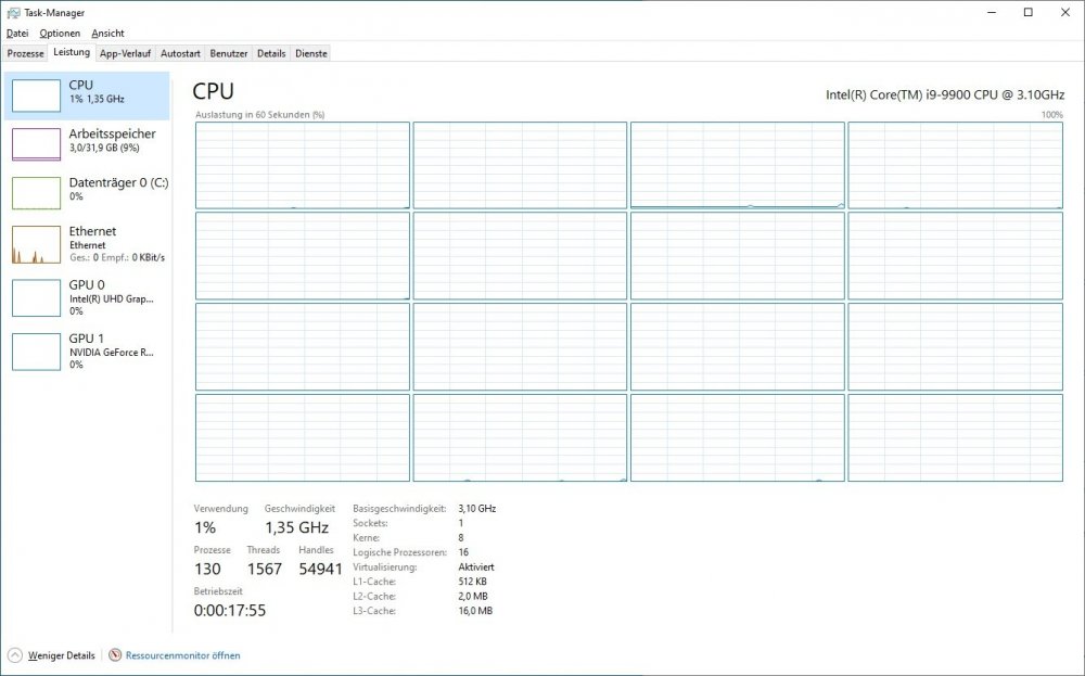

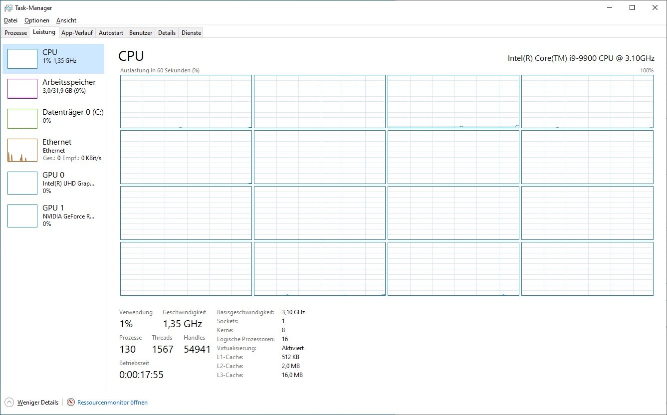

I have tested this with Windows on the same hardware and Windows does its job correctly. The CPU is not continuously above 4GHz. Windows correctly clocks the CPU down to about 1-2 GHz. This also reduces the power consumption from over 100W down at about 50W. So this must be a bug in Unraid.

If I remember correct, lowest freq will be ~3Ghz, won't as your Windows show 1.35Ghz.

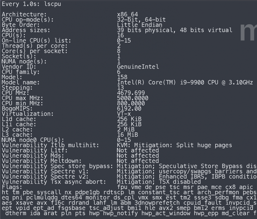

I just tested this on 6.8.1 after rebooting (tweaks CA plugin had powersave set as governor).
After reboot I logged in and ran “watch lscpu”
This allowed me to watch CPU frequency and assess it compared to expected fluctuations. The values were higher than I expected.
Via gui CA plugin I then changed to performance, saved. Noted lscpu output did not change. Set back to powersave and saved. Noted lscpu output now scales back CPU more aggressively.
This action must be performed each reboot to gain power savings.

Here the same. Everytime I check the frequency with the cmd line my i5 4690 boosts at 3.9 Ghz.
How can I monitor the cpu frequency? The grep command shows only one frequency.
“Watch lscpu”
Thanks.
No throttling down. Always on full boost.
