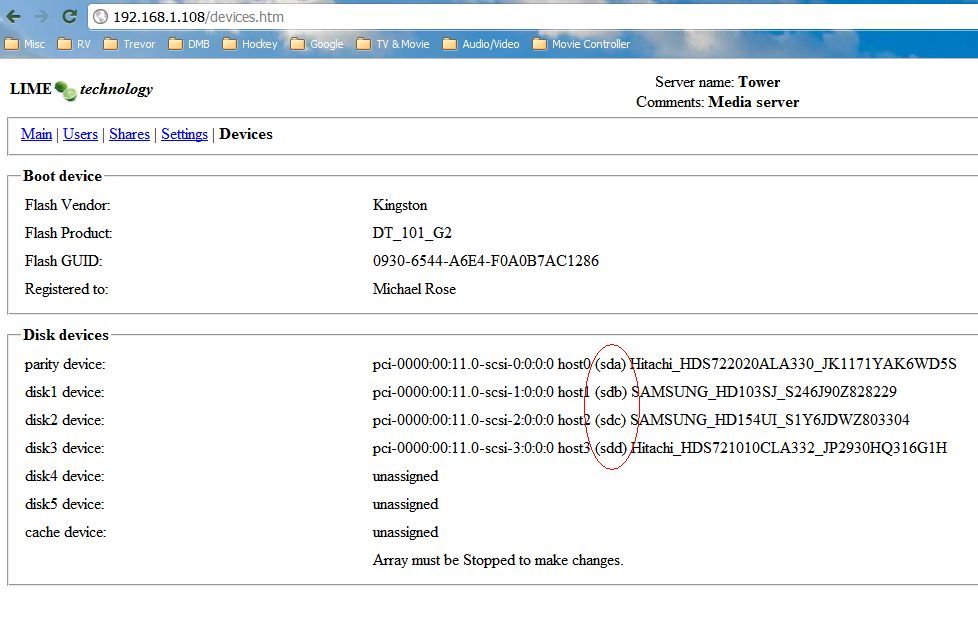

i have also posted this in the user customization board, but thought i might try here too.  did you guys preclear your disks?
I'm trying to preclear 3 wd20ears disks but so far am not having much luck following the instructions.
This is where I'm at so far;
I have put 'preclear_disk.sh' in the root of my flash drive through windows.  I put my flash drive back in my mobo and boot up my unRAID box.  After entering my username and password, I 'cd /boot'.  From there, I can bring up the help by typing 'preclear_disk.sh -?'.  I do not understand what all the '-parameters' really mean.  These disks are new so I would like to preclear and then they will become my array (first build).  Would someone be able to help me with the preclear script?  Where do I find the name of my disk I wish cleared? I know it's obvious to most of you guys but I'm really new.
To invoke this script you simply list the name of a disk you wish cleared as an argument to the command, as in this example:
cd /boot
preclear_disk.sh /dev/hdk
thanks in advance

thanks you so much, mbryanr.
