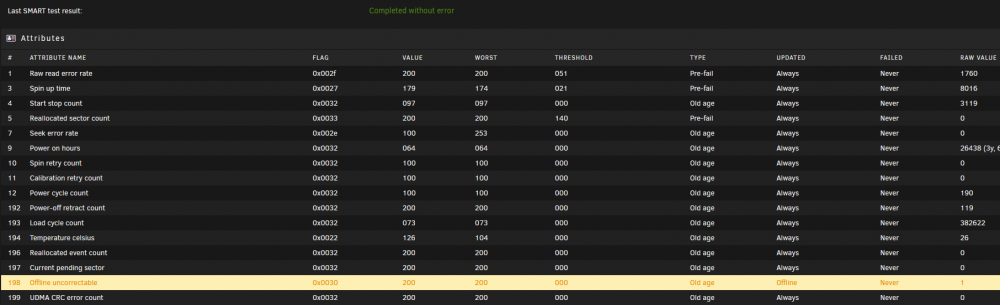

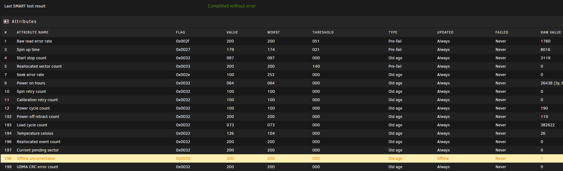

The disk is mounted and I can look through the contents with both the GUI and CLI. Here is a screen shot of the disk states. The thing that surprises me is the SMART test short and extended completed without error. Granted this is a WD Blue hard drive. I have a WD Red arriving today.
