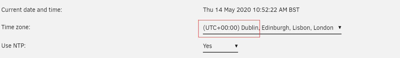

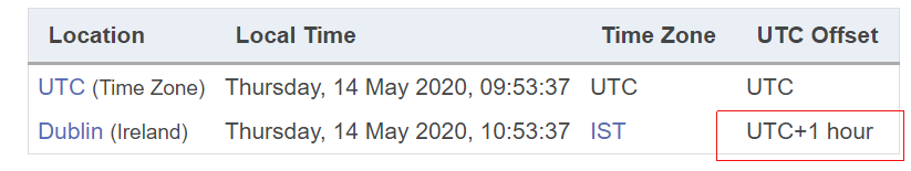

Just piggybacking onto this, I've only recently come across this little annoyance. I'm currently based in Dublin, Ireland....which is UTC+1. However, within Unraid's own time & date settings, Dublin is listed as UTC+0. Unraid seems to pull the correct time when in operation, and displays the correct time & date despite the lack of a +1 to account for the timezone. However, on shutdown, as discussed in this thread, it is setting my bios time back by one hour. It's as if the time set on shutdown DOES NOT account for the timezone I'm in.
If within Unraid I was able to set Dublin as UTC+1 (as that is the correct offset), then the shutdown time pushed to the bios should also be UTC+1, and there'd be no issue. As is stands, it seems for me that Unraid is incorrectly pushing UTC+0 to the bios, instead of UTC+1 given that timezone I've set within the settings.
