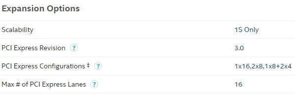

Here's a screenshot of a E-2288G for example. The same is true for 9900K - just to mention two:
44 minutes ago, hawihoney said:
Sorry, what is a myth? Must be my bad english, sorry.
You mentioned "current Intel CPU/GPU combinations seem to limit PCI lanes to 16.".
That statement reminded me of a myth that was floating around that if one uses the iGPU, it reduces the speed of other PCIe peripherals because the total speed is limited to 16 lanes. That is entirely not true.
From your subsequent reply though, I think you meant the current generation of Intel CPU with iGPU has a maximum of to 16 lanes. And yes, that is true.
If high number of PCIe lanes are critical for you then you would have no choice but to use a different platform and either forego hardware transcoing or use Nvidia NVENC.

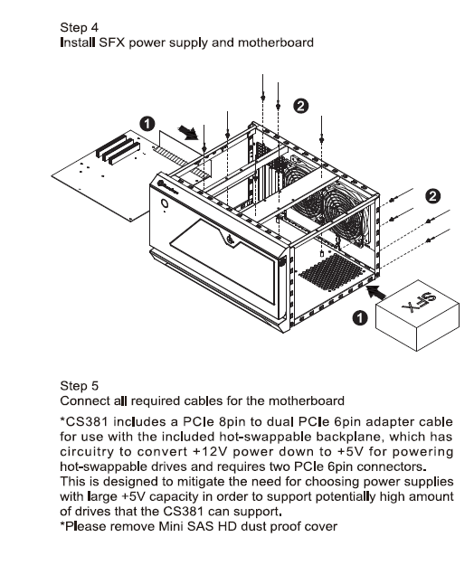

What is a molex powered backplane? I know the old molex cables, but I guess you don't mean these. I will buy the CS381 case which uses Backplanes for the Hot-swapable drive bays. In the Manual it is said that it will be powered with two 6 pin cables (one each bay) that goes over 8 pin to the power supply. In the manual it is also said that the backplane has circuitry to convert +12V power down to +5V (Screenshot attached). What ever this means ...
Is that what you mean by Molex powerd? That would be great, because then I could also just plug and play the drives 😌.

@Mor9oth to respond to some of your last couple of posts:
  • I've never worked with a backplane like that before. As long as it doesn't carry power to the 3.3v pin, you shouldn't need tape (emphasis on should because I've seen some manufacturers like Norco that somehow provide power to the 3.3v pin even with a molex connection). If not, a little bit of kapton tape on the 3.3v pin on the hard drive and you should be good to go.
  • Looking at your backplane, the cable in that link you provided should work.

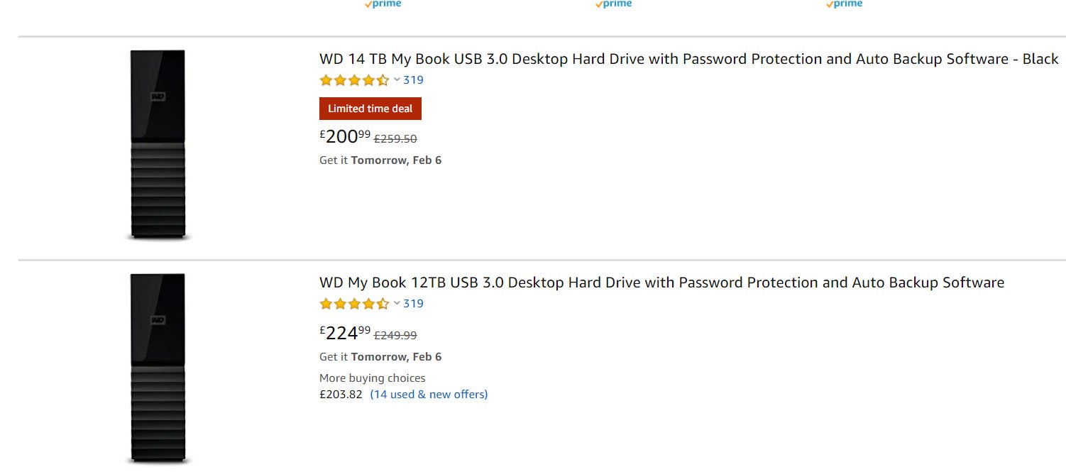

  • I'm luckily in the USA so these WD external hard drives are getting extremely cheap. I've seen those 14TB at $199.99 here but I'm probably going to wait to upgrade until I can afford 2 of them to use in a dual parity setup.
Oh lucky you for living in the USA. 😀 I wished I also could ... Just bought 4 of them because in Germany Hard Drives are way more expensive as this deal. Even exporting from the UK is way cheaper for me. Now, that I just bought that great deal I feel "terrabyte addicted" and think about buying more.
