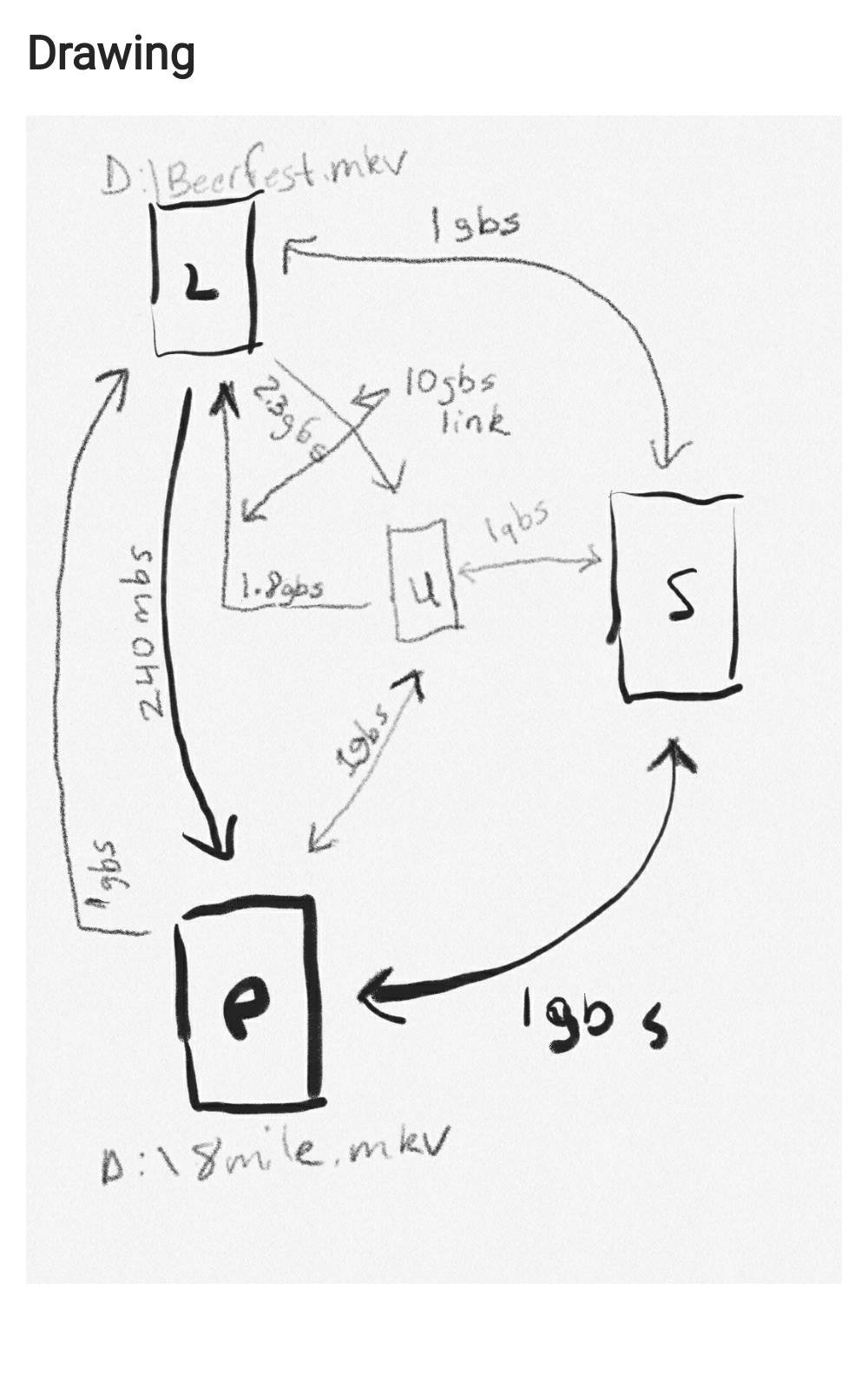

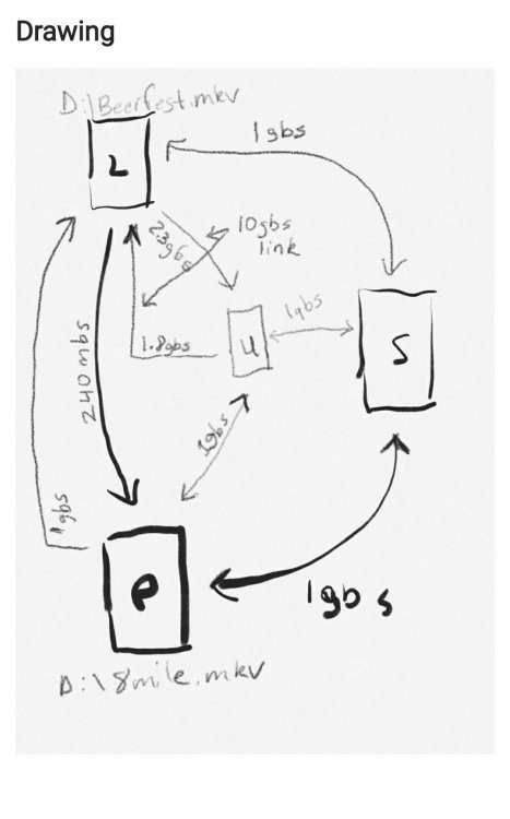

I'm still not sure what is going on I've been encountering some really odd issues...
L = Win10 Machine (10G Link)
S = Server2012
U = UnRaid (10G Link)
P = Win10 (My Machine)
I'm not sure what is going on with the speeds but the results are consistent.
I've tried disabling and AV and Firewalls.
Thoughts? Ideas?
