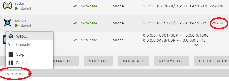

I messed around with adding some dockers and two of my docker Web GUIs stopped repsonding.  They are not accessible via their bridge IP address anymore.
I didn't make any changes to the two that failed.
Example:  Long ago I had remapped Sonarr to use port 1234.  The WebGui link now reverts to 8989 (the default)  But if I type the expected address of :1234 in manually, it still does not work.  I cannot get to the GUI in this configuration now at all in bridge mode.

You map 1234 to 1234 that won't work , you need to map from container port 8989 to host port 1234
As for the webui link that's a parameter in container xml , set the container editor to advance mode and Change it form there

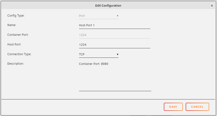

Cool!  I think I may hve found a bug in Unraid.
This is really weird.  The container port was grayed out and I could not change it.  I could only edit the host port.
I was able to fix the container port with the following steps:
Edit Docker and change network to Host mode
Set Host port back to the match the container default of 8989.
Restart docker by hitting apply. (Docker didn't work, but it changed the container port back to 8989.)
Edit Docker again and change Network to bridge
Restart docker
Edit Host port again, and it set it to the desired map port.
Restart docker
I can recreate the mismatched container port by switching back and forth between Host and Bridge while having the Host set to a port that doesn't match the container port.
That is intended behavior when a bridge network is used.
A bridge network would only change the host port for its external communication.
The container port is not supposed to be changed and should have set correctly when the application was created.
