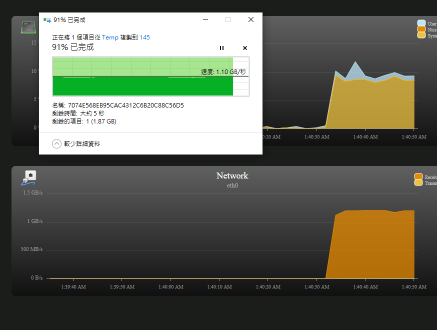

March 20, 20206 yr SMB transfer 1.1GB/s max ( a 23GB file ), so it higher then iperf result. Edited March 20, 20206 yr by Benson
