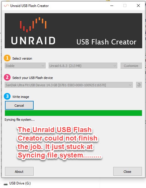

Unfortunately, I have no success in creating a USB flash drive by using the USB creator software.
It always stuck at the final bit: Syncing files system.....
However, I was able to install it using the manual method, but did not try to boot yet.

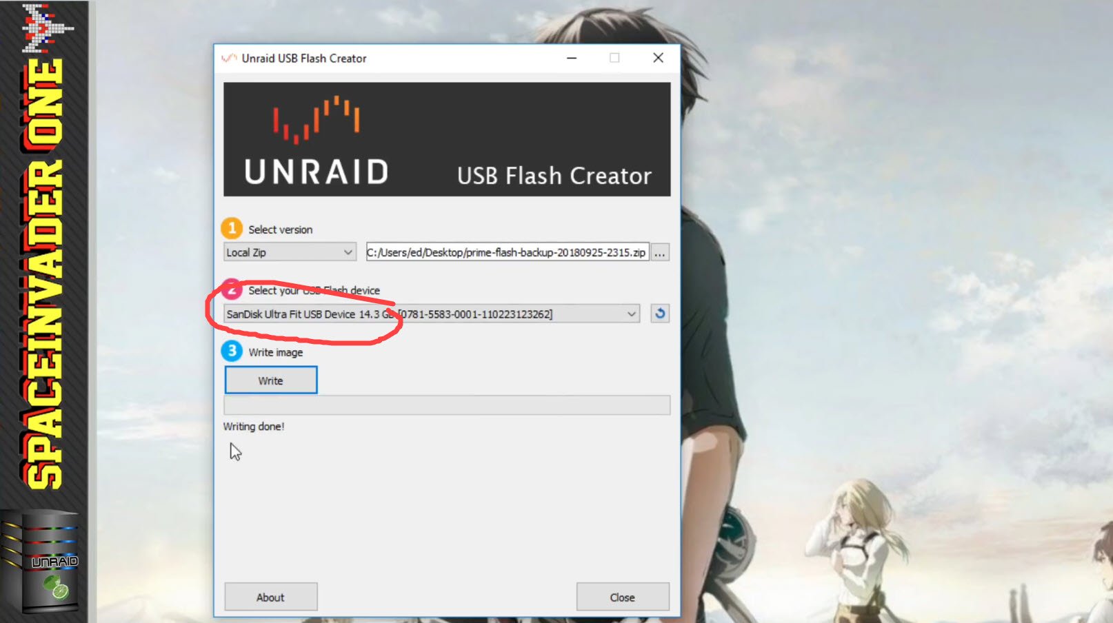

The youtuber: Spaceinvader One was also using the same USB flash drive: SanDisk Ultra Fit 16GB.
Strangely his one was good enough to finish installing. But mine doesn't.

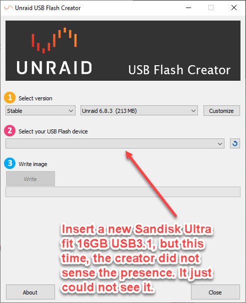

I went out and bought a new SanDisk Ultra Fit USB 3.1 flash drive.
Shockingly, the program could not detect the presence of the drive
that is already inserted into my PC USB port. While Windows 10
was able to detect it.
