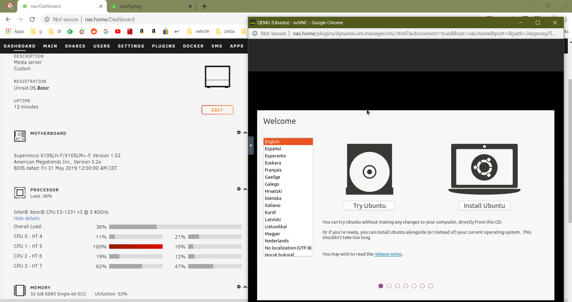

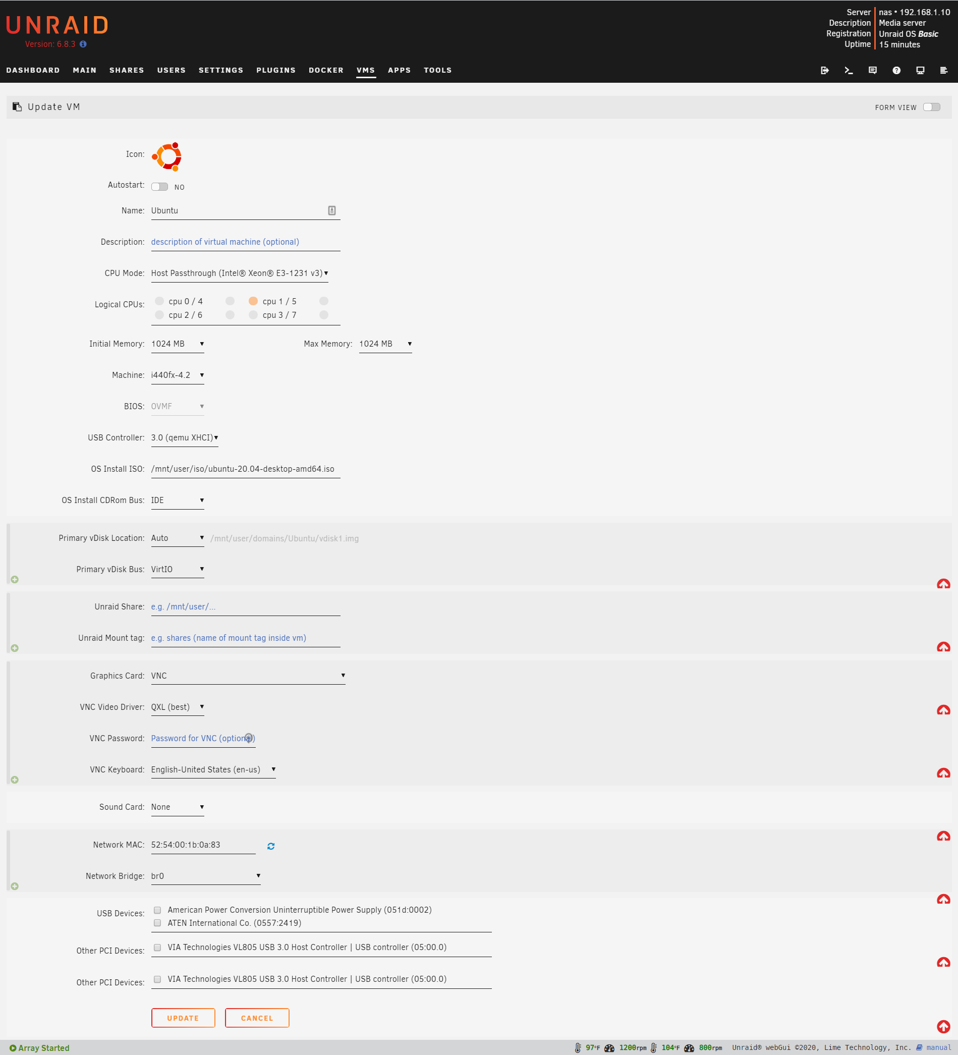

April 26, 20206 yr I'm trying to set up an Ubuntu Desktop 20.04 VM. Eventually, the VM locks up and I notice its assigned CPU in UNRAID is pegged at 100%. I've tried several times and sometimes I can get the OS installed, and sometimes it locks up during installation. Wondering if it's the same issue as this? I've attached my XML and diagnostic info. Any ideas? Quite a lot of information for Windows guests here, but I'm having trouble finding equivalent information for Ubuntu guests. I have 3 Windows VM's running perfectly. BTW, I saw @jonp's advice to set UEFI boot mode, i440fx, and setting the CPU mode to emulated. However, I can't get the CPU setting to stick in the GUI. Every time I save it but when I go back into the form view it's set to Host Passthrough. ubuntu.xml nas-diagnostics-20200425-2003.zip Edited April 26, 20206 yr by nukeman

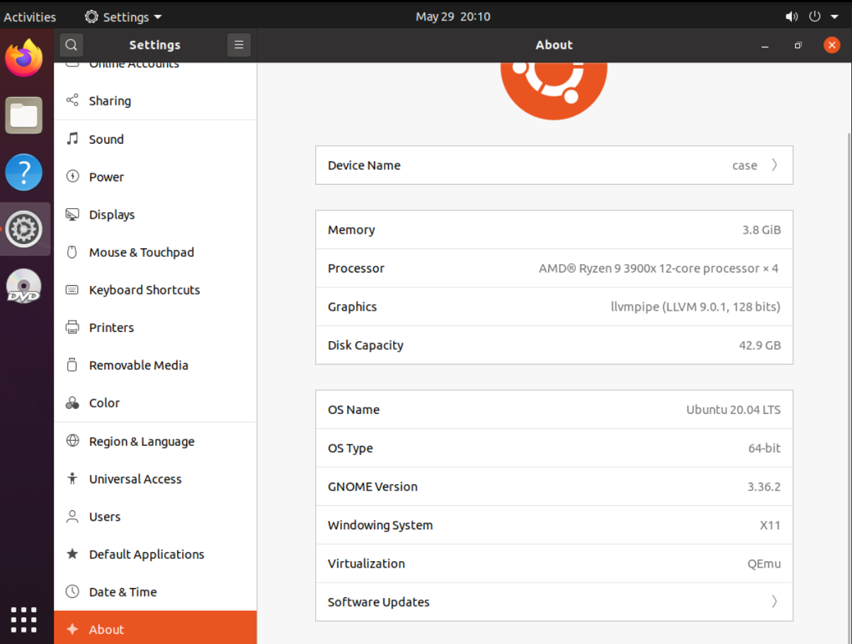

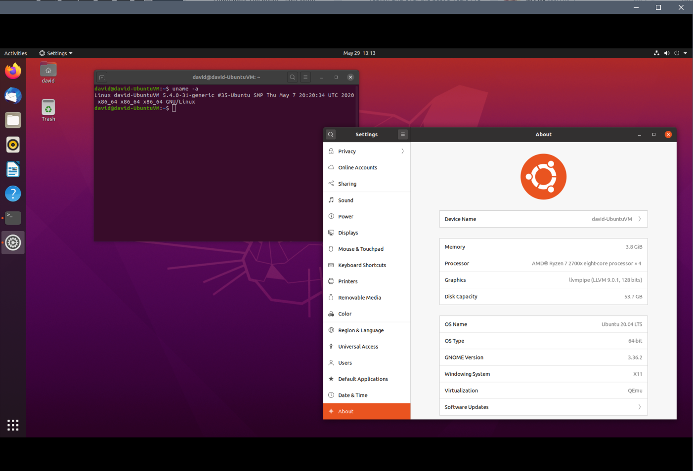

May 29, 20206 yr I have a ubuntu 20.04 VM and it works without issue the only difference is i use Q35 4.2 for the machine type. Q35 is normally the machine type for all linux VMs.
