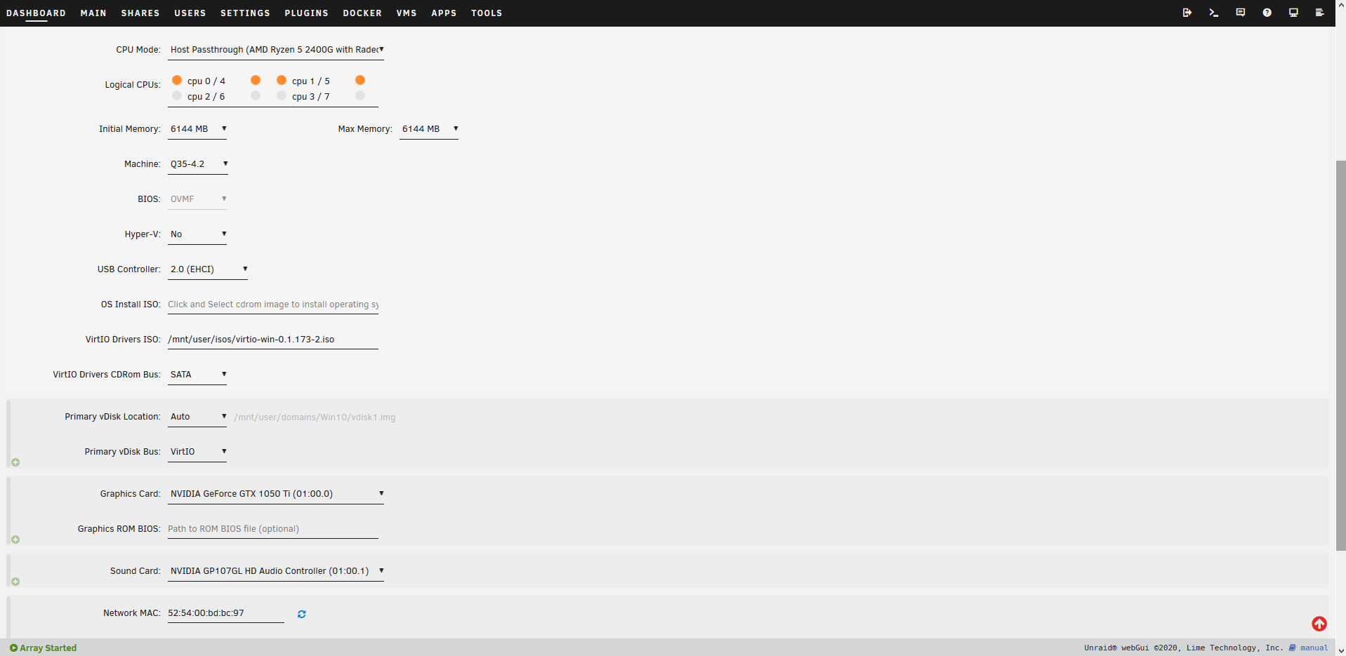

Hey guys,
I need your help. I have two GPUs, primarily from the CPU (ryzen 5 2400g), secondarily the asus strix gtx 1050 ti.
First I installed Windows 10 with VNC and set everything including the driver.
Then I shut down the VM and selected my graphics card for graphics and sound.
Once without "multifunction = 'on'" and once without. Then the PC does not start. Nothing happens. When I switch back to VNC it works.
I dont know...
here is my xml file

You have to put your rom file for passthrough gpu.
Envoyé de mon HD1913 en utilisant Tapatalk
thank you for your video, i put my rom file to the vm.
vm starts and i can connect with rdp, i installed the nvidia driver and it run but
if i connect with an vnc i get a black screen
if i connect with a display over dvi-d, i get a black screen
new xml file

i found this
Single (NVIDIA) GPU Passthrough:
For single GPU passthrough, you need to disable graphical output in Unraid. From the Main menu, click the name of your Boot Device (flash). Under Syslinux Config -> Unraid OS, add "video=efifb:off" after "append initrd=/bzroot". The line should now read "append initrd=/bzroot video=efifb:off".
When you reboot you will notice there is no video output when unraid boots (you will be left with a freeze frame of the boot menu). Your solo GPU is now ready to pass.
For Nvidia you will need the vbios for your card. I dumped my own following this tutorial using second gpu. If you can't dump your own, trying following this tutorial to download/modify a working vbios.
Now simply pass your GPU, vbios, and the Sound Card that goes with your GPU from the vm xml gui.
