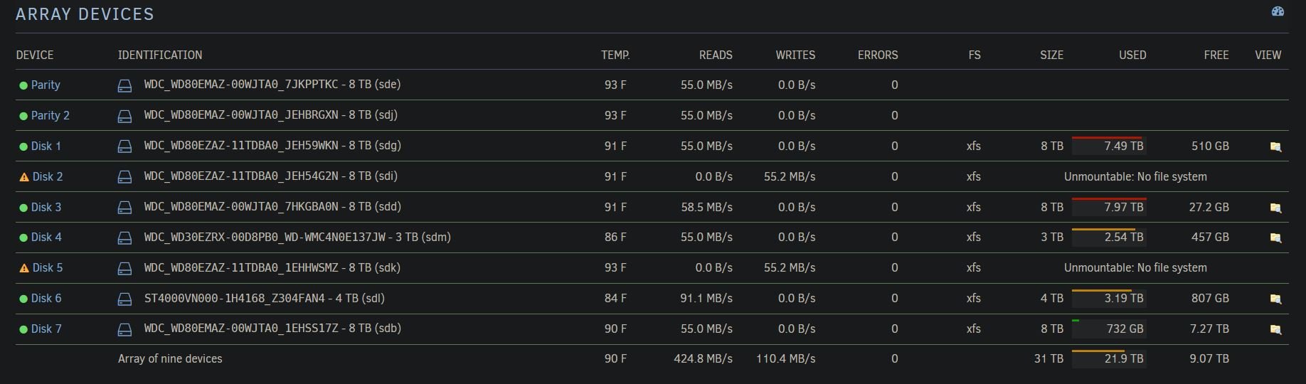

Two drives with Unmountable: No file system and parity is running.
Something caused my server to restart this morning and I woke up to find two drives with the Unmountable: No file system statuses. Here is where I messed up big time. I stopped the array to restart in maintenance mode to run a smart check of the drives and go from there but accidentally started in regular mode which initiated a parity rebuild...
I have a found a few threads with this same issue and they all point towards the filesystem needing to be repaired. Assuming I already have not jacked everything up, will letting the parity rebuild finish overwite data on those drives or corrupt the parity data? Should I stop it? It also seems to have an unusually long estimated time at approximately 6 days vs. the normal 1 day. I attached logs and a screenshot.
Both drives are on the same power / sata hotswap bay so I think the original issue may be related to that because it seems weird for two drives to fail at the same time without something common between them.

11 minutes ago, Civrock said:
Should I stop it?
The damage (if any) is already done, you'll need to run xfs_repair once it finishes, you can also cancel and run xfs_repair now then start rebuilding again from the start, this way you know if it's worth rebuilding and can also access the data during it.
There's something else using the array, in the screenshot you can see extra reads on disk6, and on the diags there extra reads on disk3.
19 minutes ago, Civrock said:
Should I stop it?
Yes, I will unassign all other disk ( data and parity ), then retain those two disks. If repair filesystem not success, than resume all assignment and rebuild.
Extra reading on disk6, as you see the read was 91.1 MB/s .
Edited by Benson
Thanks for your time guys, I will just go ahead and stop it now and attempt to repair the filesystems. Will update if I have more issues or make it through that.
Edited by Civrock
Okay, so I ran xfs_repiar -v on both disks and they both had issues with the primary crc, said that there were pending changes to the log and I should mount first before re-running the repair tool. When I mounted them, both showed up normally and rebuild started.
The wording of the repair report made it seem like (at least to me as a layperson in this area) I needed to mount and then immediately run the repair again. Since both disks showed up normally, should I just let the rebuild run, or do I need to stop and run the repair again? I feel like the right answer here is to let the rebuild run now, but I just want to be sure.
Thanks again for your time.
If they are mounting correctly they should be fine but it's also OK to run xfs_repair again to make sure.
