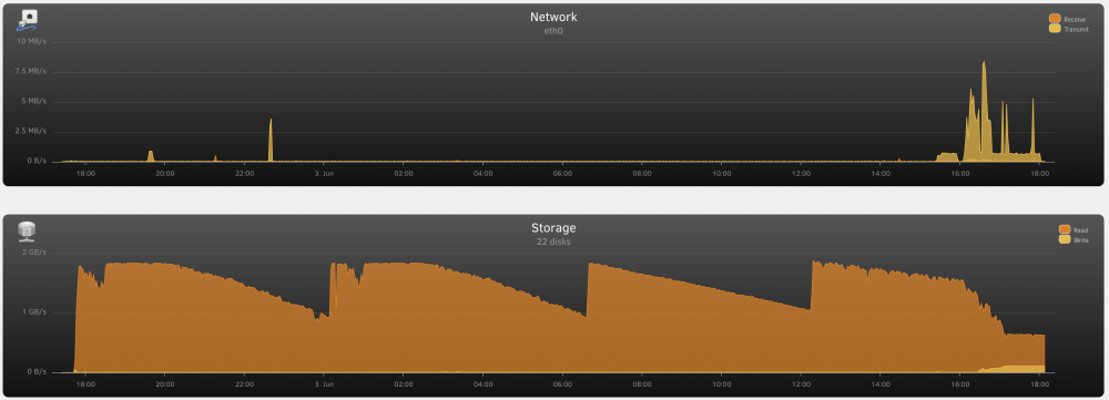

A good catch, but this can't identify problem come from SATA controller or relate X570 platform. When I use SAS+Expander I haven't use AHCI anymore and no trouble for changing different platform. As you have so many disks and have SAS controller, you should invest on SAS+Expander solution. From below graph, some bottleneck also found ( flat ceiling at section 1 and 2 during access all disks )
I also note you have 64GB memory in 2666 speed setting, when I live with X370 with 64GB memory, the speed only stable at 2400 but for safety I run at 1866, pls check that too.
You have install "Enhanced log" plugin, do you proactively monitor those critical error message ?
Edited by Benson
