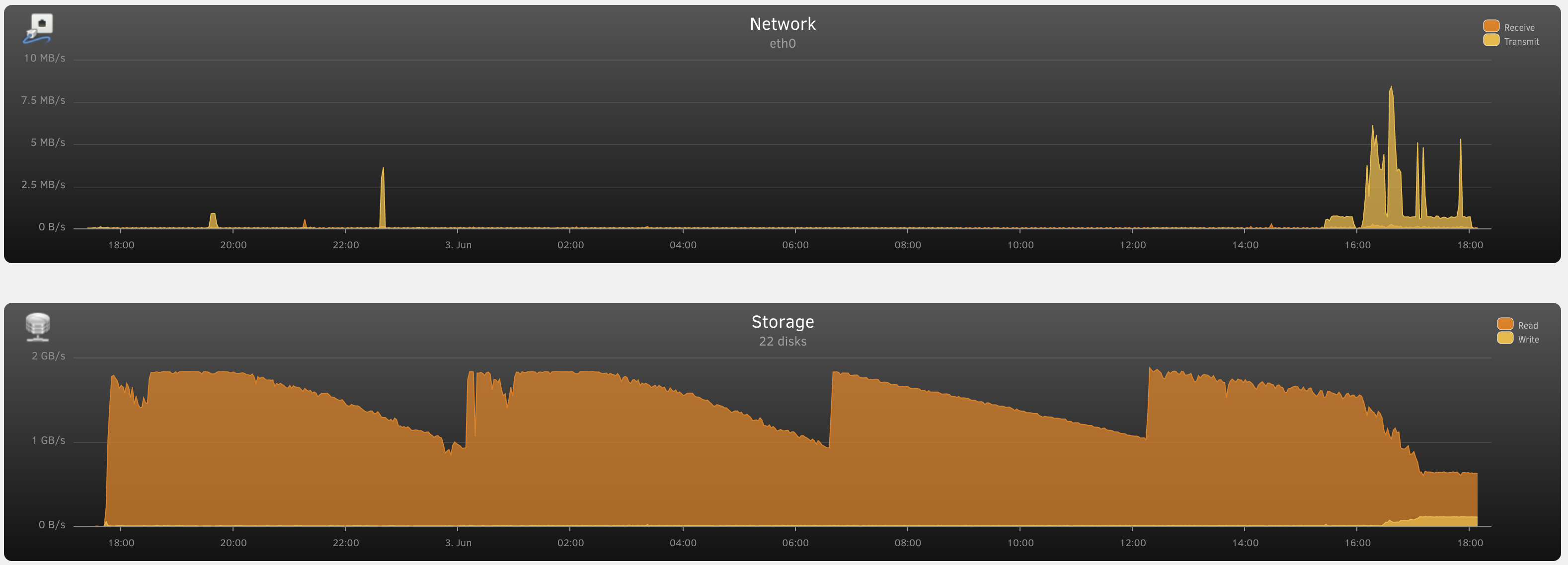

Quick update - More weirdness occurring. During my parity check Parity #1 has basically non-stop sync errors after the 2TB mark, almost as if the parity alignment was thrown off after my 2 TB disks.
I was watching my disk usage as parity check crossed over the 2TB mark and I noticed slow reads on only one of my 2TB drives for a few minutes after the other 2TB drives stopped reading. Even weirder is that Parity #2 has hardly any writes, implying there are far fewer sync issues with Parity #2.
There is nothing in the syslog indicating any errors.
Any ideas what could cause this?
Shouldn't my Parity Sync of Parity #2 also corrected Parity #1? (as outlined here:)
I just cant think of a reason why Parity #2 would appear good, but Parity #1 would not. If there were any parity issues I would have expected both parity drives to need updating.
Update: 107,625,991 sync errors and counting. I have no idea how Parity #1 could get THAT out of whack. After some quick math, it seems as if about every sector after the 2TB mark is triggering a sync correction. I understand Parity #2 could do that if I rearranged disks, but I am at a loss of understanding what could possibly cause that aside from some sort of a software "hiccup" that throws off the "P" calculation but not the "Q". @johnnie.black - I certainly welcome your opinions on this one. My google-fu may be weak, but I scoured the forums and could not find anything similar to this behavior.
For now I guess I'll let this run its course and run another Parity check after this completes.
Just for fun, you can see at around 18:00 when the 2TB mark was passed, then minutes after, massive slowdown to about 65mb/s as corrections to Parity #1 are written. It was during that spike that I saw reads to one of my 2TB which I don't think should have been occurring since parity check should have been past that point.
Edited by johnsanc

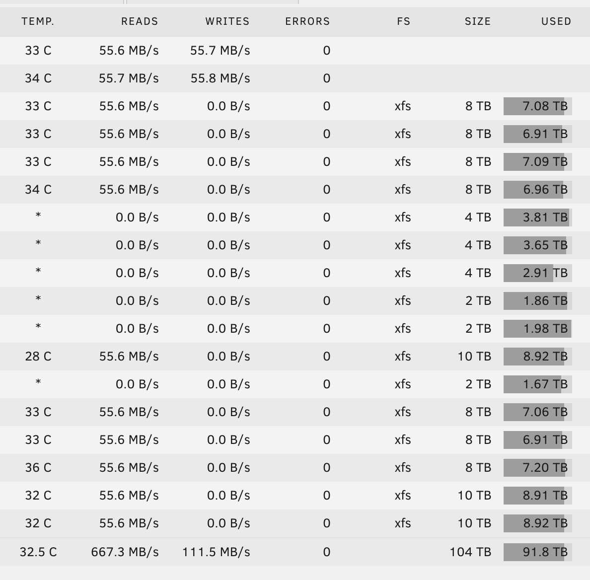

35 minutes ago, johnsanc said:
As of about 5:30 AM on the nose I am now getting writes to Parity #2 for what looks like every sector. This is exactly when my SSD Trim schedule is set to run... is there anyway that can be related?
Can't see how, but if there are writes to parity2 there should be the same ones to parity, though you can't look at the the number of writes stats to compare, since they can vary wildly from device to device, even when doing the same activity, when can look at the speeds stats, those are reliable.
Speed stats are dead even to both Parity drives.
I'm hoping this check gets things back in order. I'm just racking my brain as to how the parity could be so incorrect considering I haven't written anything to the array aside from a few hashes from File Integrity plugin and an XFS repair. It feels like my parity should have been mostly correct before and now this correcting check is actually breaking the parity. The only other explanations I can think of are:

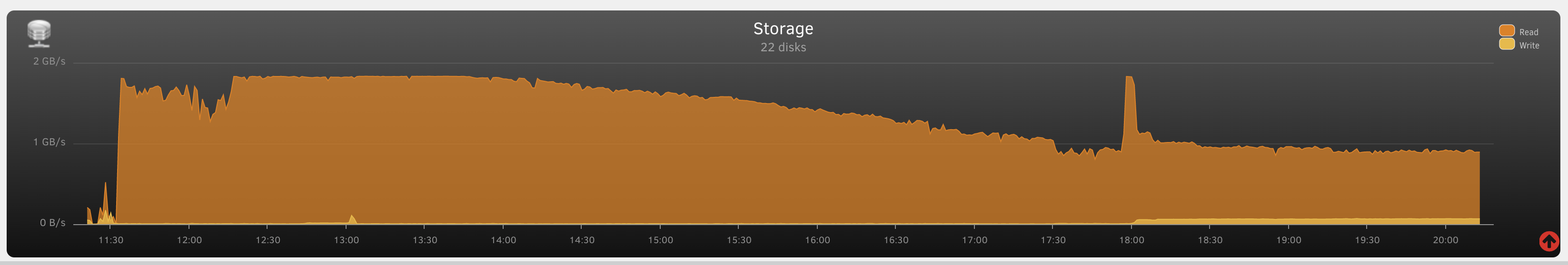

OK another update. My non-correcting parity check went over the 2TB mark with only a few sync errors. I stopped this check and restarted with a correcting parity check. Now again deep into the check after about 5TB or so I see every sector triggering a parity correction. Again there are ZERO issues in the syslog.
Does anyone have an explanation for this? Its concerning that I keep getting these sync corrections but there is no info in the syslog that would suggest any issues what-so-ever.
I did notice that the parity corrections seem to coincide with network activity, which happened to be a download from my Nextcloud.
Considering there are no errors in the syslog it almost seems like the parity check/sync is very fragile and can be easily thrown off. Either that or there is something weird going on with my SATA controller and its returning incorrect data that is going unreported in the syslog.
This one is a mystery and any theories around what is happening are appreciated.
