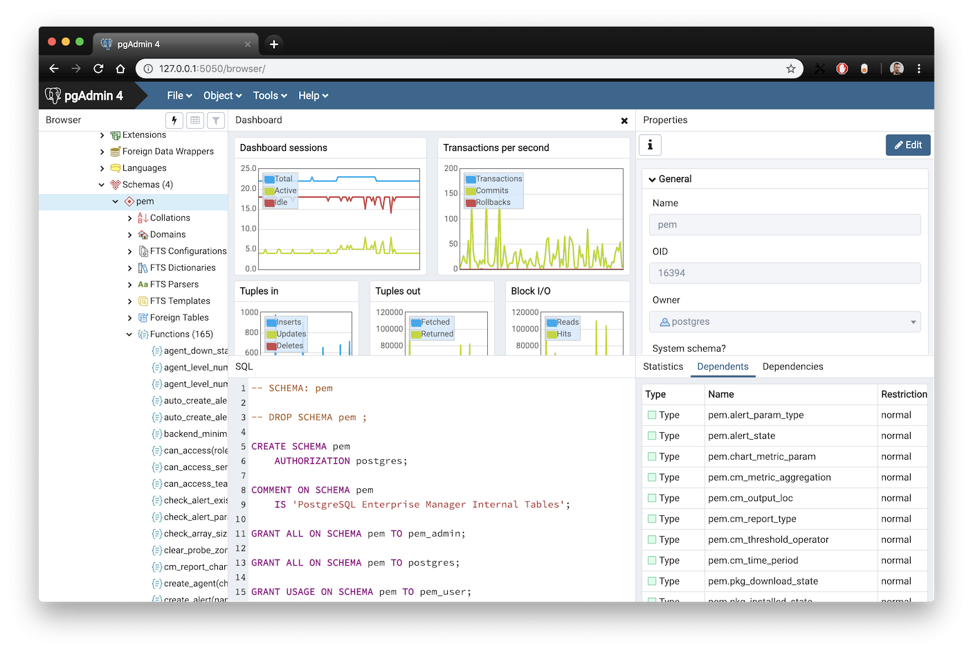

Overview
pgAdmin is the most popular and feature rich Open Source administration and development platform for PostgreSQL, the most advanced Open Source database in the world. Some features:
  • Designed for PostgreSQL 9.5 and above
  • Access and manage multiple databases
  • CRUD for all the things and raw SQL execution
  • Wizards and graphic tools for many administrative tasks (ACL, backup/restore, etc.)
  • Monitoring dashboard
