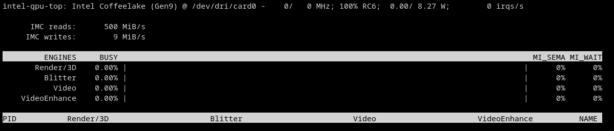

  1. Hello and thank you for this plugin. I am setting up on fresh Unraid install 7.2.3 and cant get my Intel iGPU to show stats. I have an Nvidia Quadro P400 card also which appears to be showing everything correctly. Any suggestions on what to try to get iGPU working is appreciated! root@OMNIUS:~# timeout -k .500 .400 intel_gpu_top -J -s 250 [ { "period": { "duration": 3.031570, "unit": "ms" }, "frequency": { "requested": 0.000000, "actual": 0.000000, "unit": "MHz" }, "interrupts": { "count": 0.000000, "unit": "irq/s" }, "rc6": { "value": 99.997790, "unit": "%" }, "power": { "GPU": 0.000000, "Package": 26.777135, "unit": "W" }, "imc-bandwidth": { "reads": 1791.108437, "writes": 346.029031, "unit": "MiB/s" }, "engines": { "Render/3D": { "busy": 0.000000, "sema": 0.000000, "wait": 0.000000, "unit": "%" }, "Blitter": { "busy": 0.000000, "sema": 0.000000, "wait": 0.000000, "unit": "%" }, "Video": { "busy": 0.000000, "sema": 0.000000, "wait": 0.000000, "unit": "%" }, "VideoEnhance": { "busy": 0.000000, "sema": 0.000000, "wait": 0.000000, "unit": "%" } }, "clients": { } } { "period": { "duration": 252.752354, "unit": "ms" }, "frequency": { "requested": 0.000000, "actual": 0.000000, "unit": "MHz" }, "interrupts": { "count": 3.956442, "unit": "irq/s" }, "rc6": { "value": 99.999997, "unit": "%" }, "power": { "GPU": 0.000000, "Package": 8.127803, "unit": "W" }, "imc-bandwidth": { "reads": 496.998551, "writes": 4.883009, "unit": "MiB/s" }, "engines": { "Render/3D": { "busy": 0.000000, "sema": 0.000000, "wait": 0.000000, "unit": "%" }, "Blitter": { "busy": 0.000000, "sema": 0.000000, "wait": 0.000000, "unit": "%" }, "Video": { "busy": 0.000000, "sema": 0.000000, "wait": 0.000000, "unit": "%" }, "VideoEnhance": { "busy": 0.000000, "sema": 0.000000, "wait": 0.000000, "unit": "%" } }, "clients": { }

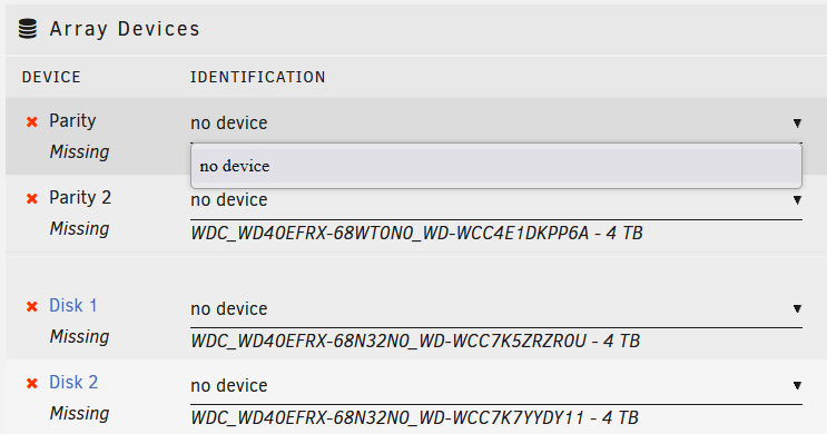

  10. All disks connected through Supermicro backplane to HBA connected to motherboard. I can see operating lights on HBA and it is getting power, maybe something happened to it? I think I have another HBA I can swap out to see if that is the problem. Thank you for the quick response to my post.
  11. Shows no device for all of my drives. Diagnostics attached. Any help is appreciated thank you. omnius-diagnostics-20230526-1028.zip

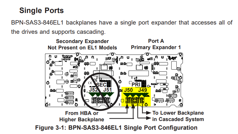

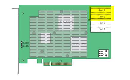

  14. Ok thank you for the explanation! I have a BPN-SAS3-846EL1 backplane using both the J49 and J50 connections to a single LSI 9300-16i HBA. I unplugged ports 2 & 3 on the HBA. So just for me to be 100% clear, there is no redundancy benefit for me to plug these back in because this is not supported in Unraid?
  15. Yes I have dual channel transmission cables from my backplane to HBA. I shutdown, unplugged one of the cables, rebooted and now magically the VM cache pool is valid again! So it seems it was something with the dual channel that was causing the issue maybe? Is it ok to plug in the second cable again? New diags are attached. omnius-diagnostics-20230106-0926.zip
