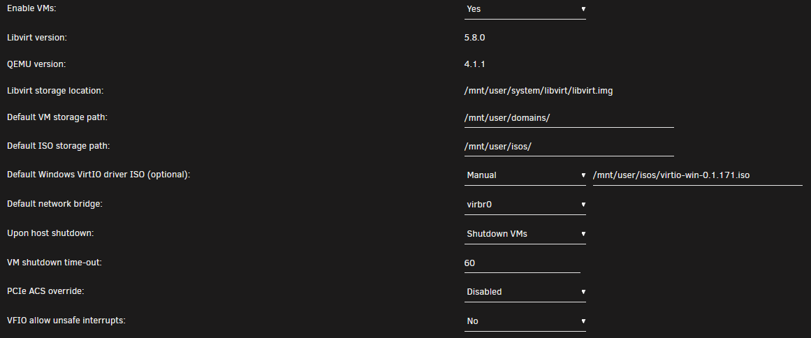

Some time ago, i added a bond0 (with eth0&eth1), and some time after (maybe 2/3 weeks and unrelated), it seems like i cannot choose any other option than virbr0 on VM's network :/
Here is the VM Manager screen :
(here, the only choice given is virbr0, there's no other in the dropdown)

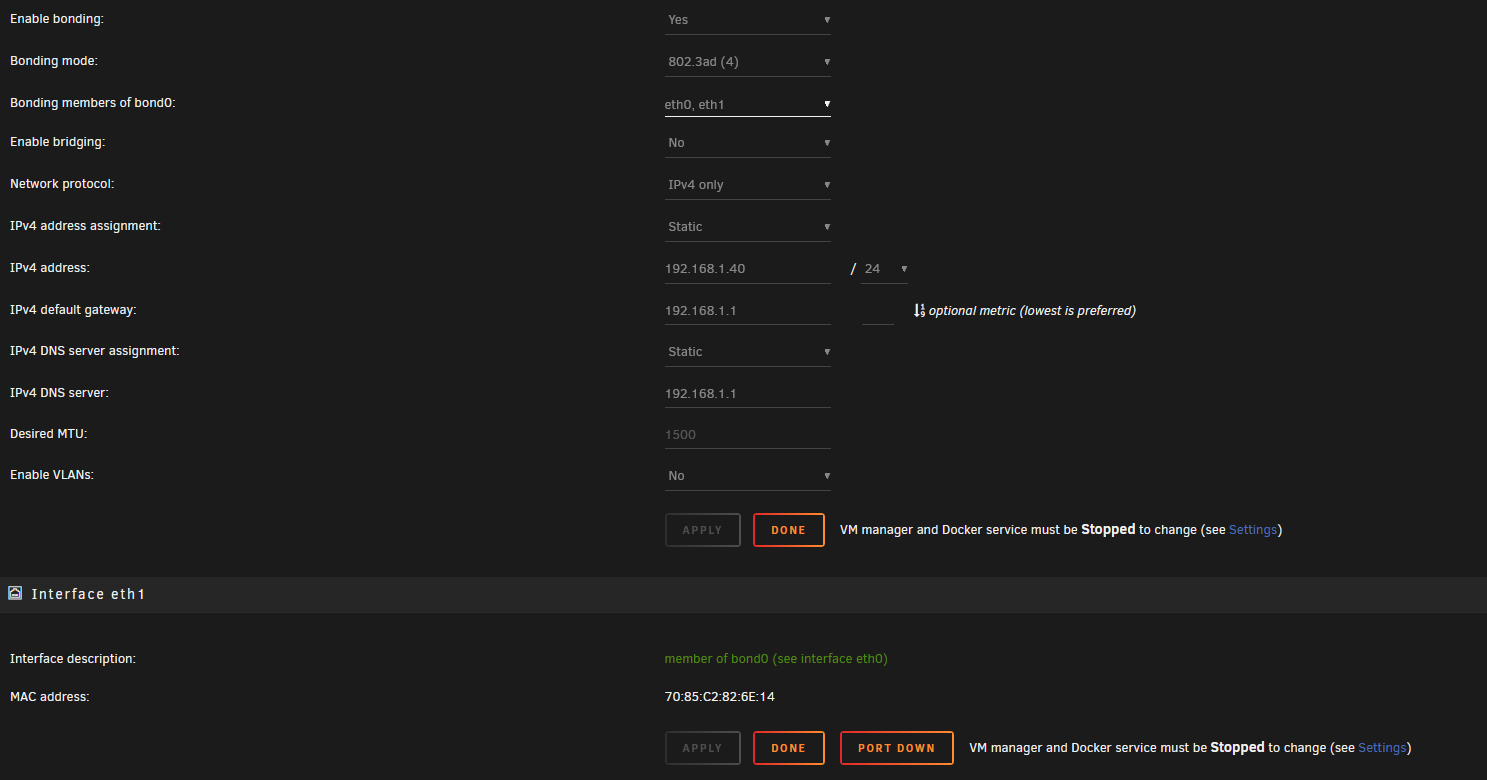

The Network Settings :

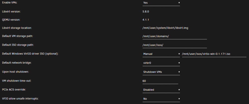

(same things here, in graphical view, there's no other option than virbr0 in the dropdown).

Besides enabling bonding, you need to enable bridging too.
This will make the bonded interface available to VMs as 'br0'.
That was it ! 👍
Thank you very much, i'm so happy right now ^^
