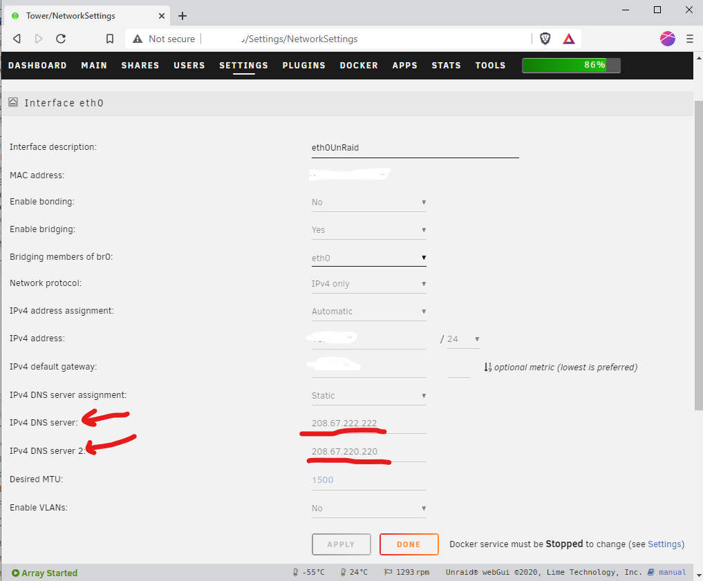

i only have 1 slot for DNS server in unraid, so i am not sure where i am typing DNS2 and i can not add in my router the DNS since i use a provider router
Edited by Danuel
Here's a snapshot of my unRaid network settings. Is your's different?:
this is what i have
Edited by Danuel

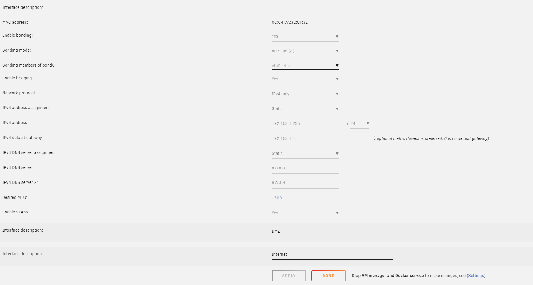

Hi @Danuel,
Have you tired changing the bonding option, you only seem to have a single NIC eth0 but you have bonding enabled.
I am in the UK also, but on EE.
Apart from using a portchannel, these are my settings note I see both eth0 and eth1. Try changing yours to Enable Bond to no as only 1 NIC is showing eth0.
@SimonF
bonding was enabled because of the spaceinvader tutorials, i only have 1 LAN port, i have disabled that option and still containers are not getting updates
Edited by Danuel

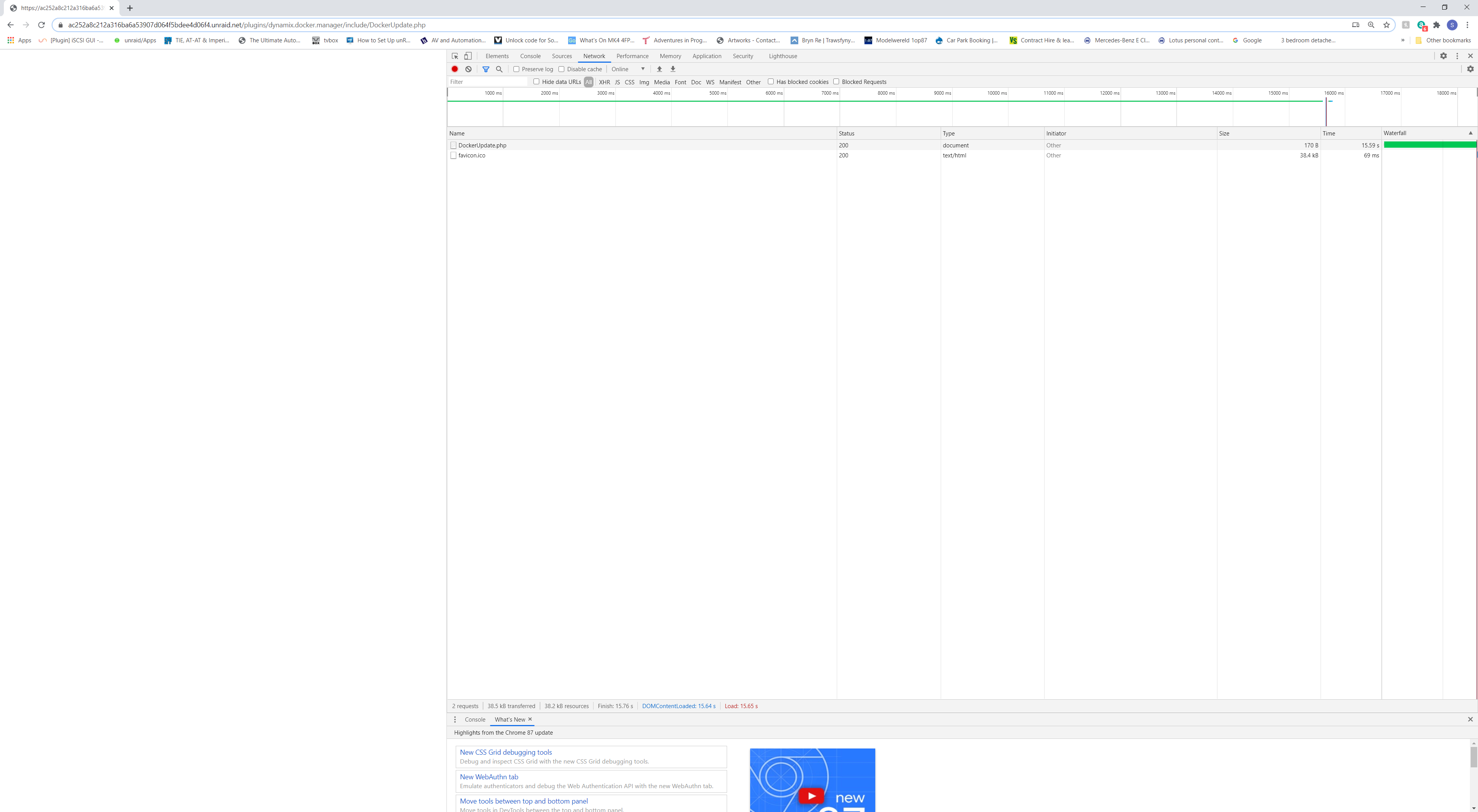

Are you using Chrome? if so press F12 to get debug and run the following
http://192.168.1.66/plugins/dynamix.docker.manager/include/DockerUpdate.php
You should see something like this. It might show some errors in console that may provide the devs with more info.
@SimonF
well on those error what i see in browser is Failed to load resource: the server responded with a status of 504 (Gateway Time-out)
but this does not explain why does not make the auto updates even if i don't use any browser, i dont have another router to try so i am not sure if the problem is the router or not since i dont have any other problems with other devices or accessing the internet
