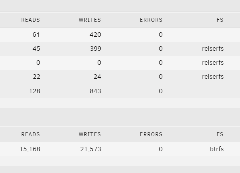

I set this up and everything is working but the drives are still spinning.
I reset the drive stats but there are still some reads and writes to disks 1 & 3 which is stopping them spinning down.
There is nothing connected to the array but these docker containers are running.  Any ideas how I can track down what is actually accessing the disks?

I got nothing at all 😕
This did however solve it.   appdata is excluded from the plugin due to the amount of logging, turns out I forgot to copy part of my appdata share over to the cache drive.   Running the mover job now.

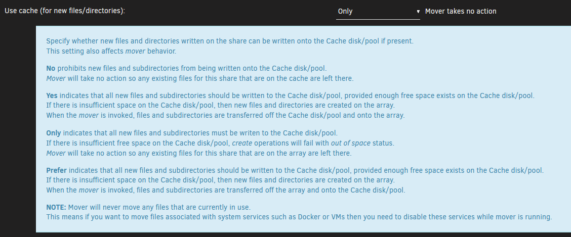

If you turn on help in the shares screen, you will see this which explains how the various options work and their affect on the mover:
My appdata share is set to cache only as the cache drive is large enough that I don't have to worry about appdata filling it up.  Also, I do not use it for caching any user share writes before moving them to the array.
In your case, prefer is recommended simply because your cache drive is so small and it could fill up even without user share write caching.
