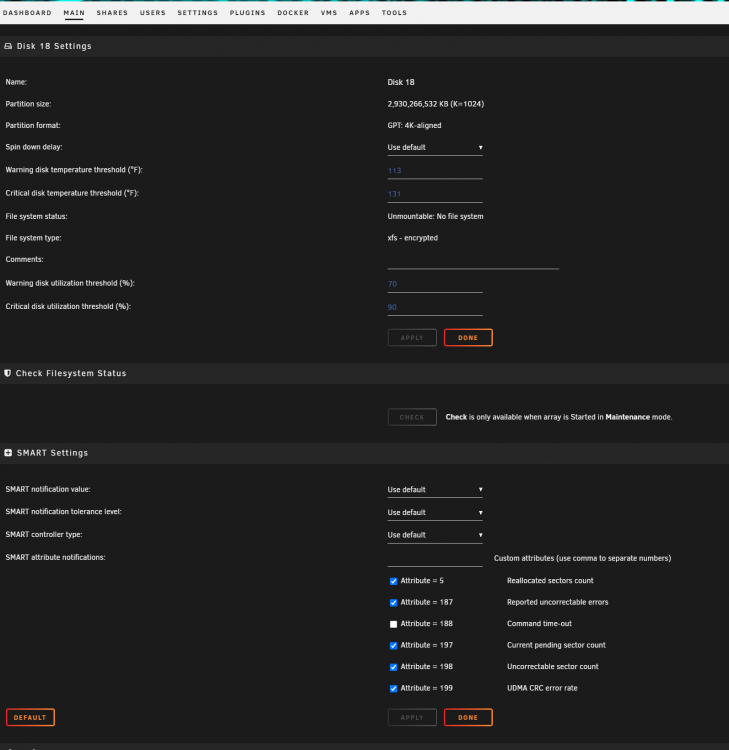

27 minutes ago, srfnmnk said:
FS type is auto -- thus I don't see xfs repair option...how do I run it on "auto" FS type?
I see you have luks:xfs as the default filesystem, so that is what "auto" means. If it doesn't give you the option to do the repair in the webUI you can probably do it from the command line, but I have no experience with encrypted drives so you should wait for someone else like @johnnie.black 😉

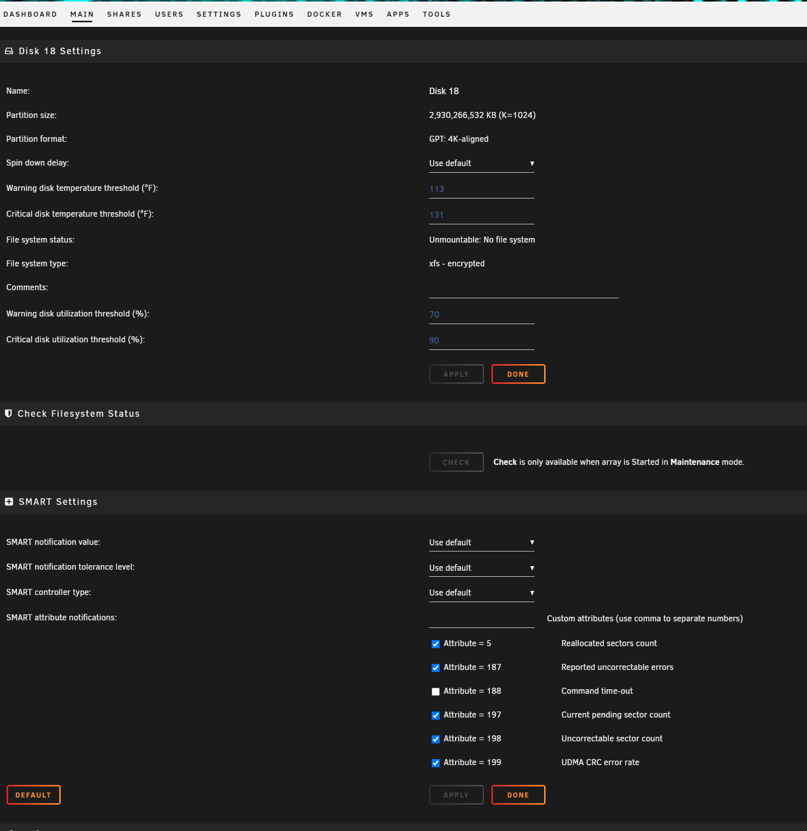

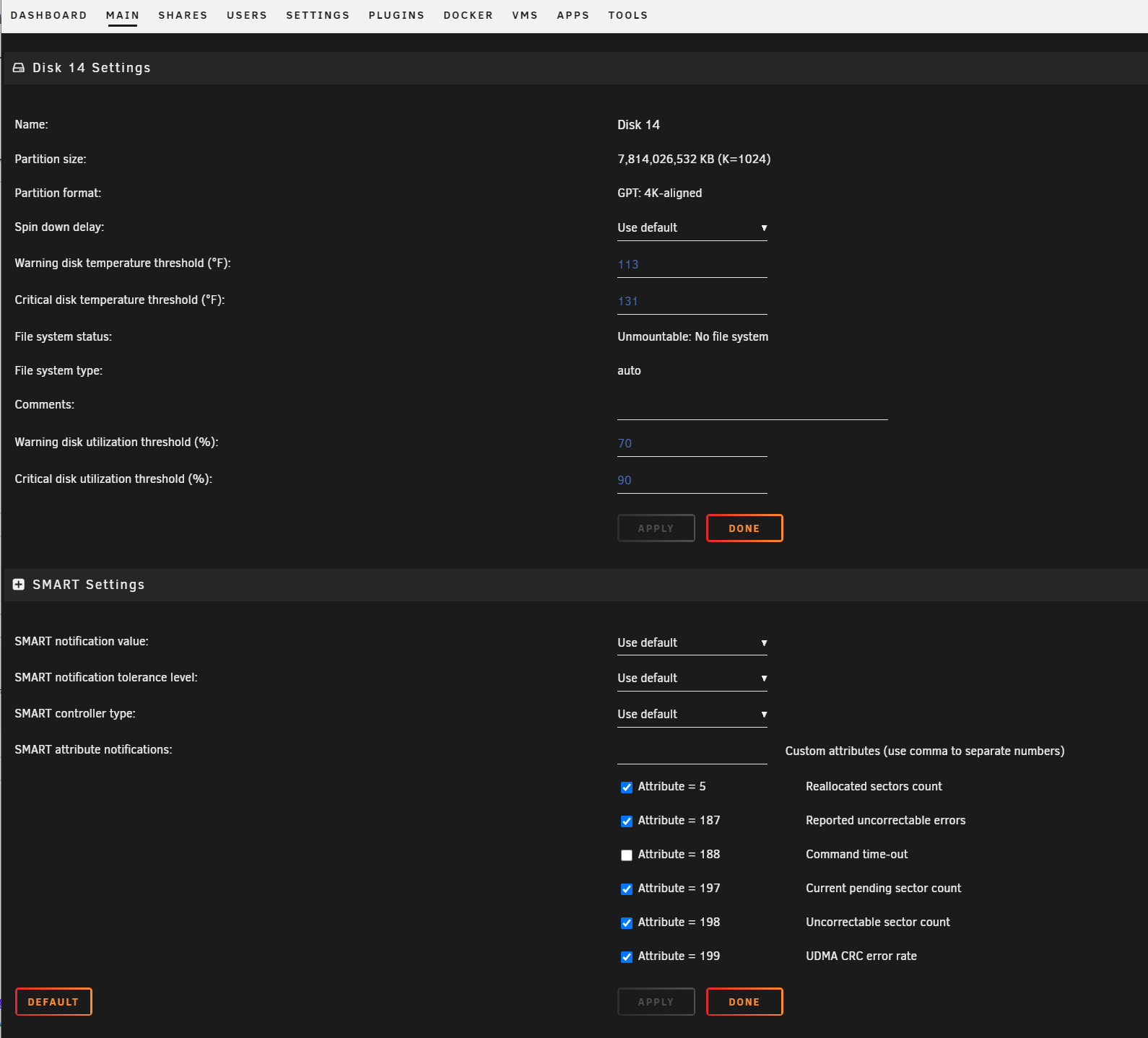

Right, here's the screenshot for Disk 14 and Disk 18. Notice that Disk 14 doesn't have the Check FS block like Disk 18 does.
You can manually set the fs to xfs or run on the command line:
xfs_repair -v /dev/mapper/mdX
Replace X with correct disk #.

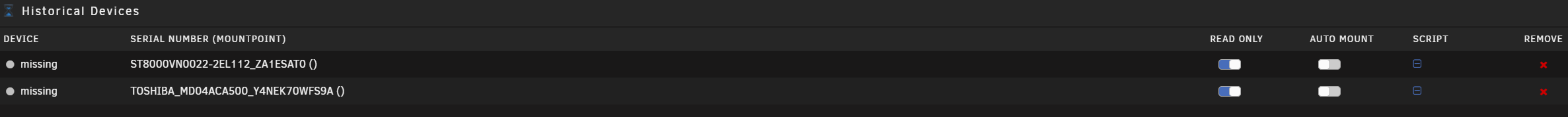

Last point is that I have two drives that are showing up as "Historical Devices". The TOSHIBA is the original DISK19 that became unmountable and the other appears to be my current disk 6. I'm guessing that when we did the force new config stuff this happened, so should i just "remove" them with the red X?
That's from the UD plugin, but yes you can remove them.

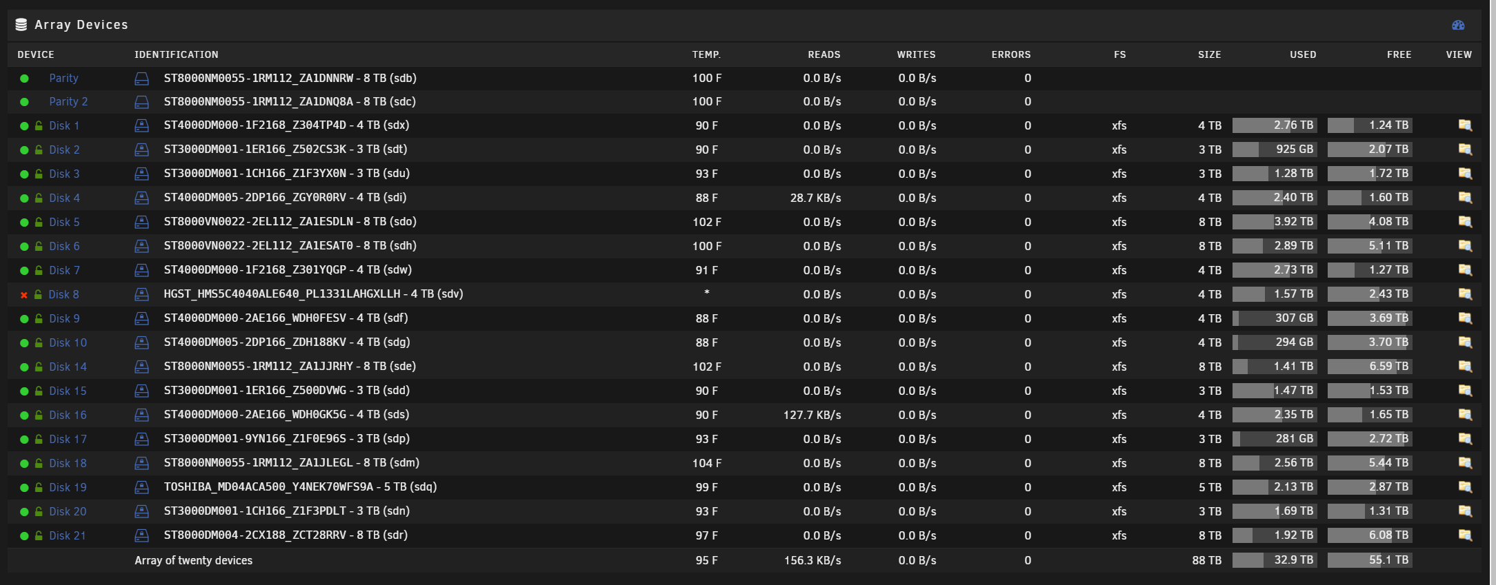

I thought that would be the end of it...BUT...that evening a wholly new disk became "disabled" (Disk 8 - SN: PL1331LAHGXLLH). So on I go:
  • I notice that the emulated files from disk 8 are unavailable. I ssh in and verify that I cannot make a copy of any files on disk 8 from ssh console...i tried both /mnt/disk8/... & /mnt/user/<share>
  • xfs_repair in maintenance mode had same superblock issue so -- xfs_repair -vL on Disk 8 (eumulated) just disabled.
  • Ran an extended SMART test and it passed...
  • now xfs_repair -nv looks normal but the drive is still disabled...

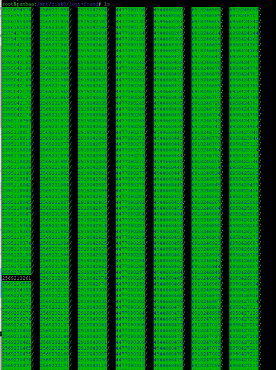

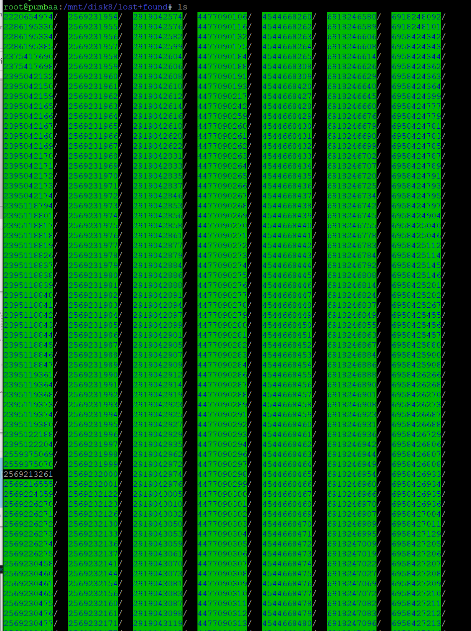

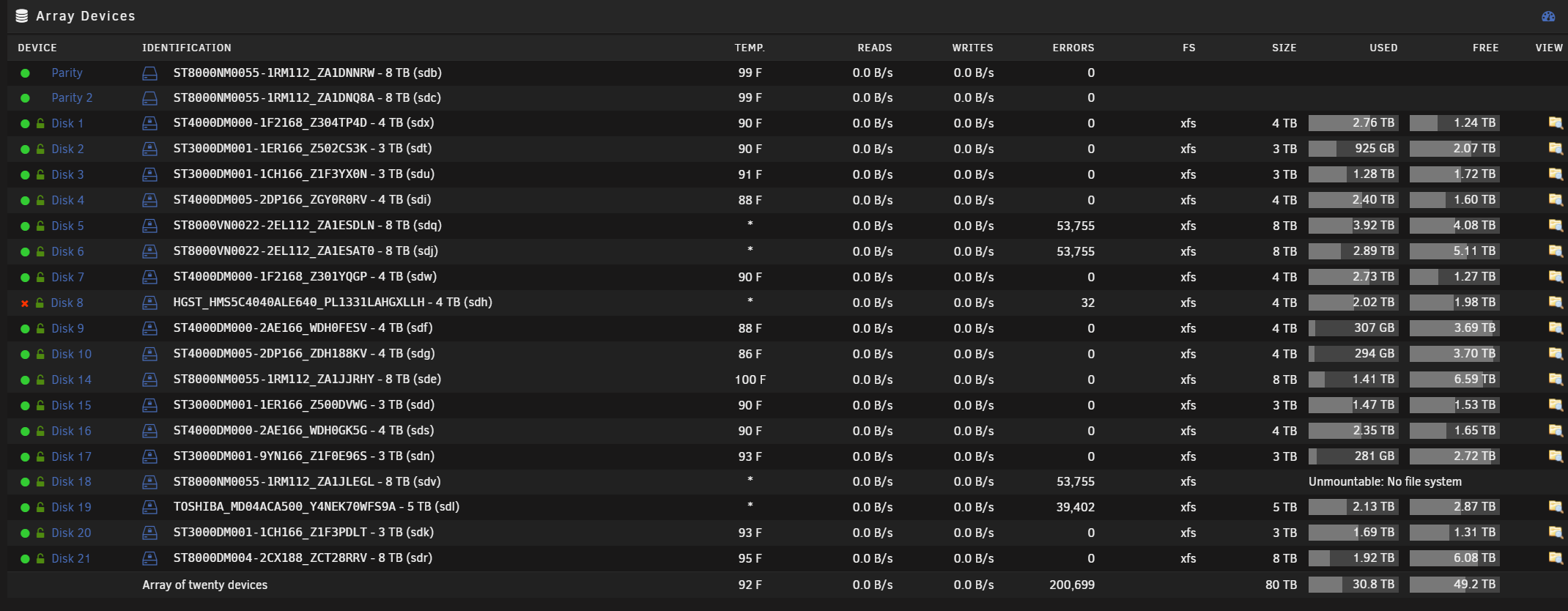

  • Restarting the array shows that the files are being emulated but the files are not there. Looked in (from ssh) /mnt/disk8 and /mnt/user/<share>... and they're in neither place...so I proceed to check lost+found and there are 2261 dirs with data in them but they all have IDs...(screenshot attached) The data is all throughout these folders...
What the devil is going on?! Ideas? Before I build a new config or do anything else I wanted to check in and get your thoughts. I'm worried that if I do another new config and note that disk 8 is good that we might be going in circles now...
It seems I did have 2 bad drives -- both have been replaced and rebuilt -- but why drives keep becoming disabled?
How to get disk 8 enabled again and get the array healthy again?

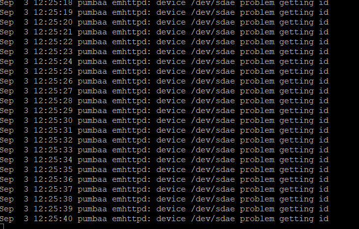

Attaching some screenshots and a new diagnostics package of current status. One other note, when the array is stopped, (maybe other times too) I see this scrolling error in the log "device /dev/sdae problem getting id" (screenshot attached) but I don't see any sdae devices anywhere in unraid gui but on ssh it does exist in /dev folder.

The effort required to replace and rewire the PSU is significant, is there anything else that it could be? I would like to rule out absolutely everything else first. :/ There are some ongoing errors such as the /dev/sdae problem getting id and what not...
