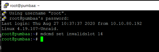

invalidslot might be the more direct way to do it all at once instead of trusting parity first, then replacing. But, invalidslot requires overriding the webUI from the command line at one point in the process.
Let us know when you get the replacement and we'll see if we can reach consensus.
I'm pretty comfortable with linux if you can point me to a doc or provide a sample. Why is that necessary/better than rebuilding the config? Just trying to figure out what the options are and why that may be better than others...
Invalid slot is a more cleaner way of doing it, just make sure you follow the instructions carefully and ask if there's any doubt.

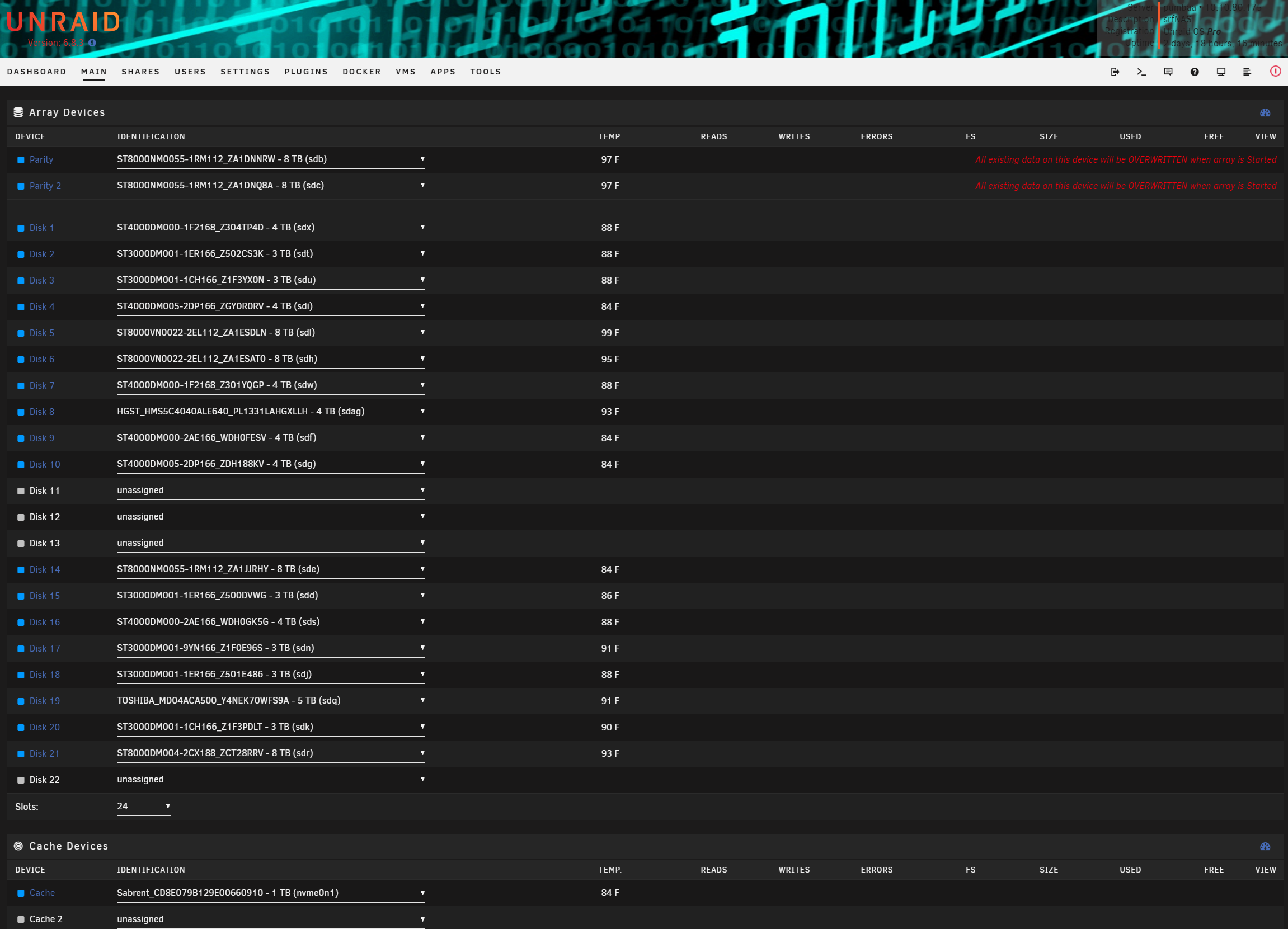

-Tools -> New Config -> Retain current configuration: All -> Apply
-Check all assignments and assign any missing disk(s) if needed, including new disk14, replacement disk should be same size or larger
-Important - After checking the assignments leave the browser on that page, the "Main" page.

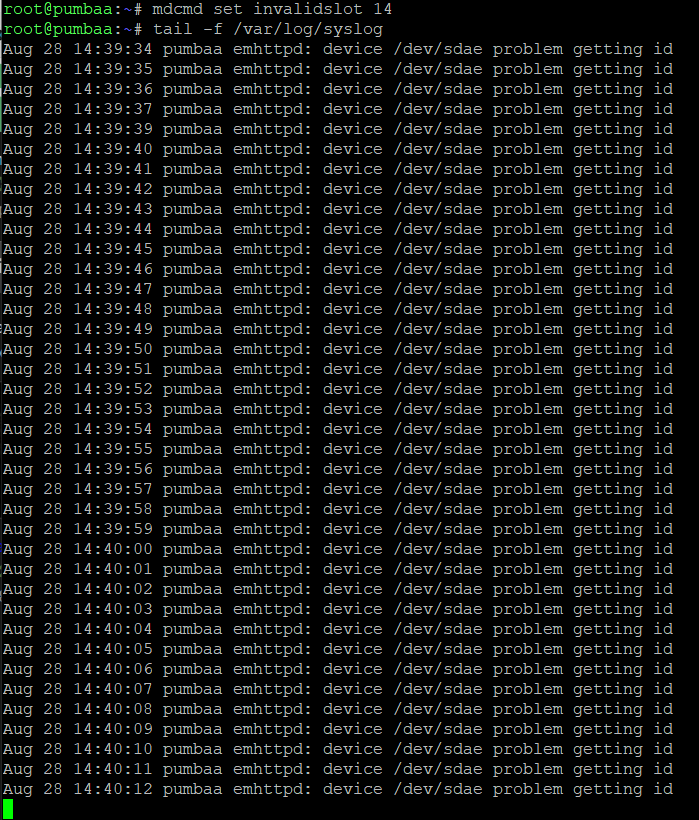

-Open an SSH session/use the console and type (don't copy/paste directly from the forum, as sometimes it can insert extra characters):
mdcmd set invalidslot 14

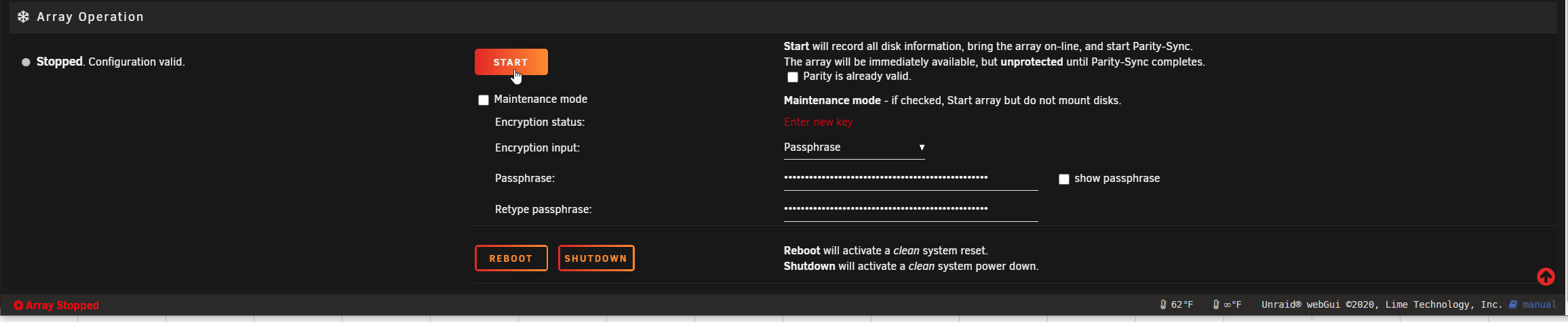

-Back on the GUI and without refreshing the page, just start the array, do not check the "parity is already valid" box (GUI will still show that data on parity disk(s) will be overwritten, this is normal as it doesn't account for the invalid slot command, but they won't be as long as the procedure was correctly done), disk14 will start rebuilding, disk should mount immediately (possibly not in this case since parity won't be 100% valid) but if it's unmountable don't format, wait for the rebuild to finish and then run a filesystem check

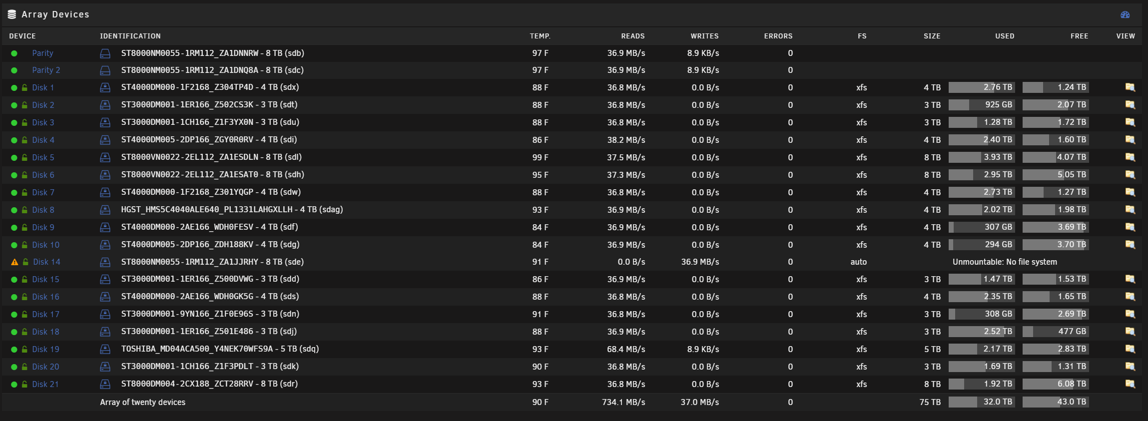

HOLY SMOKES -- I think it's working. I cannot thank you two enough for all your help. I never would have figured this out. Another reason to keep recommending Unraid.
I am attaching some screenshots through the process in case it may help anyone in the future.

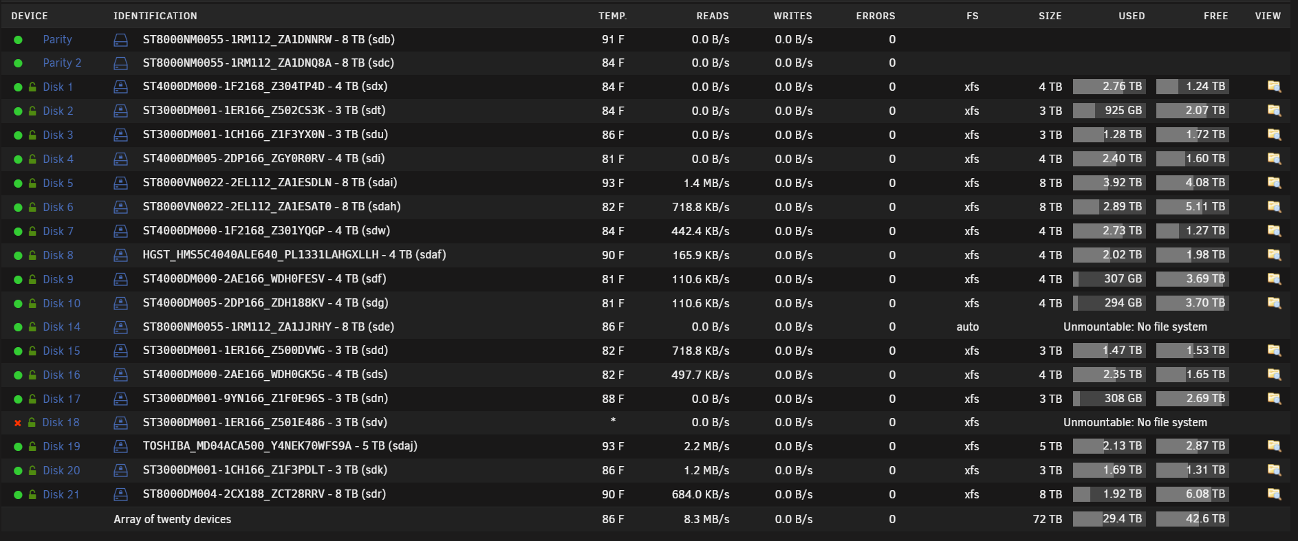

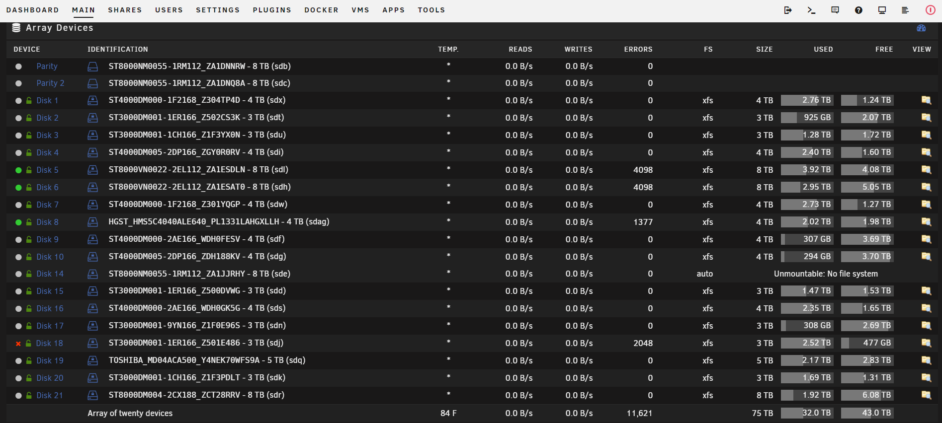

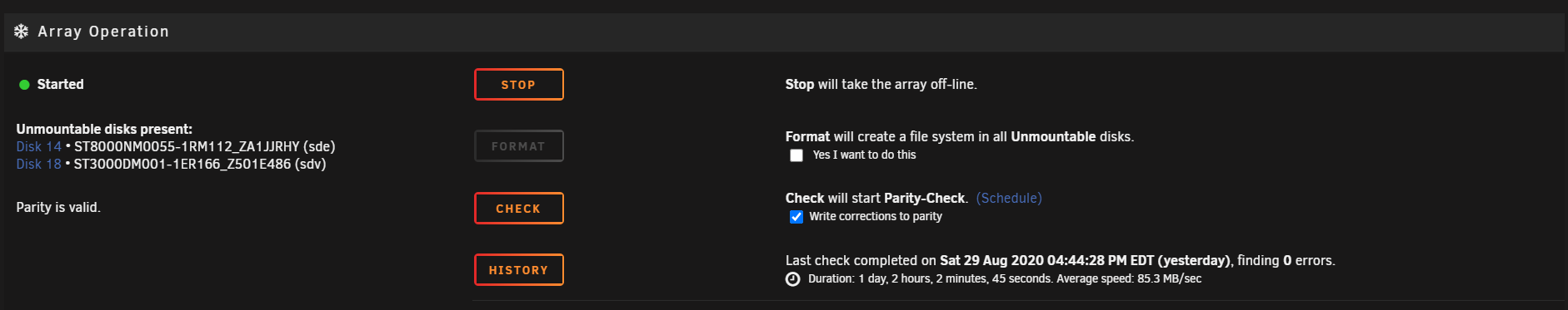

Yeah it's not mountable, so I'm guessing I need to format it. Lot's of weirdness still. Attaching new diagnostics and some screenshots of current state.
pumbaa-diagnostics-20200830-0930.zip
If you format an ‘unmountable’ drive then you are effectively discarding its contents.   If you want to try and attempt to keep its contents then you need to follow the process for a file system Check/Repair.
Little confused about your screenshots. They both seem to indicate rebuild of disk14 completed, but disk18 is now disabled.
The 1st screenshot shows 2 unmountable disks, the rebuilt disk14, and the disabled disk18. The 2nd screenshot shows only 1 unmountable disk, the rebuilt disk14, with the disabled disk18 mounted.
The diagnostics indicate both 14 and 18 are not mounted.
Do you have any new information to add or anything else that might clear up this discrepancy?
Also, what itimpi said above.
