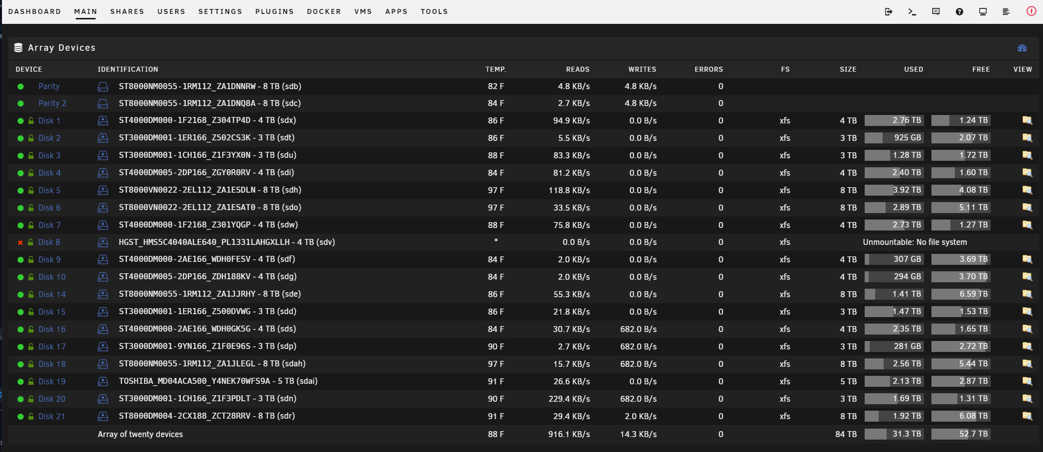

There are a LOT of folders but disk 8 is still disabled...so not sure if a new config and rebuild would help it or what. But to Johnnie's point...there may be something going bad hardware-wise. :/ I keep getting different read errors on different drives. As you can see from the image below today it's disks 5 and 6 but I've seen them elsewhere. These read errors...does that mean corrupted data or does it mean it failed to read (maybe not a data error)? If the latter, then I'm guessing that this may happen during rebuild causing the issues and may be intermittent hardware issues as Johnnie is eluding to. :/ man...I have 3 LSI cards in there with dual sas ports each haha...hrmm...

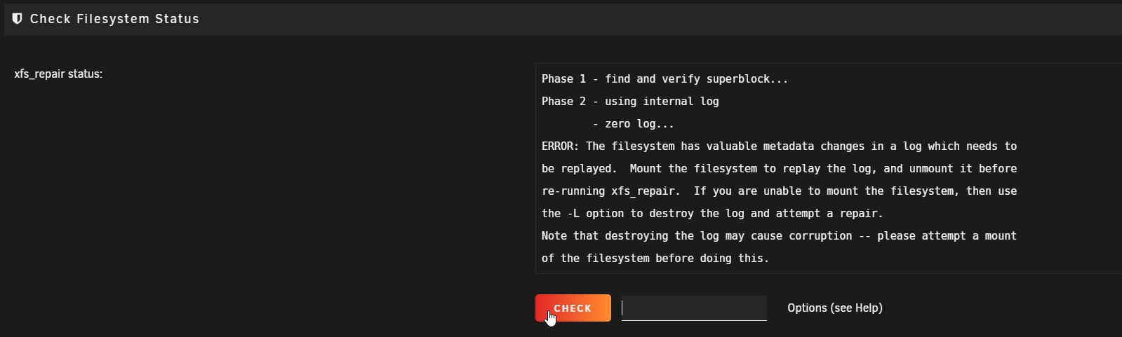

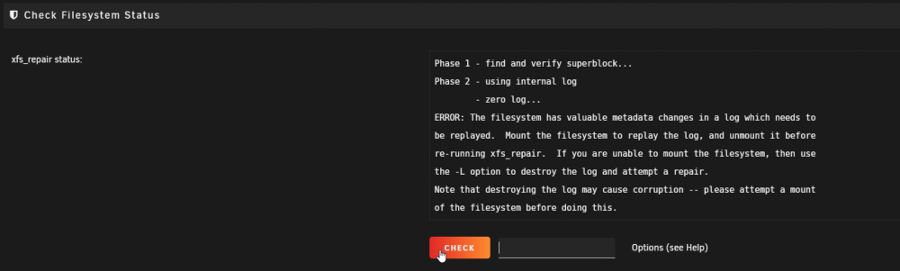

For the errors on disk 5 / 6 (where i had the read errors), I did a check disk -nv from UI and it noted that there were valuable metadata changes. So In maintenance mode (because it's grayed out when array is on) I ran the xfs_repair "check" and it tells me it's not mounted. It is mountable but in maintenance mode it seems as though I cannot do a repair. Should I enable the array and run the xfs_repair -v /dev/mapper/md5 from cmd?
Don't do that, just reboot and they should go back to normal.

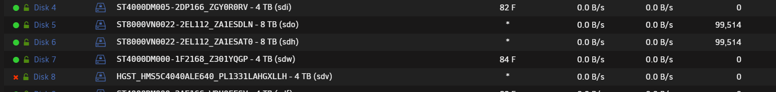

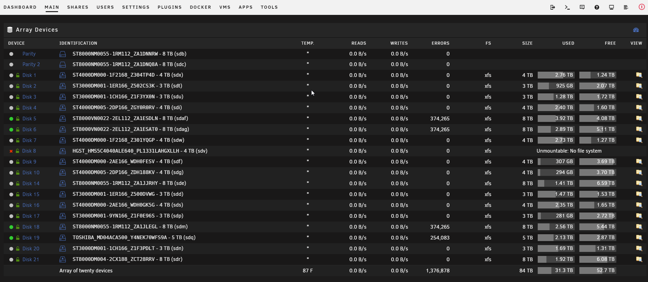

@trurl still struggling. Below is before a reboot.
After a reboot and array start
Disk 8 is mountable via UD RO
and in fact, all of the files that are in lost+found on the emulated driver are here and accessible. Disk 8 also passes SMART self extended.

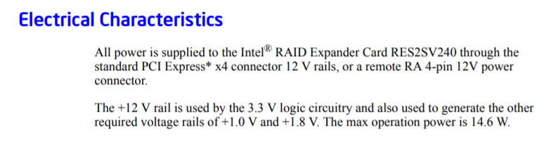

Additionally, I have pulled the data sheet for the PSU and the SAS expander to determine if there are any strange power requirements / considerations when running from molex, I found nothing unexpected. max power draw is 14.6W 12v -- no jumpers or anything to switch. The PSU supplies up to 996W on 12v and with 3 SSDs, 20 HDDs, 1 gtx-1060, Ryzen 3900, and the SAS expander card all running at full tilt "should" not exceed 592W as per seasonic's calculator.

Right, but a 14.6 watt max TDP pcie card pulling from a molex on a dedicated connection...the only thing I can think of is bad wire, bad PSU slot, bad molex connector on card, or just a bad power rail on the card itself. Do you have any other thoughts/ideas on what could cause it? If you look at the SAS Expander datasheet it shows max TDP is 12v / 14.6w

If it's the only thing powered on that string, it wouldn't be an issue - but if you add up whatever amps it's pulling (~1.2A) with whatever else is connected on that string back to the PSU (drives @ ~1.0 to 1.8A each) and it starts to add up
