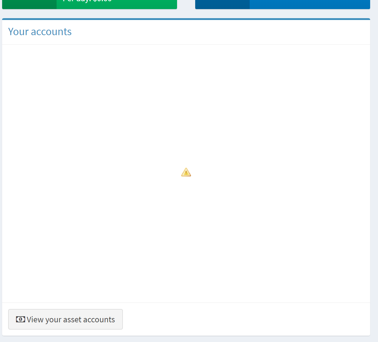

Did something change in latest update related to proxy ? My reverse proxy stop working suddenly. When I go to url of the firefly on my server like https://firefly.server.com it automatically try to do https://firefly.server.com:8080/login why it force the 8080 in there ?
Have you had any luck finding a solution? I'm having a similar issue since the update. I'm using nginx proxy manager and when I don't give it :8080 after the reverse proxied URL I get failure to render / odd behavior:
I also can't interact with the date picker to change the timeline I'm looking at, etc.
If I go to the proxied URL and add :8080 to it, everything runs fine. I've looked through the documentation but all I can really find is information on getting HTTPS rewriting to work with nginx.

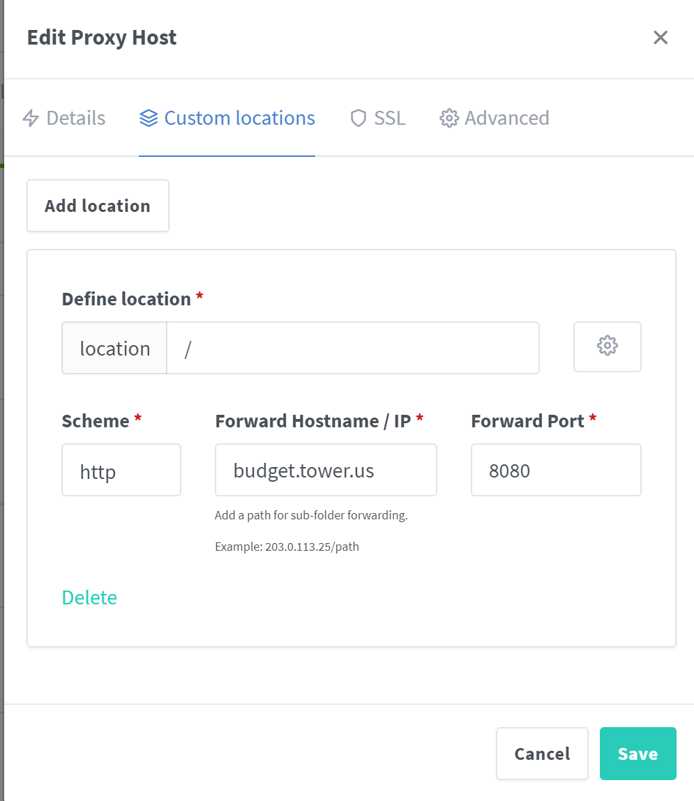

Edit to the edit:
NGINX Proxy Manager needed a custom location at root pointing to my proxied URL with the host-side port. Everything is working fine now. I'm going to leave the other screenshot/description up in case anyone else comes across this post with a similar issue.
 I love you, thanks so much... the custom location fixed it.
