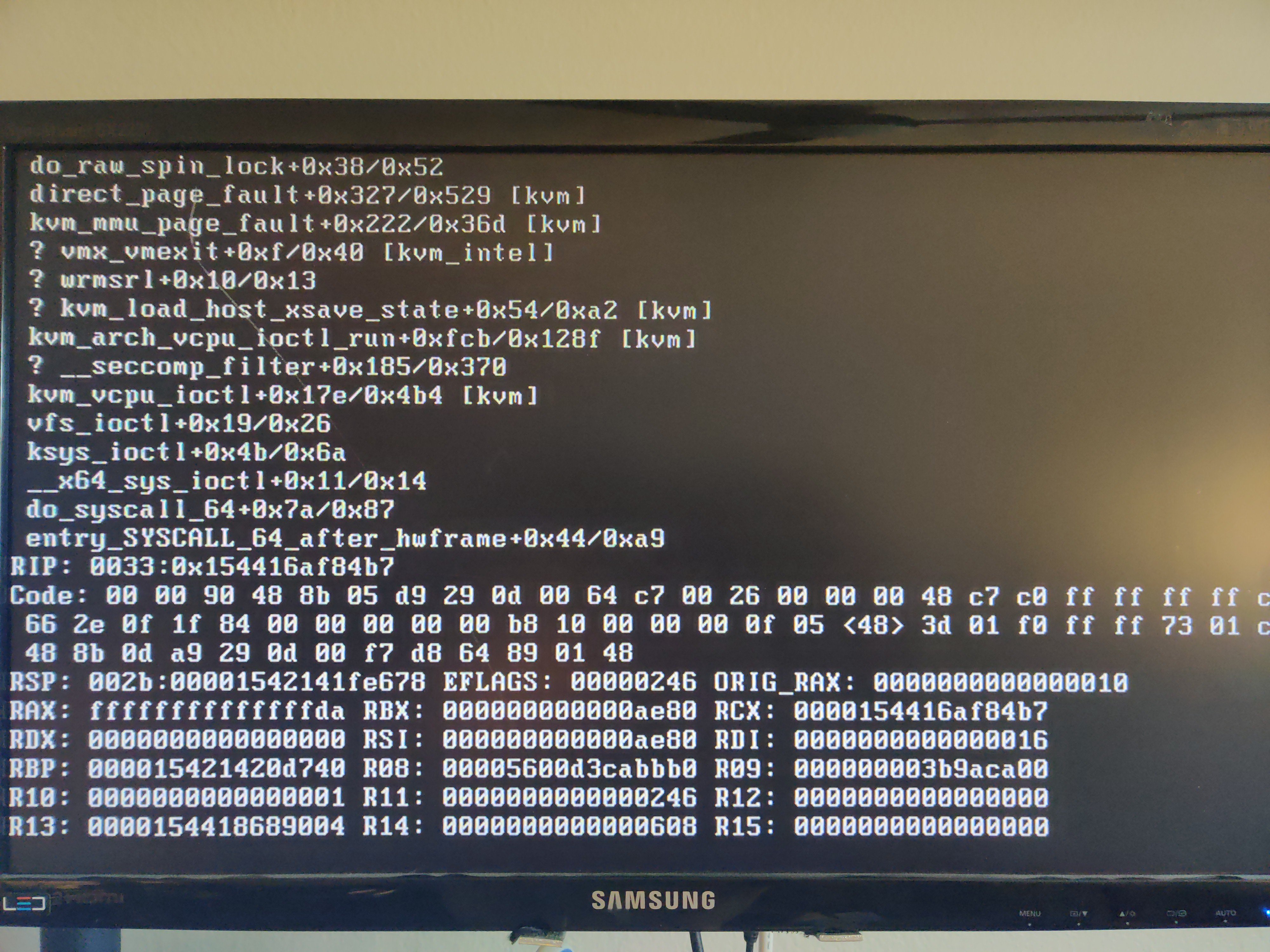

So it ran for about 40 hours or so with the GTX out of the server and I thought it might be working without it at least.  Then I checked it this afternoon and it is completely non-responsive and I had to hard power off.  So basically I can't run any VMs on Unraid without it crashing at some point, which sucks royally.  Here's a screenshot of the local console, if that adds any value for the analysis.
Not for me, but this might:

Just because the error mentions BUG it doesn't mean it's an Unraid bug, in fact most likely it's not, and when it's a hardware problem it's very difficult to diagnose remotely, especially if there's nothing logged on the syslog, if this happens again make sure to use the syslog feature linked above and then post that syslog, it might catch the beginning of the error, the screenshots you posted only show the end.
