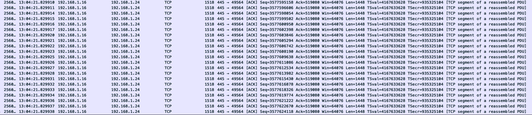

Well. I just installed Wireshark and I'm playing with it.
I recorded different file transfert from my Pi (100mbps) as from this source, the copy works fine even with a 9GB+ file.
And then I recorded file transfert from my Unraid server. Small mp3 file : OK. 500meg .zip : OK. 5Gb ISO : started OK to my surprise, but it suddently crashed (and by crash I mean back to boot screen).
Here are the last lines recorded : 16 beeing the unraid server, and 24 beeing my Big Sur VM.933284330_Capturedecran2021-02-19a13_24_58.thumb.png.5b5efde860630660a1975ed2c98484b0.png
So I see nothing in praticular.
I'm trying now to search the console for hints, but as I'm quite the beginner in this area, this may take a while ^^

Start logging before a file transfer and stop it when it hangs (hope you don't have a kp).
Save the log and attach it somewhere.
From what you are describing it seems an issue related to a cpu kp.
