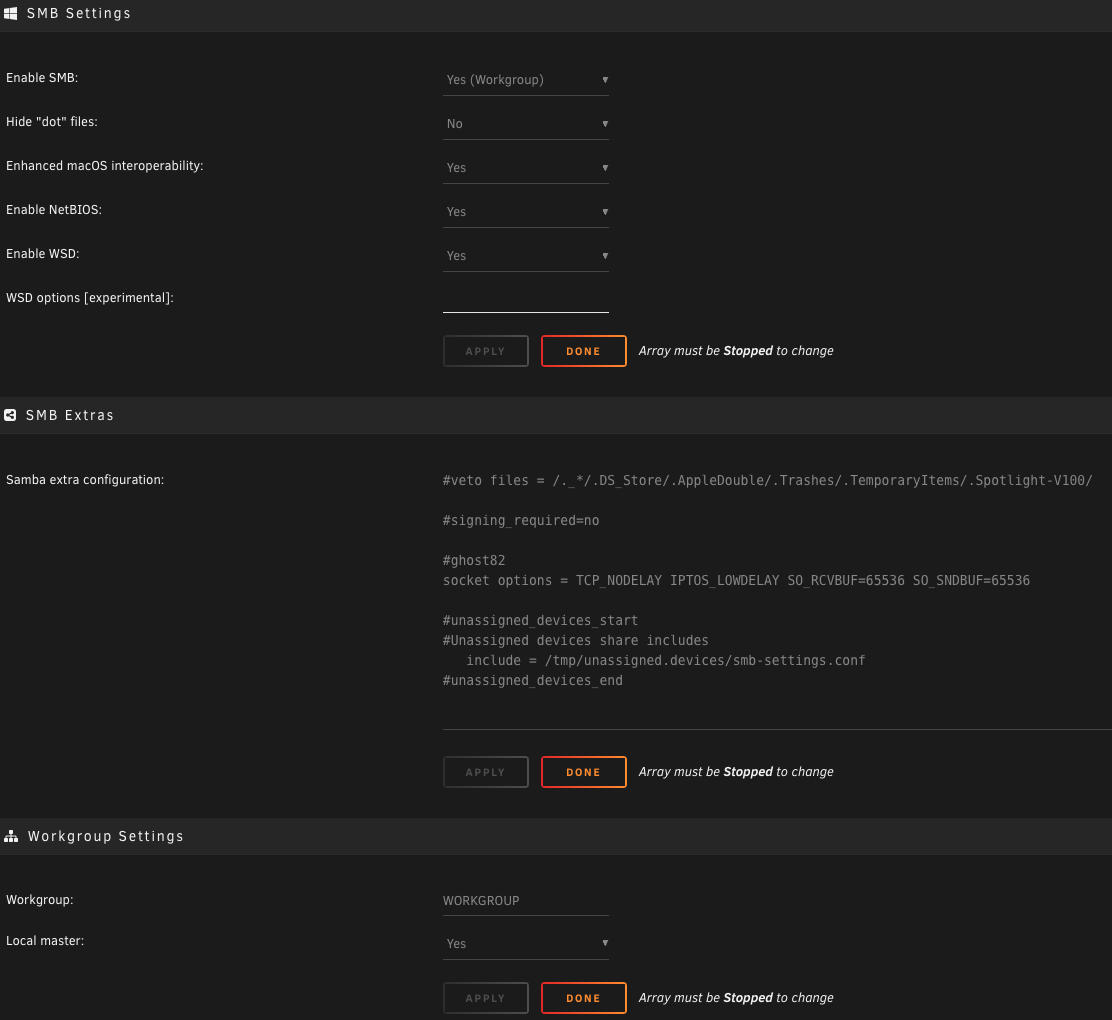

See this:
For me it's working good, no more hangs nor kernel panics, currently tested with Big Sur 11.1 20C5061b, but I'm quite confident it will work with newer/older versions.
Sadly it makes no (visible) change for me.
I added the line in the "Samba extra configuration" field, but the copy of a large file from an Unraid share still hangs at 134.2Mo and after a while error -8084.
(Big Sur 11.1 (20C69))
Edited by bjornatic
Did you restarted the server after new config or stopped/started array?
Edited by ghost82
Yes. Both.
Edited by bjornatic
Soooo... I moved to 11.2 beta 2 (20D5042d) with big hopes and faith it would be fixed so I can go on with my life.
But no. Every single big file copy from my Unraid shares stops at 134,2Mo. Hangs and then error -8084
With or without ghost82 proposed solution.
Trying to make a full Time Machine backup lead to a complete system crash.
I could make my first complete Time Machine backup without carshing. So there is a bright side to this update.
Edited by bjornatic

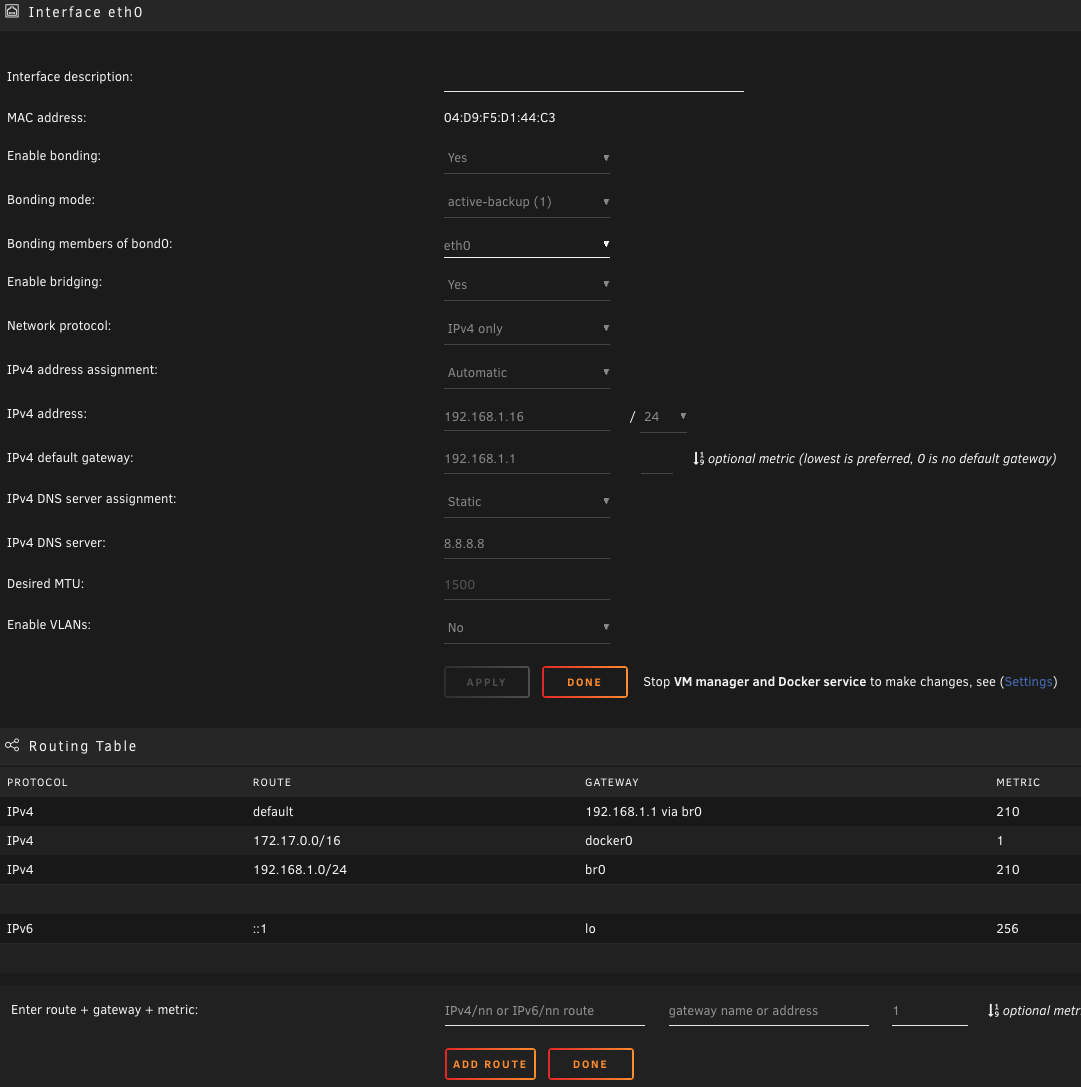

I still can't figure out why it is not working for me and it's starting to be problematic.
I switched to vmxnet3 for a while and local network worked okayish (I could transfert data from the server and I could do TimeMachine backups), but the upload rate to the www was close to non existant. So I'm back on e1000-82545em.
And as I'm not getting any progress on my own here are my settings :

My network settings :
And SMB settings :
If some of you can see somthing wrong, that would be helpfull as I still do not understand why the solution proposed by Ghost82 is working for some and not for me.
Edited by bjornatic
Hi, not sure if it makes the difference, but can you try to add [global] to your smb extras?
[global]
socket options = TCP_NODELAY IPTOS_LOWDELAY SO_RCVBUF=65536 SO_SNDBUF=65536
Reboot and test.
Edited by ghost82
No luck... 😑
