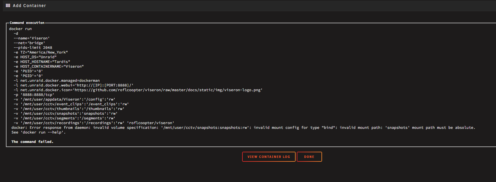

I had to manually create & pass volumes for event_clips, thumbnails, snapshots, & segments, then the container started working.
I had to delete a bunch of variables from the template when I created the container (they didn't apply to me), but I swear none of these paths were in the default template...
I can't tell if the recordings volume is actually even used for anything in this image; the container doesn't auto-create the missing volumes within the recordings directory.
But I got the container to start, and once I got my cameras to behave, they were visible through the Viseron webUI.

hi i tried to install this on ubuntu server and it didnt install right . and i installed the docker version and it doesnt work either... the log i guess complains about storage? here is the logs but so far ive not been able to install it on docker ubuntu or docker unraid so much for seemless installi lol

I'm not sure I understand correctly (if you're running the container on Unraid or an Ubuntu VM?) but I had exactly the same issue you did. I simply added the paths to the container manually like Porkey suggested above and the container started and I got into the web UI.
I am not too familiar with Unraid sadly, but the template has the folders defined for v3+.

@Porkey how did u set it up do you have any pics ? i thought i did what you did but it just errors out and orphans the container
You seem to have a typo in teh snapshots volume mount. You are missing a forward slash there if you look carefully at the docker run command.
Unsure how to fix that tho, its not from the template however
ok thanks for noticing.. since the template never had any of those 4 paths and when i filled them in like proky mentioned i just typed them in didnt notice the / missing and took a guess how it set up
