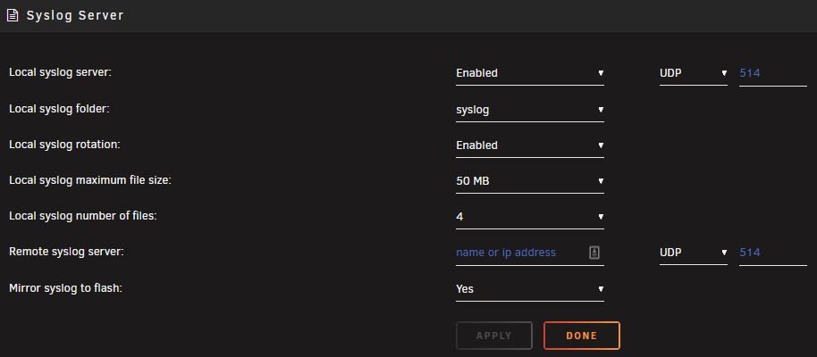

Now, regarding the syslog configuration, is this something I should be concerned about (and do I need to take any action)?
Lines 66 & 67:
Line 123:
Edited by MarkRMonaco
Post a screenshot of your Syslog Server settings.
I also put a screenshot of the specific lines that were called out from the /etc/rsyslog.conf file in my previous reply.

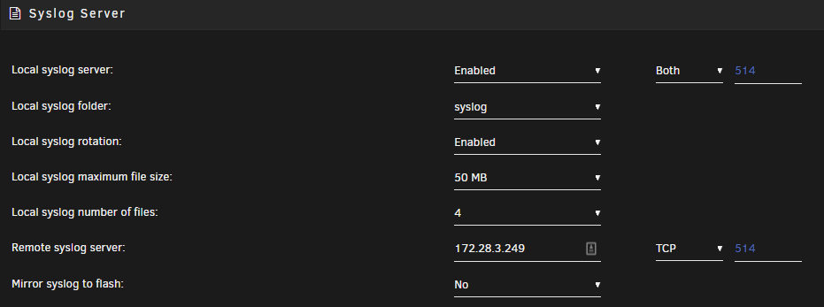

I think you have to fill in the Remote syslog server to tell Unraid to send them to itself.
This is mentioned as the 3rd option in that FAQ I linked.
Thanks. I missed that part.
With the "flash mirroring" option turned off and the syslog server set to "both" for protocols, I'm still getting one error message returned when the service started/restarted:
Starting rsyslogd daemon:
/usr/sbin/rsyslogd -i /var/run/rsyslogd.pid
rsyslogd:  Could not find template 1 'remote' - action disabled [v8.2002.0 try https://www.rsyslog.com/e/3003 ]
rsyslogd: error during parsing file /etc/rsyslog.conf, on or before line 121: errors occured in file '/etc/rsyslog.conf' around line 121 [v8.2002.0 try https://www.rsyslog.com/e/2207 ]
Current Config:
I also checked my "syslog" share, and it looks like it is not populating with any files as well...

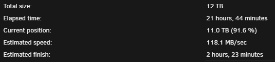

Just an update, my drive is almost 100% rebuilt and I have not ran into issues with it being unresponsive (yet). So, it looks like one of these steps (above) solved the issue.
I am, however, still experiencing issues actually getting syslog working at all. The Unraid share has yet to be populated with anything, and I am still running into that single error message whenever the service is started or restarted.
