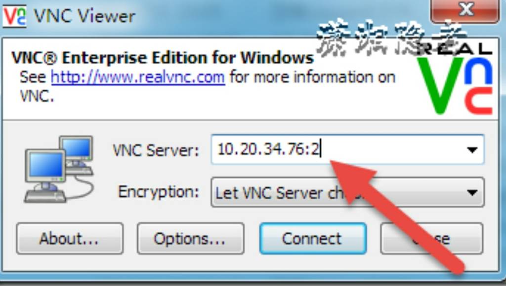

No it does not. I'm already using Real VNC Viewer to connect to the VM behind the router without port forwarding.

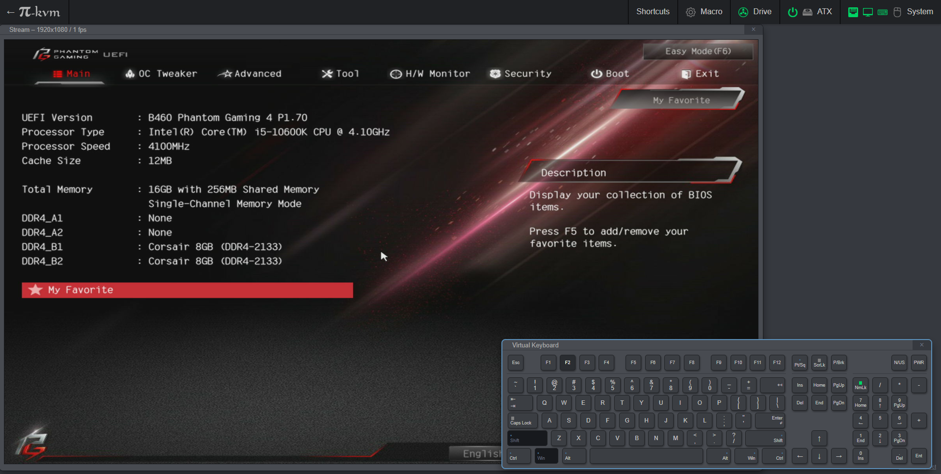

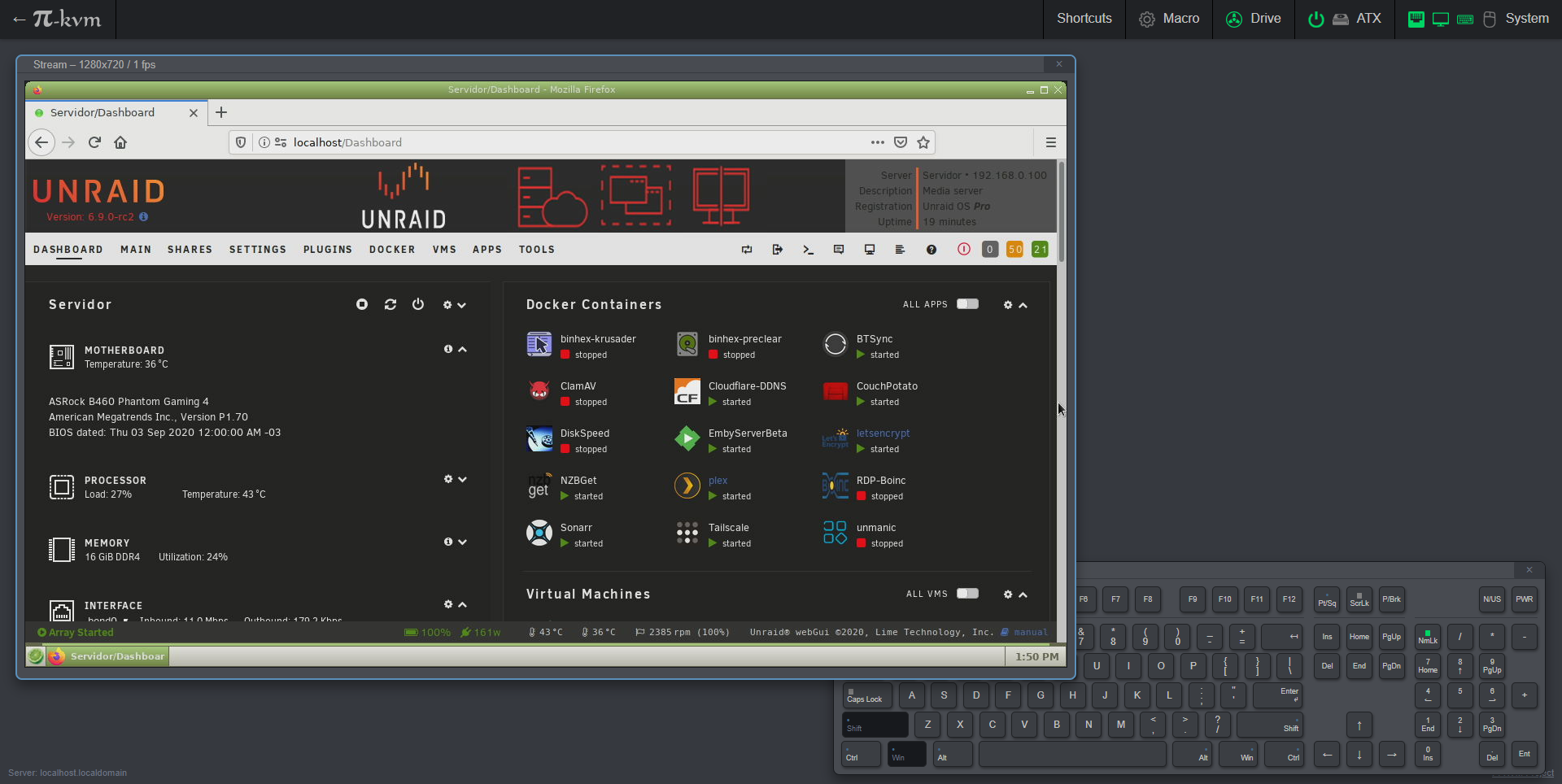

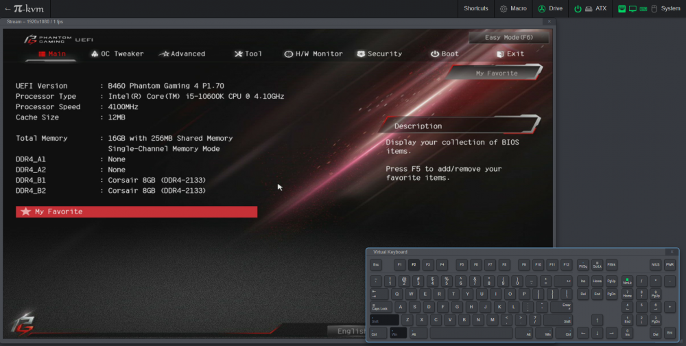

Good news, just finished mounting my V2 Pi-KVM and this thing works flawlessly, much better than my old Supermicro motherboard IPMI.
Ok, hardware monitoring is absent, so no hardware errors etc, BUT media mount and live CD boot works, you can easily setup your BIOS, power on, power off or reset your machine, use virtual keyboard and mouse etc.
