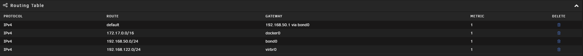

And Network/routing config from my UnRAID seems good
