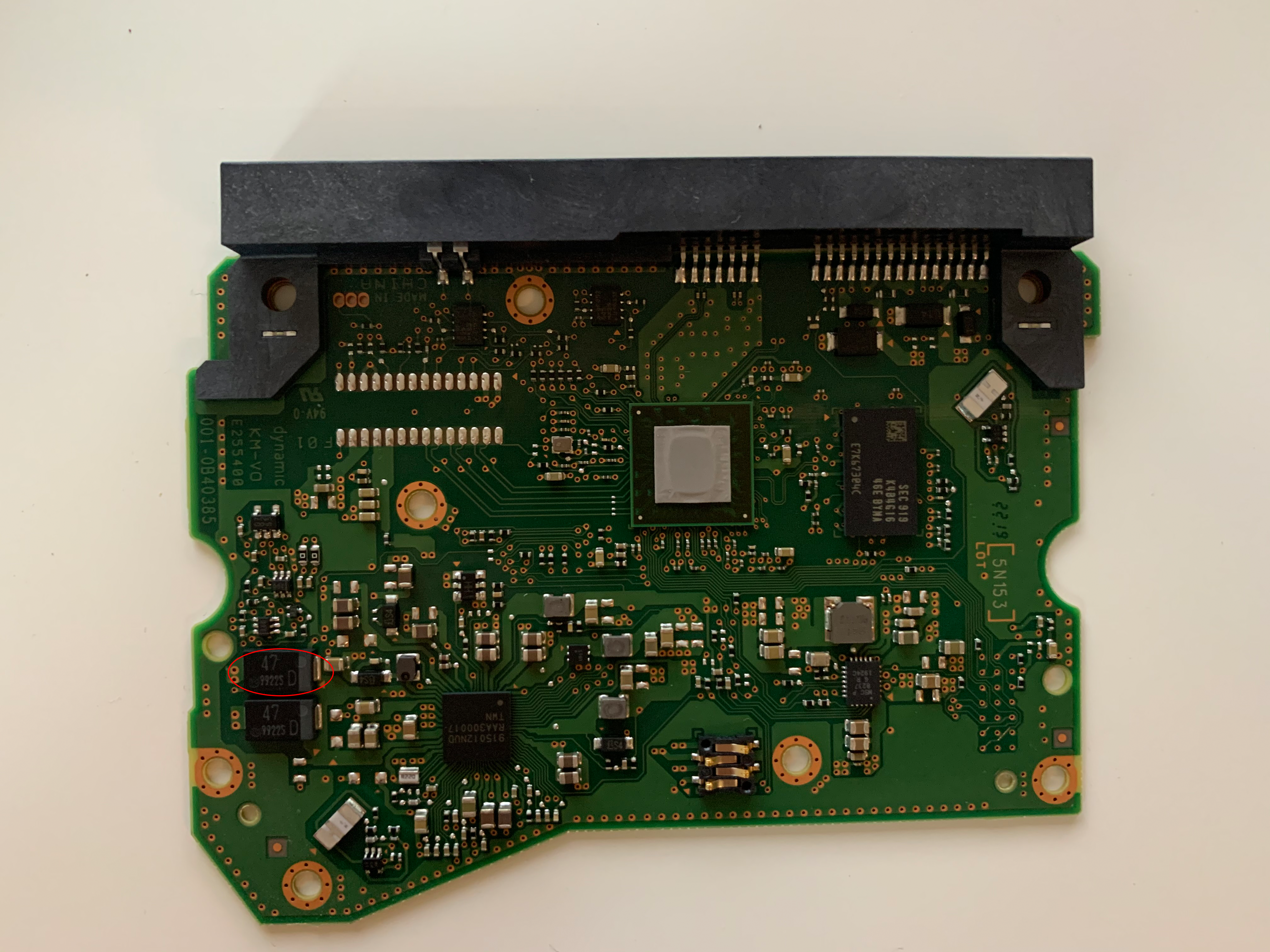

Yes, enough. Remove the protection diode won't cause any problem in normal situation.
And provide two reading as below pic

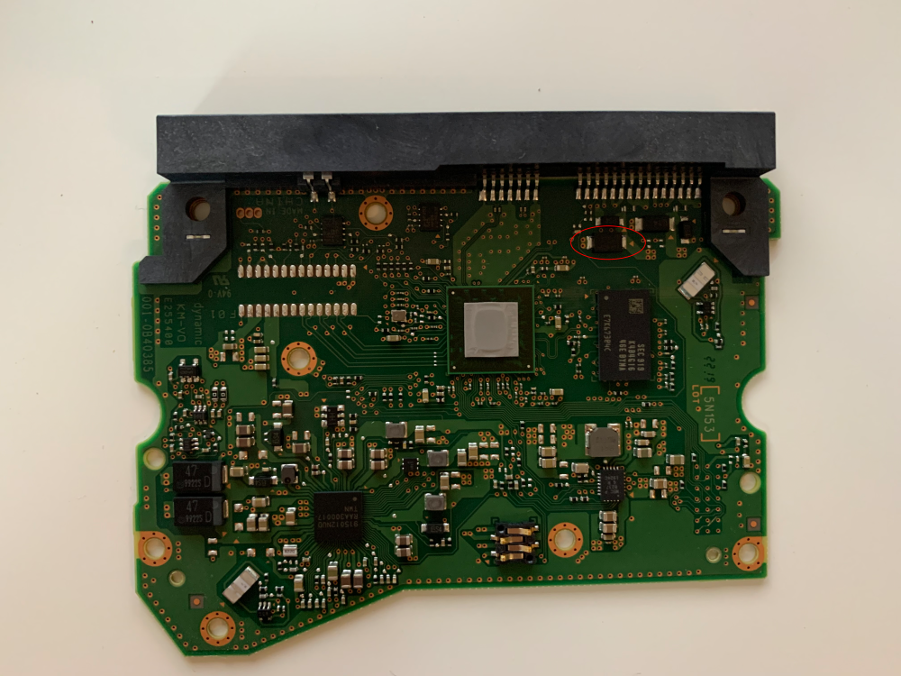

I just removed the PCB. So one of the bigger diodes in the circles are the protection diodes, right?
Yes, trace the diode which connect the RED wire at power plug side. Bottom left one not relate.
Any burn-out found ?
Sorry, what do you mean? Which Red wire? On the picture is no wire. Do you mean the line? so this one? (Circled)

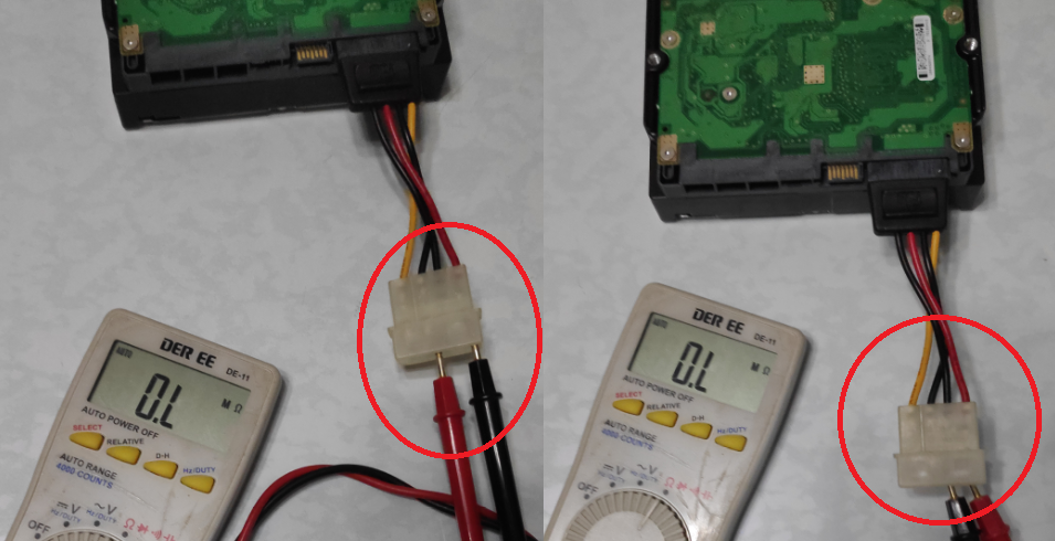

So now I do have a multimeter.
In OL Mode the obove D47 rings up.
This could be the one to remove.

Pls test on molex power plug and not on component as previous two PIC show, if both readings are OL, then you should get professional service for get back your data.

What I tried by myself: Tested with multimeter the drives connected with a SATA to Molex Adapter.
All crossed (Alternating red and black cable with the sensors) Red/Black measurements shows OL; all Black/Black gives me ring up.
What does this mean when I go to a PC Doctor?
That meams you can't simple fix it by remove TVS diode.

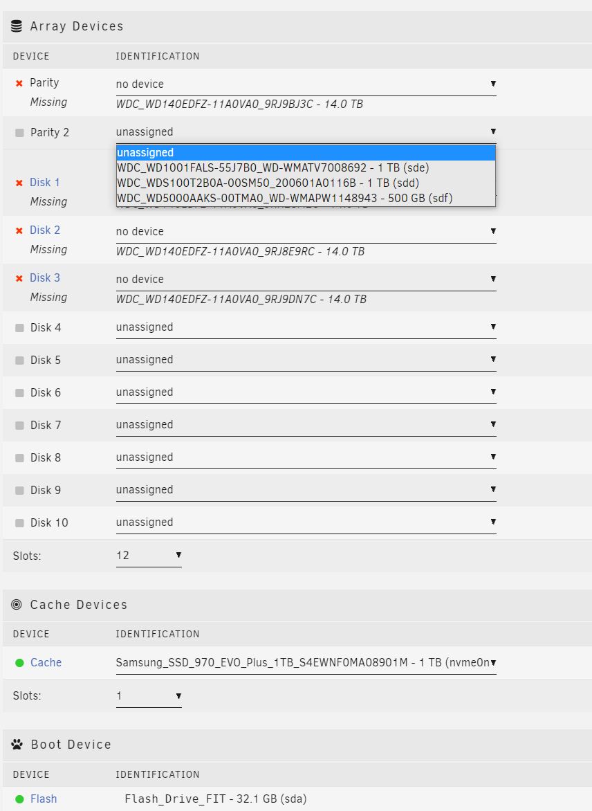

Alright, I guess I have to restart it from scratch. At least with new drives. But how does it work in my current Unraid?
How do I set up a new Array in Unraid? At the moment my old drives are still shown up as "disabled/missing".
Choosing a different Drive gives me the message "wrong" What is the best way to replace the old setting?
This is how it currently looks like:
Tools, New Config
