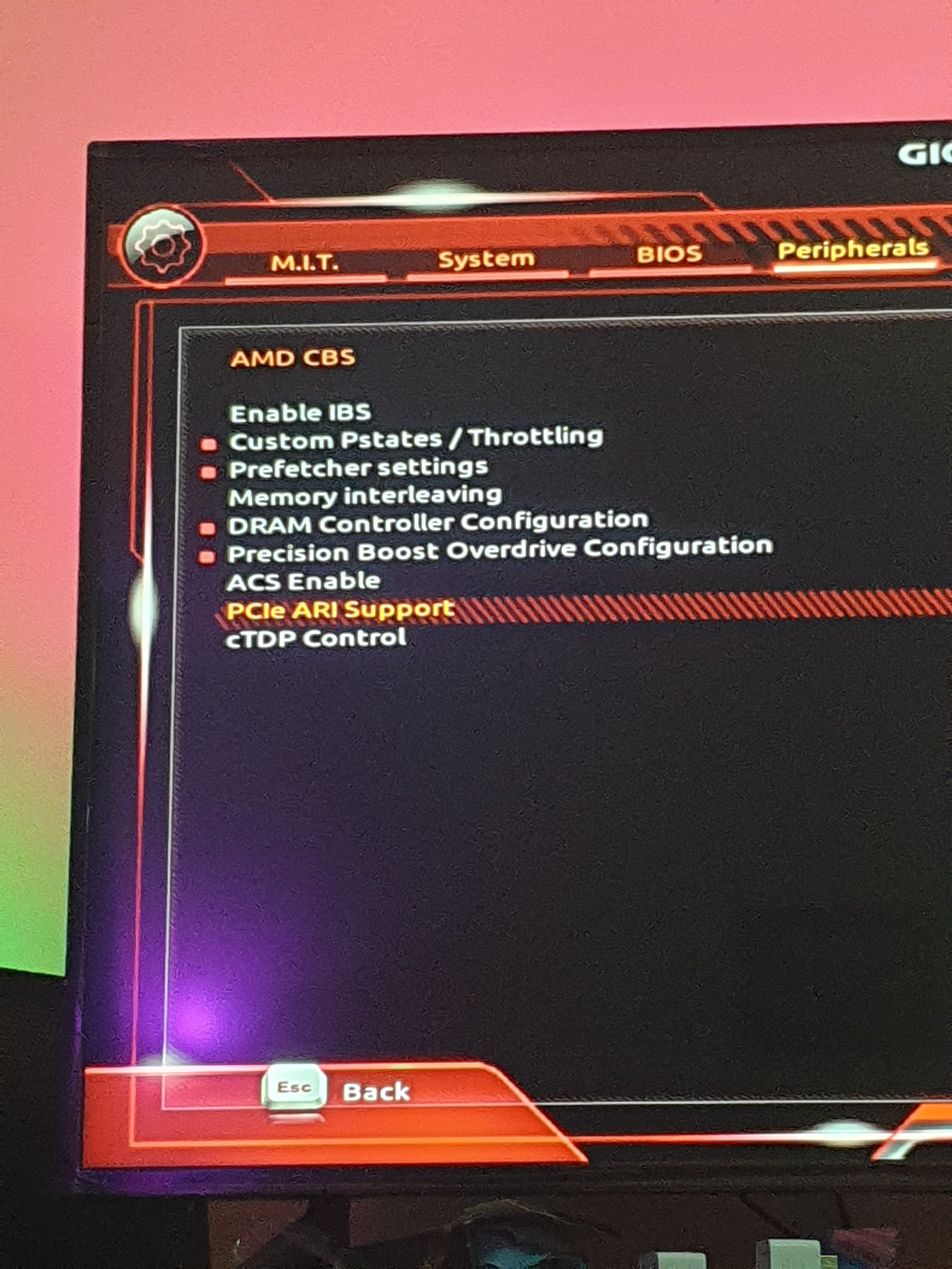

AMD CBS - ACS Enable
I never noticed a ACS Enable setting in the BIOS maybe that'll help so it's getting enabled.
Though now I'm wondering what PCIe ARI Support is??? (Update ARI made the vm crash on boot but ACS Enable seems good.)
Update..... This setting gives me the same level of group separation as enabling the "both" option in the VM settings and i now have that set to Downstream and it works fine
