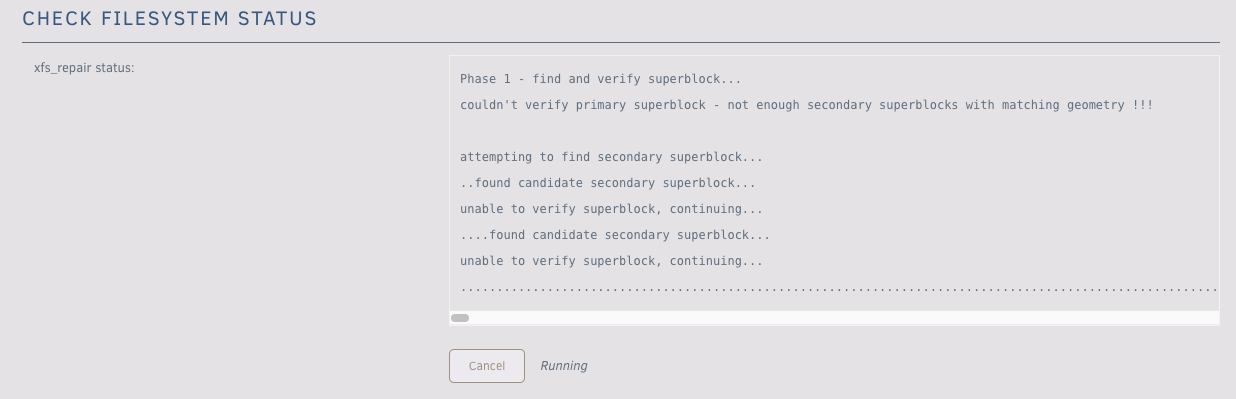

October 25, 20206 yr Author Im running the filesystem Check and it seems to be stuck. Phase 1 - find and verify superblock... couldn't verify primary superblock - not enough secondary superblocks with matching geometry !!! attempting to find secondary superblock... ..found candidate secondary superblock... unable to verify superblock, continuing... ....found candidate secondary superblock... unable to verify superblock, continuing... I read somewhere that this check can take a long time, but its been running for over 20 hours now.
October 25, 20206 yr Community Expert Did disk10 rebuild complete yet? Since rebuild has to read all other disks it might be better to wait until after that rebuild to try the repair.
October 26, 20205 yr Author Its still showing as running. Its been about 40 hours and nothing has changed

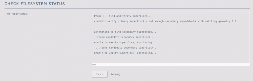

October 28, 20205 yr Author Not sure how long it ran for but was less than 24 hrs, when running manually, eventually, I got this:
October 28, 20205 yr Author I updated xfsprogs, ran the repair again and still seeing the same thing as i saw initially. It's still running
October 29, 20205 yr Community Expert You can cancel it, it won't work, weird part is that Unraid is attempting to mount the fs, but then xfs_repair can't find a valid superblock, never seen this before, you might be able to get some help on the xfs mailing list.
