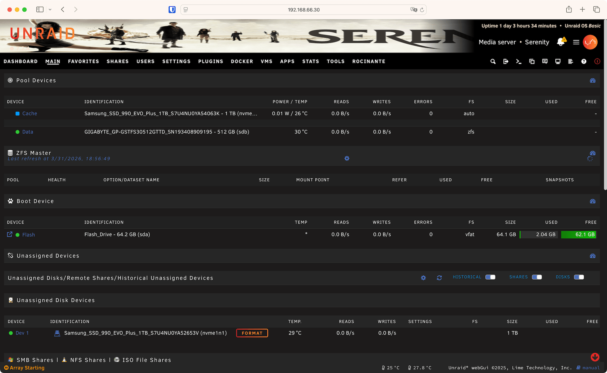

  14. @JorgeB , server keeps at Array Starting after adding the pool. And taking diagnostics doesn't seem to work either as it hangs at smartctl -x '/dev/sda' 2>/dev/null|todos >'/serenity-diagnostics-20260401-0756/smart/Samsung_Flash_Drive_0355025010003213-0-0-2025-12-18 flash (sda).txt' /usr/sbin/zpool status 2>/dev/null|todos >>'/serenity-diagnostics-20260401-0756/system/zfs-info.txt'

  17. Well that seemed to have ended in a panic after following your instructions, so removed pool after stopping array. Created a new pool with the same name and 1 slot and assigned nvme01n1 to it and file system on auto. After starting the array I see the following happening (terminal window was still opened) Message from syslogd@Serenity at Mar 31 18:53:54 ... kernel:VERIFY0(zap_lookup(spa->spa_meta_objset, spa->spa_feat_enabled_txg_obj, feature->fi_guid, sizeof (uint64_t), 1, res)) failed (52) Message from syslogd@Serenity at Mar 31 18:53:54 ... kernel:PANIC at zfeature.c:294:feature_get_enabled_txg()
