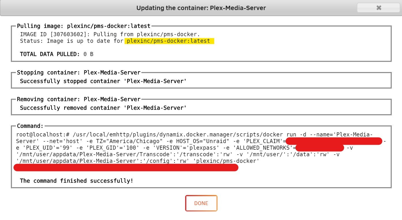

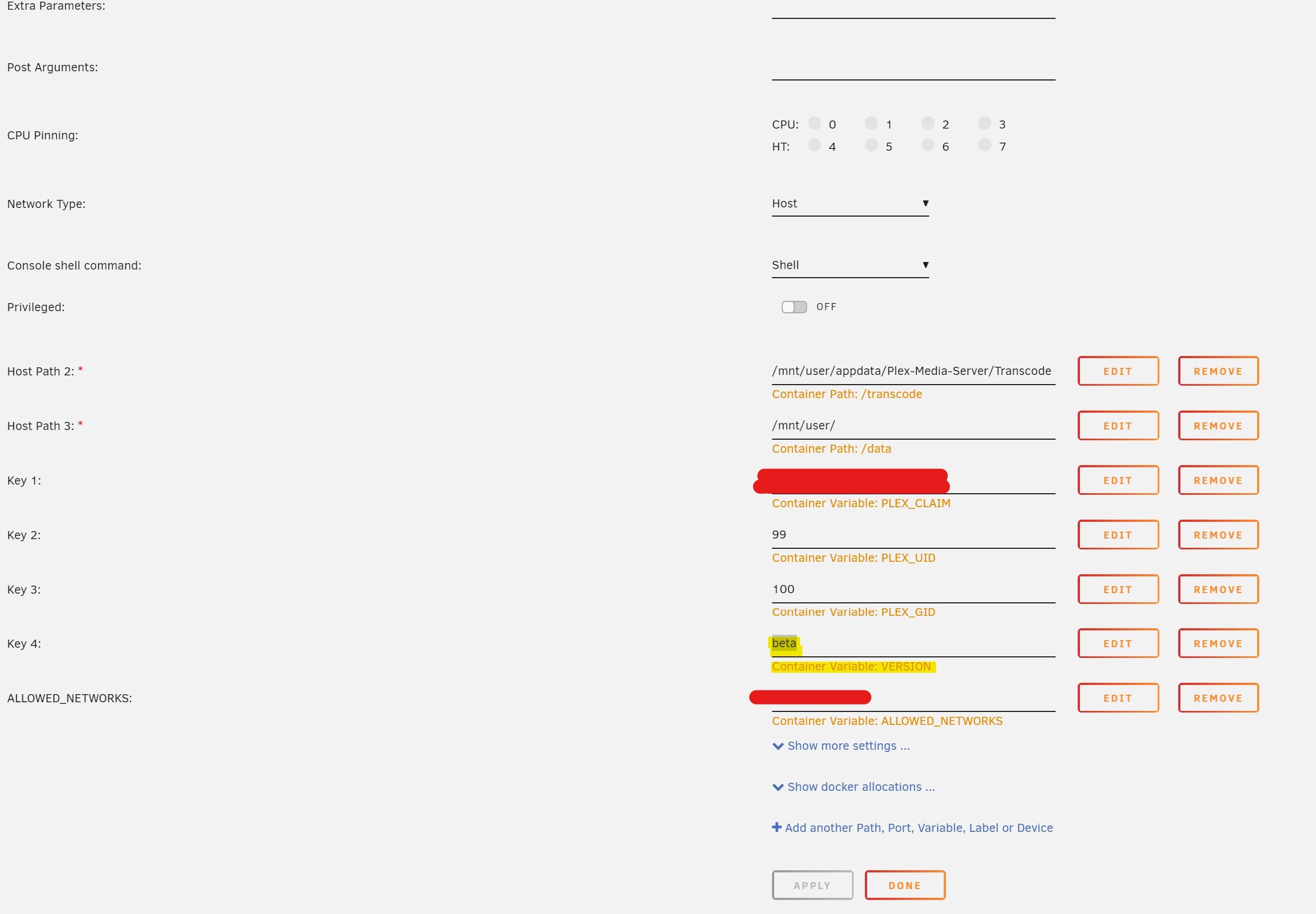

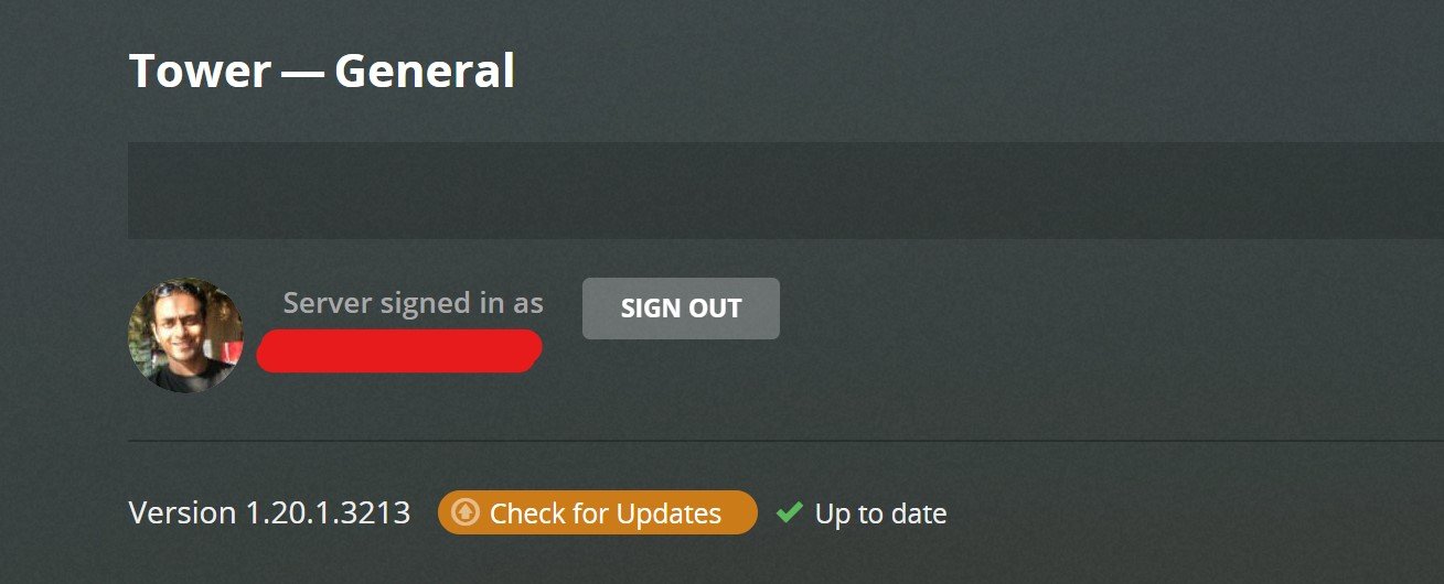

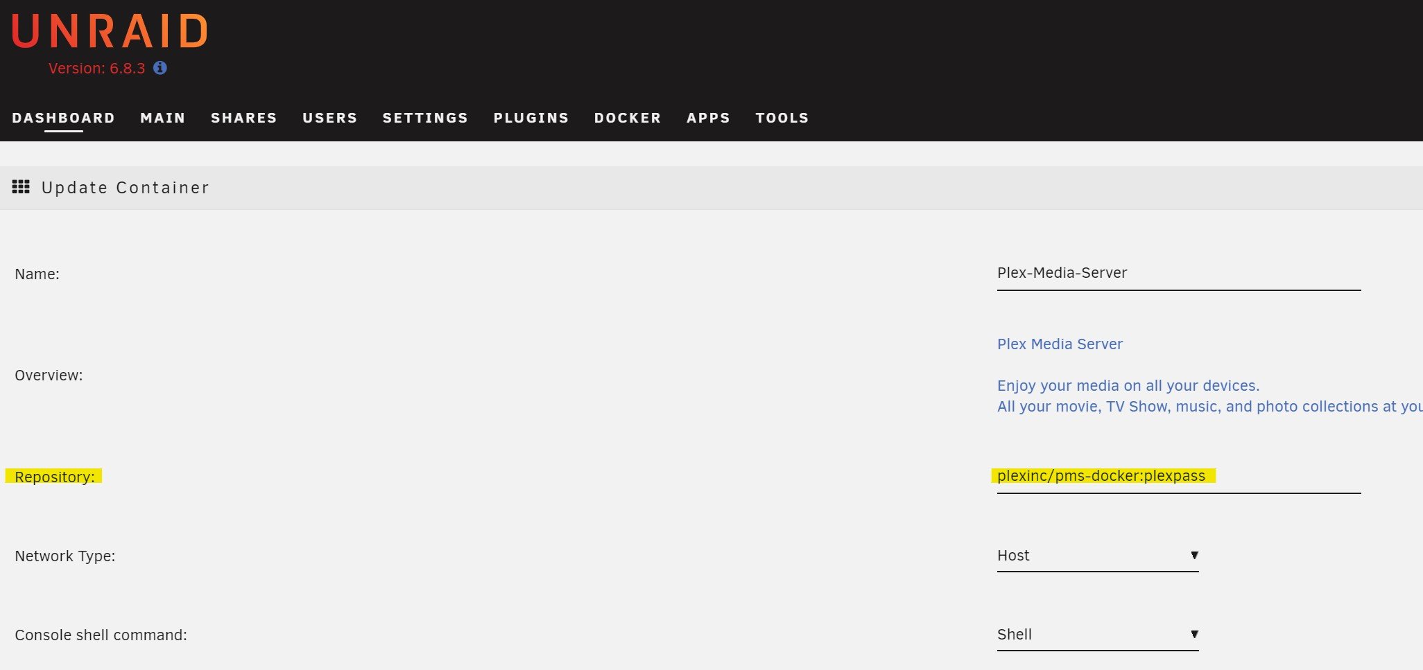

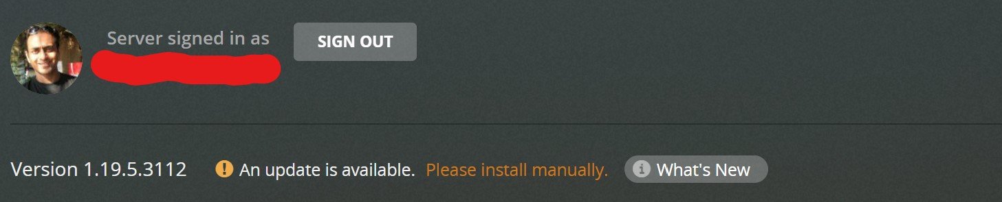

None of the docker containers were able to be accessed, and this just came to my notice, I believe it might have started sometime today morning. Everything was working fine about a couple of hours ago, I even updated Plex with the latest beta server version today morning, and have been getting pushbullet notifications from radarr and tautulli etc as recent as 45 minutes back. Now none of the containers can load because the docker image is inaccessible (read-only) it looks like, from what I can see in the logs. I tired stopped the docker service and tried to restart it but that fails, saying docker image location is read only - excerpt from the log below. No idea how and why the permissions got changed. I am on 6.8.3 (stable) Nov 23 11:29:42 Tower emhttpd: shcmd (1708): umount /var/lib/docker Nov 23 11:30:09 Tower login[15119]: ROOT LOGIN on '/dev/pts/0' Nov 23 11:34:46 Tower ool www[27234]: /usr/local/emhttp/plugins/dynamix/scripts/emcmd 'cmdStatus=Apply' Nov 23 11:34:46 Tower emhttpd: Starting services... Nov 23 11:34:46 Tower emhttpd: shcmd (1723): /etc/rc.d/rc.samba restart Nov 23 11:34:48 Tower root: Starting Samba: /usr/sbin/smbd -D Nov 23 11:34:48 Tower root: /usr/sbin/nmbd -D Nov 23 11:34:48 Tower root: /usr/sbin/wsdd Nov 23 11:34:48 Tower root: /usr/sbin/winbindd -D Nov 23 11:34:48 Tower emhttpd: shcmd (1736): /usr/local/sbin/mount_image '/mnt/user/system/docker.img' /var/lib/docker 100 Nov 23 11:34:48 Tower root: truncate: cannot open '/mnt/cache/system/docker.img' for writing: Read-only file system Nov 23 11:34:48 Tower kernel: BTRFS info (device loop2): using free space tree Nov 23 11:34:48 Tower kernel: BTRFS info (device loop2): has skinny extents Nov 23 11:34:48 Tower root: ERROR: unable to resize '/var/lib/docker': Read-only file system Nov 23 11:34:48 Tower root: Resize '/var/lib/docker' of 'max' Nov 23 11:34:48 Tower emhttpd: shcmd (1738): /etc/rc.d/rc.docker start Nov 23 11:34:48 Tower root: starting dockerd ... Nov 23 11:35:03 Tower emhttpd: shcmd (1740): umount /var/lib/docker Will post diagnostics soon. In the meanwhile can someone please provide some guidance as to why this happened and what caused this? Thanks.

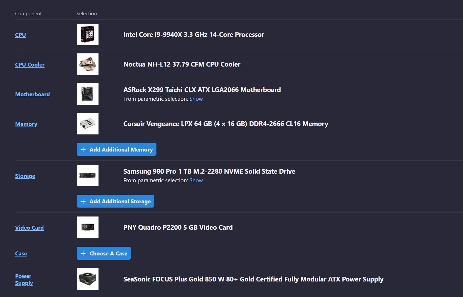

@iDashX Thank you for asking this. I understand this thread is almost a year old but wanted to reach out and see if this build is what you went with and how it worked out for you. Asking because, my use-case and specific needs are 99% similar to yours - Plex & Emby server on docker (need HW transcoding for both), Windows VM, MacOS VM (Catalina), HassOS VM and a bunch of dockers (mostly usenet and server monitoring related ones). Current server is a quad core (8 threads) and it is stretched pretty tight. The planned build is as below (pretty similar to what you have in the OP) - some of the parts are ones that I already have, and my existing case is a Norco RPC 4020. So just wanted some feedback on how this worked out for you, especially the CPU and the Board if you built it as planned above. All help appreciated. Thanks.
