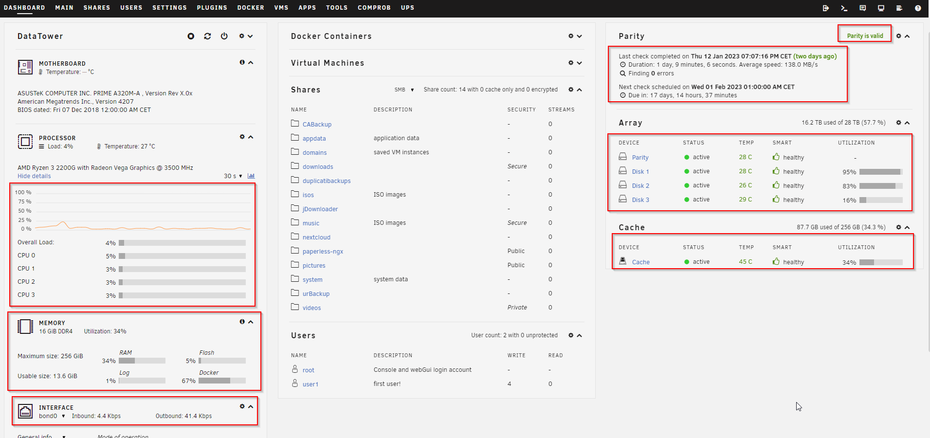

multiple problems since last start: missings stats on dashboard, missing disks on array, no info on parity, no diagnostics download
Hello! I'm on unraid 6.11.2 and my system went down 3 days ago (no idea why, no power shortage). after new start i saw parity check starting and i did not inquire further (no time atm). today i opened the dashboard and there are were several things missing: all the infos in the marked areas were missing (while i was typing the first lines of this post they came back)... i was not able to download diagnostics, also working again now. i saw these errors in the syslog: Jan 13 20:24:18 DataTower kernel: pcieport 0000:00:01.2: AER: Corrected error received: 0000:00:01.0 Jan 13 20:24:18 DataTower kernel: pcieport 0000:00:01.2: PCIe Bus Error: severity=Corrected, type=Data Link Layer, (Receiver ID) Jan 13 20:24:18 DataTower kernel: pcieport 0000:00:01.2: device [1022:15d3] error status/mask=00000040/00006000 Jan 13 20:24:18 DataTower kernel: pcieport 0000:00:01.2: [ 6] BadTLP Jan 13 20:24:18 DataTower kernel: pcieport 0000:00:01.2: AER: Multiple Corrected error received: 0000:00:01.0 Jan 13 20:24:18 DataTower kernel: pcieport 0000:00:01.2: PCIe Bus Error: severity=Corrected, type=Data Link Layer, (Transmitter ID) Jan 13 20:24:18 DataTower kernel: pcieport 0000:00:01.2: device [1022:15d3] error status/mask=00001040/00006000 Jan 13 20:24:18 DataTower kernel: pcieport 0000:00:01.2: [ 6] BadTLP Jan 13 20:24:18 DataTower kernel: pcieport 0000:00:01.2: [12] Timeout Jan 13 20:24:18 DataTower kernel: pcieport 0000:00:01.2: AER: Corrected error received: 0000:00:01.0 Jan 13 20:24:18 DataTower kernel: pcieport 0000:00:01.2: PCIe Bus Error: severity=Corrected, type=Data Link Layer, (Receiver ID) Jan 13 20:24:18 DataTower kernel: pcieport 0000:00:01.2: device [1022:15d3] error status/mask=00000040/00006000 Jan 13 20:24:18 DataTower kernel: pcieport 0000:00:01.2: [ 6] BadTLP Jan 13 20:24:48 DataTower kernel: pcieport 0000:00:01.2: AER: Corrected error received: 0000:00:01.0 Jan 13 20:24:48 DataTower kernel: pcieport 0000:00:01.2: PCIe Bus Error: severity=Corrected, type=Data Link Layer, (Receiver ID) Jan 13 20:24:48 DataTower kernel: pcieport 0000:00:01.2: device [1022:15d3] error status/mask=00000040/00006000 Jan 13 20:24:48 DataTower kernel: pcieport 0000:00:01.2: [ 6] BadTLP Jan 13 20:24:51 DataTower kernel: pcieport 0000:00:01.2: AER: Corrected error received: 0000:00:01.0 Jan 13 20:24:51 DataTower kernel: pcieport 0000:00:01.2: PCIe Bus Error: severity=Corrected, type=Data Link Layer, (Receiver ID) Jan 13 20:24:51 DataTower kernel: pcieport 0000:00:01.2: device [1022:15d3] error status/mask=00000040/00006000 Jan 13 20:24:51 DataTower kernel: pcieport 0000:00:01.2: [ 6] BadTLP no idea what this means. looks like everything is working for now but i think there is something wrong with my system... could somebody please take a look at my diagnostics? have a nice day! datatower-diagnostics-20230114-1024.zip
