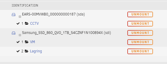

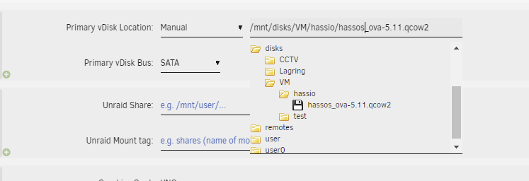

  17. I have 2 disks with 3 partitions and 3 Shares CCTV - one disk VM and Lagring - 2 partitions on 1 disk When UD mounts the disks the shares are in mnt/disks/VM etc..... This gives the following error see pic. I´m desperate as my Shinobi docker don´t work and my HA VM don´t work. You said that the best thing is to map to /remotes instead of /disks in VM and docker but I can´t as remotes is empty.

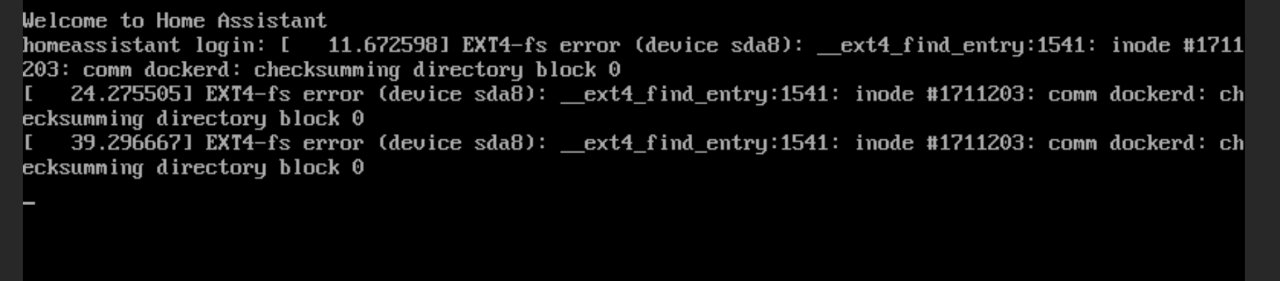

  18. Hi So I read that UD mounts to mnt/remotes but mine do not. I have tried the Leagacy mode and it did not help. I have tried to remove the UD and UD plus and made a reboot and install them again, but still the when I mount the disks (partitions) get under mnt/disks/..... The problem is that my Home Assistant Vm reports Ext4 errors and goes in emergency mode and my Shinobi docker won´t work (I have my CCTV recording mapped to an UD disk) I understand that some other have had this problem aswell but did not manage to resolve it. If I look under my HA VM I see a remotes path but its eamty. I do have a disks path with my stuff but it don´t work as stated above. How can I resolve this? Thanks in advance.
