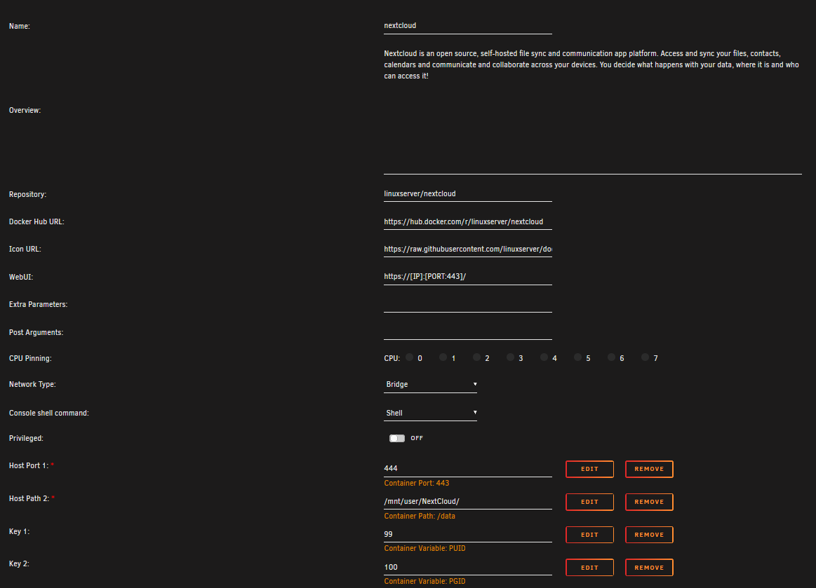

Ah right, yeah it definitely gives the correct IP when pinging it. Here is my docker template in advance view: Here is my config.php: <?php $CONFIG = array ( 'memcache.local' => '\\OC\\Memcache\\APCu', 'datadirectory' => '/data', 'instanceid' => '************', 'passwordsalt' => '*****************************************', 'secret' => '*************************************************', 'trusted_domains' => array ( 0 => '192.168.1.139:444', 1 => 'nextcloud.*********.net', ), 'dbtype' => 'mysql', 'version' => '20.0.7.1', 'overwrite.cli.url' => 'https://192.168.1.139:444', # 'overwritehost' => 'nextcloud.********.net', # 'overwriteprotocol' => 'https', 'dbname' => 'nextcloud', 'dbhost' => '192.168.1.139:3306', 'dbport' => '', 'dbtableprefix' => 'oc_', 'mysql.utf8mb4' => true, 'dbuser' => 'nextcloud', 'dbpassword' => '*********', 'installed' => true, 'trusted_proxies' => ['swag'], ); I did change the webui port to 444 as I noticed it was 443 in the advance mode, but still same issue, cant access via localip:port -

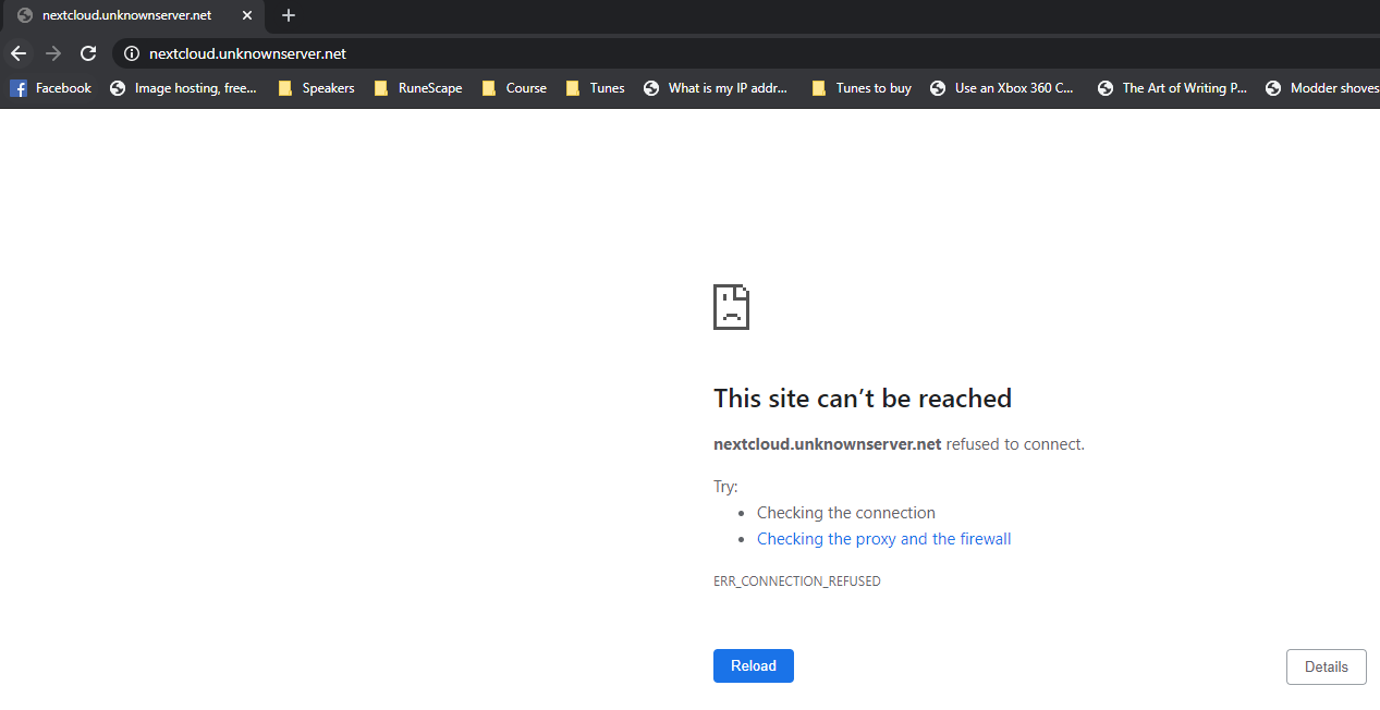

Heres what I get in chrome in incognito mode. Beginning to think a complete removal and fresh install is going to be needed soon ! -

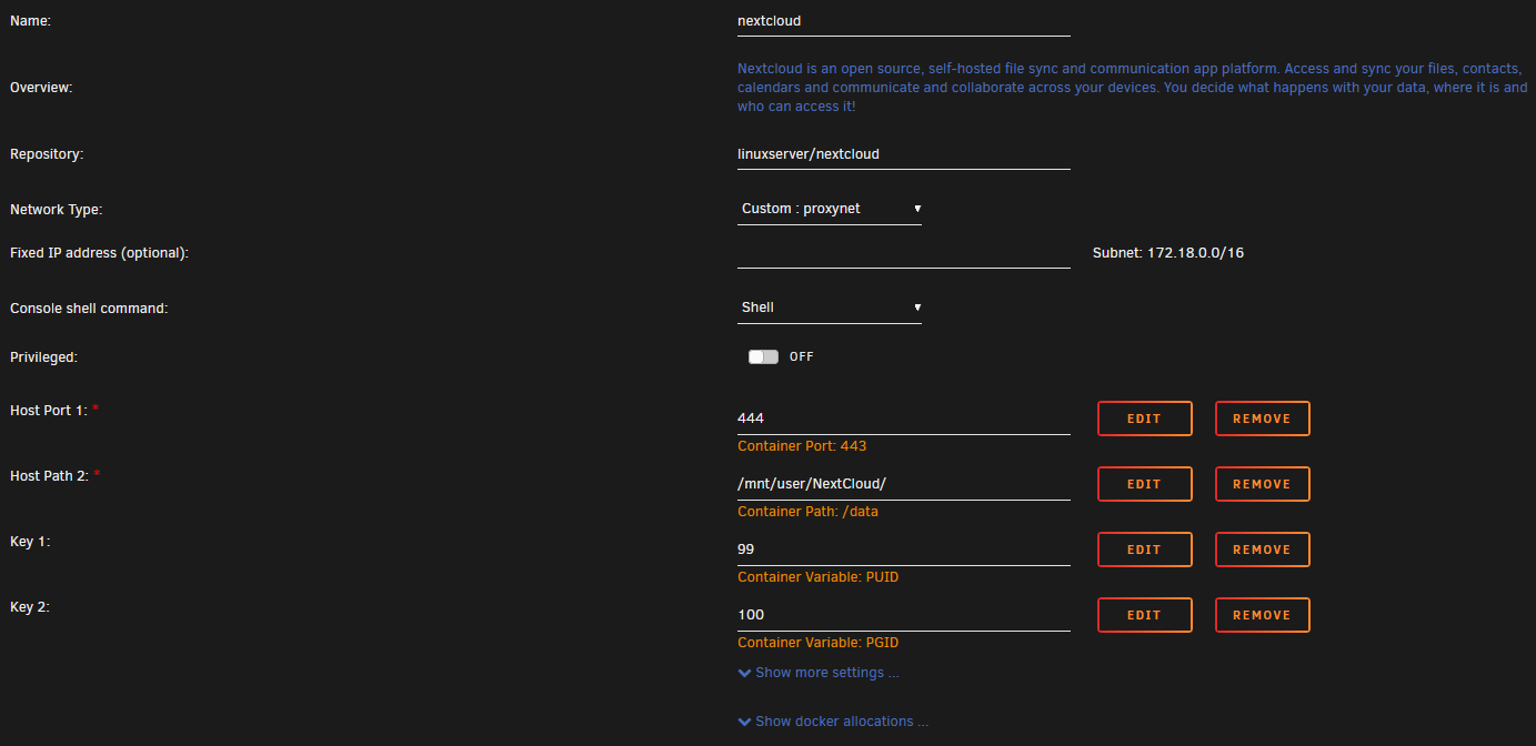

Hi Skois, This is the output of cat .htaccess: Also I've done the new permissions process and still same issue Which swag config is you want to see ? The one specific to nextcloud subdomain or one of these: Thanks, -Myles -
[Support] Linuxserver.io - Nextcloud
Myleslewis replied to linuxserver.io's topic in Docker Containers
Hi Skois, Above is my docker template, and I did actually try cd /mnt/user/nextcloud first but realised it's case sensitive my bad ! Here is the output: Thanks, Myles -

Hi Skois, I ran "docker network ls" and proxy net appeared. Mariadb, nextcloud and swag are all on "proxynet" when I visit localip:port I can't connect either. I'll fill the template to hopefully help in troubleshooting efforts: What problem you experience - unable to access nextcloud UI via reverse proxy or localip:port What error messages you get: My set is as follows - name: nextcloud mariadb swag repository: linuxserver/mariadb linuxserver/nextcloud linuxserver/swag Network - nextcloud - "proxynet" mariadb - "proxynet" swag - "proxynet" root@LewisServer:~# docker network ls NETWORK ID NAME DRIVER SCOPE 7c2cb36628ae br0 macvlan local 72623318ff91 bridge bridge local 8b453a111711 host host local 74282ed633f2 none null local 17997a39d39e proxynet bridge local Logs - Nextcloud: [s6-init] making user provided files available at /var/run/s6/etc...exited 0. [s6-init] ensuring user provided files have correct perms...exited 0. [fix-attrs.d] applying ownership & permissions fixes... [fix-attrs.d] done. [cont-init.d] executing container initialization scripts... [cont-init.d] 01-envfile: executing... [cont-init.d] 01-envfile: exited 0. [cont-init.d] 10-adduser: executing... ------------------------------------- _ () | | ___ _ __ | | / __| | | / \ | | \__ \ | | | () | |_| |___/ |_| \__/ Brought to you by linuxserver.io ------------------------------------- To support LSIO projects visit: https://www.linuxserver.io/donate/ ------------------------------------- GID/UID ------------------------------------- User uid: 99 User gid: 100 ------------------------------------- [cont-init.d] 10-adduser: exited 0. [cont-init.d] 20-config: executing... [cont-init.d] 20-config: exited 0. [cont-init.d] 30-keygen: executing... using keys found in /config/keys [cont-init.d] 30-keygen: exited 0. [cont-init.d] 40-config: executing... [cont-init.d] 40-config: exited 0. [cont-init.d] 50-install: executing... [cont-init.d] 50-install: exited 0. [cont-init.d] 60-memcache: executing... [cont-init.d] 60-memcache: exited 0. [cont-init.d] 70-aliases: executing... [cont-init.d] 70-aliases: exited 0. [cont-init.d] 99-custom-files: executing... [custom-init] no custom files found exiting... [cont-init.d] 99-custom-files: exited 0. [cont-init.d] done. [services.d] starting services [services.d] done. mariadb: Brought to you by linuxserver.io ------------------------------------- To support LSIO projects visit: https://www.linuxserver.io/donate/ ------------------------------------- GID/UID ------------------------------------- User uid: 99 User gid: 100 ------------------------------------- [cont-init.d] 10-adduser: exited 0. [cont-init.d] 30-config: executing... [cont-init.d] 30-config: exited 0. [cont-init.d] 40-initialise-db: executing... [cont-init.d] 40-initialise-db: exited 0. [cont-init.d] 90-warning: executing... ****************************************************** ****************************************************** * * * * * This image will soon be rebased * * from ubuntu to alpine. * * Please be aware, this may cause issues * * It is strongly recommended to make backups * * of your config and databases before * * updating your image to the alpine base. * * * * * ****************************************************** ****************************************************** [cont-init.d] 90-warning: exited 0. [cont-init.d] 99-custom-scripts: executing... [custom-init] no custom files found exiting... [cont-init.d] 99-custom-scripts: exited 0. [cont-init.d] done. [services.d] starting services [services.d] done. 210323 19:19:30 mysqld_safe Logging to syslog. 210323 19:19:31 mysqld_safe Starting mysqld daemon with databases from /config/databases swag: [s6-init] making user provided files available at /var/run/s6/etc...exited 0. [s6-init] ensuring user provided files have correct perms...exited 0. [fix-attrs.d] applying ownership & permissions fixes... [fix-attrs.d] done. [cont-init.d] executing container initialization scripts... [cont-init.d] 01-envfile: executing... [cont-init.d] 01-envfile: exited 0. [cont-init.d] 10-adduser: executing... usermod: no changes ------------------------------------- _ () | | ___ _ __ | | / __| | | / \ | | \__ \ | | | () | |_| |___/ |_| \__/ Brought to you by linuxserver.io ------------------------------------- To support the app dev(s) visit: Certbot: https://supporters.eff.org/donate/support-work-on-certbot To support LSIO projects visit: https://www.linuxserver.io/donate/ ------------------------------------- GID/UID ------------------------------------- User uid: 99 User gid: 100 ------------------------------------- [cont-init.d] 10-adduser: exited 0. [cont-init.d] 20-config: executing... [cont-init.d] 20-config: exited 0. [cont-init.d] 30-keygen: executing... using keys found in /config/keys [cont-init.d] 30-keygen: exited 0. [cont-init.d] 50-config: executing... Variables set: PUID=99 PGID=100 TZ=Europe/London URL=******************.net SUBDOMAINS=nextcloud EXTRA_DOMAINS= ONLY_SUBDOMAINS=true VALIDATION=http CERTPROVIDER= DNSPLUGIN= EMAIL=*****_*****@hotmail.co.uk STAGING=false Using Let's Encrypt as the cert provider SUBDOMAINS entered, processing SUBDOMAINS entered, processing Only subdomains, no URL in cert Sub-domains processed are: -d nextcloud.*************.net E-mail address entered: *****_*****@hotmail.co.uk http validation is selected Certificate exists; parameters unchanged; starting nginx Starting 2019/12/30, GeoIP2 databases require personal license key to download. Please retrieve a free license key from MaxMind, and add a new env variable "MAXMINDDB_LICENSE_KEY", set to your license key. [cont-init.d] 50-config: exited 0. [cont-init.d] 60-renew: executing... The cert does not expire within the next day. Letting the cron script handle the renewal attempts overnight (2:08am). [cont-init.d] 60-renew: exited 0. [cont-init.d] 70-templates: executing... [cont-init.d] 70-templates: exited 0. [cont-init.d] 99-custom-files: executing... [custom-init] no custom files found exiting... [cont-init.d] 99-custom-files: exited 0. [cont-init.d] done. [services.d] starting services [services.d] done. Server ready App Logs - The text in this file is very very long and not formatted in lines at all, I have attached the log file. occ status: - installed: true - version: 20.0.7.1 - versionstring: 20.0.7 - edition: occ maintenance:mode - Maintenance mode is currently disabled app config - <?php $CONFIG = array ( 'memcache.local' => '\\OC\\Memcache\\APCu', 'datadirectory' => '/data', 'instanceid' => '***************', 'passwordsalt' => '*********************************', 'secret' => '**************************************************************', 'trusted_domains' => array ( 0 => '192.168.1.139:444', 1 => 'nextcloud.*************.net', ), 'dbtype' => 'mysql', 'version' => '20.0.7.1', 'overwrite.cli.url' => 'https://nextcloud.*************.net', 'overwritehost' => 'nextcloud.****************.net', 'overwriteprotocol' => 'https', 'dbname' => 'nextcloud', 'dbhost' => '192.168.1.139:3306', 'dbport' => '', 'dbtableprefix' => 'oc_', 'mysql.utf8mb4' => true, 'dbuser' => 'nextcloud', 'dbpassword' => '**********', 'installed' => true, 'trusted_proxies' => ['swag'], ); apologies for the long post ! Thanks, -Myles nextcloud.log -
