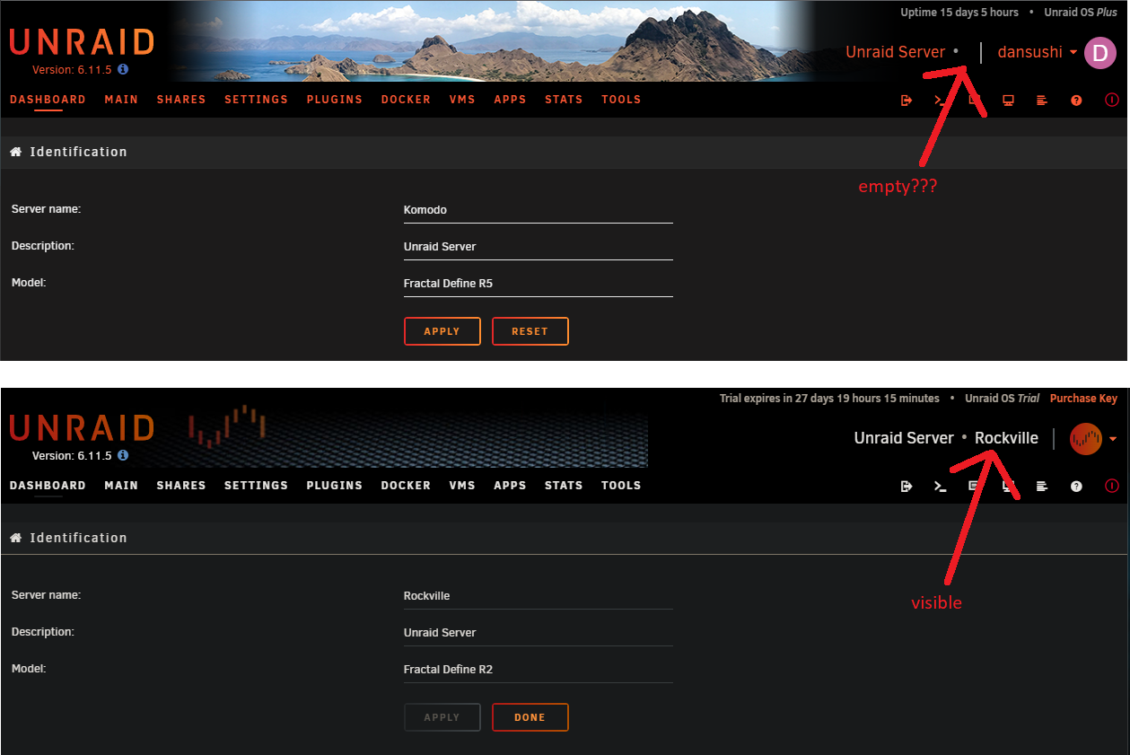

Server Name invisible (only on one machine)
Just tried it in Safe mode and it's working! So what would be the best way for me to determine the cause of this? Could it be a plugin or docker causing it?

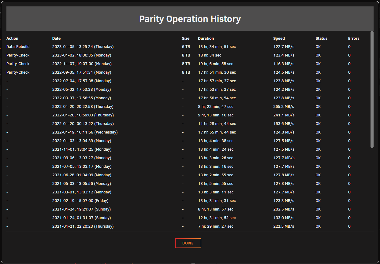

Parity Operation History - Action and Size are EMPTY
I see, that makes sense. so this should begin to retain that Size and Action information going forward?
I'm wondering why the Action and Size columns don't have any information for more than 6 months ago. Is this intended, and if so, why? Is it possible to fix it?

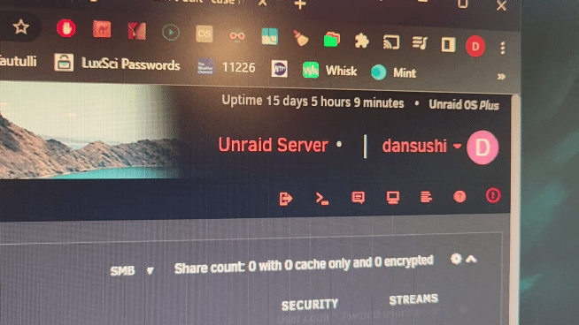

Just checked in Chrome Incognito and Firefox and same issue there.
I just set up a 2nd Unraid system, and just noticed that the Server name and Description show up correctly on the top-right nav bar. I never noticed it because I only had one server before, but the server name never showed up properly on my original server. I didn't know it was even supposed to until I set up this second one. I changed the name from "Komodo" to "Komodo1" and then it shows up correctly. However, I want the name to actually be "Komodo" so I changed it back and lo and behold it disappears again. I then noticed upon hitting F5 a bunch of times, then "Komodo" DOES show up! But only for a fraction of a second and then disappears. Why would this be happening on one server and not the other?
