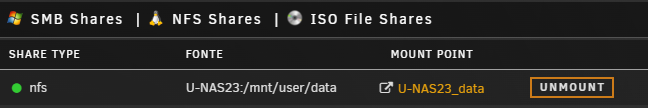

Hi @dlandon THX again for the support! After reboot it takes about 2 minutes to mount but it worked. I am posting the setup now on both servers. Thank you very much! Take care! Braz.

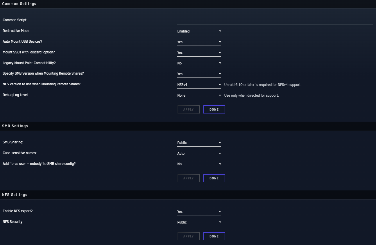

Hi @dlandon Thanks again for the support! I turn off the UD debugging. I will share the prints i have in my system. Surprisingly the last time i reboot the system all goes well. I do not if takes some time for unraid "find" the other PC in my network. I will monitor this and keep all logs if happens again, i will post. Thanks! Braz.

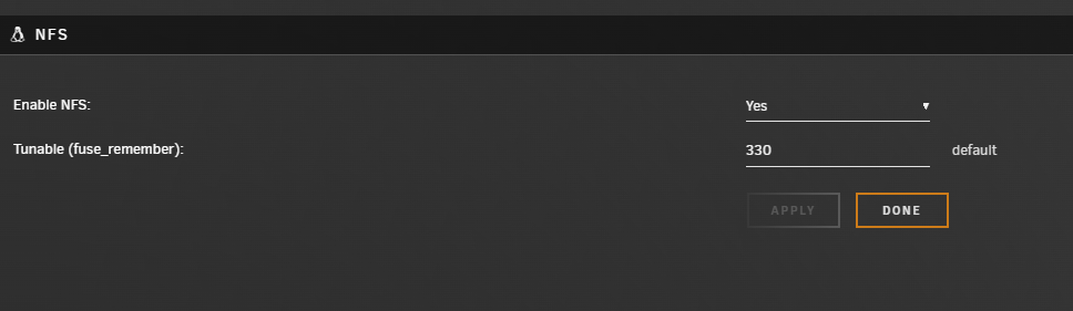

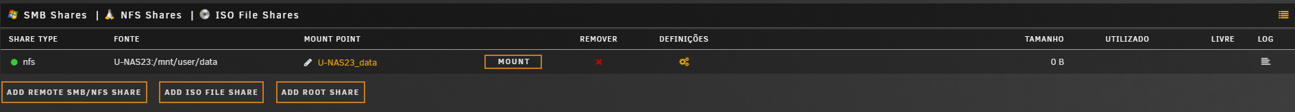

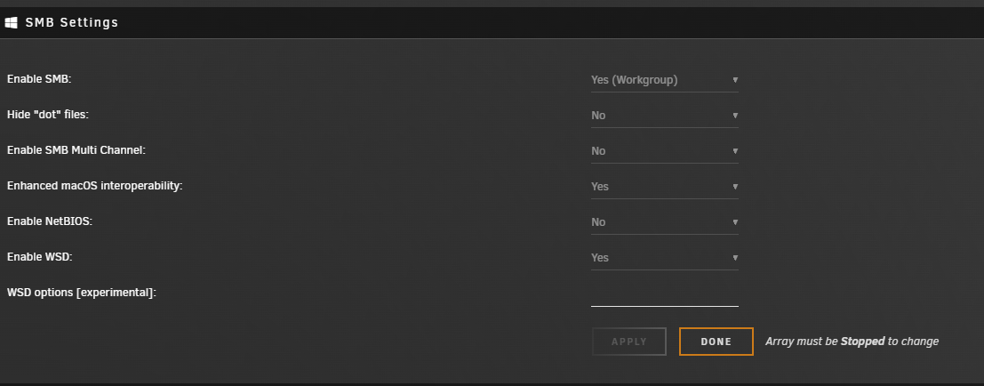

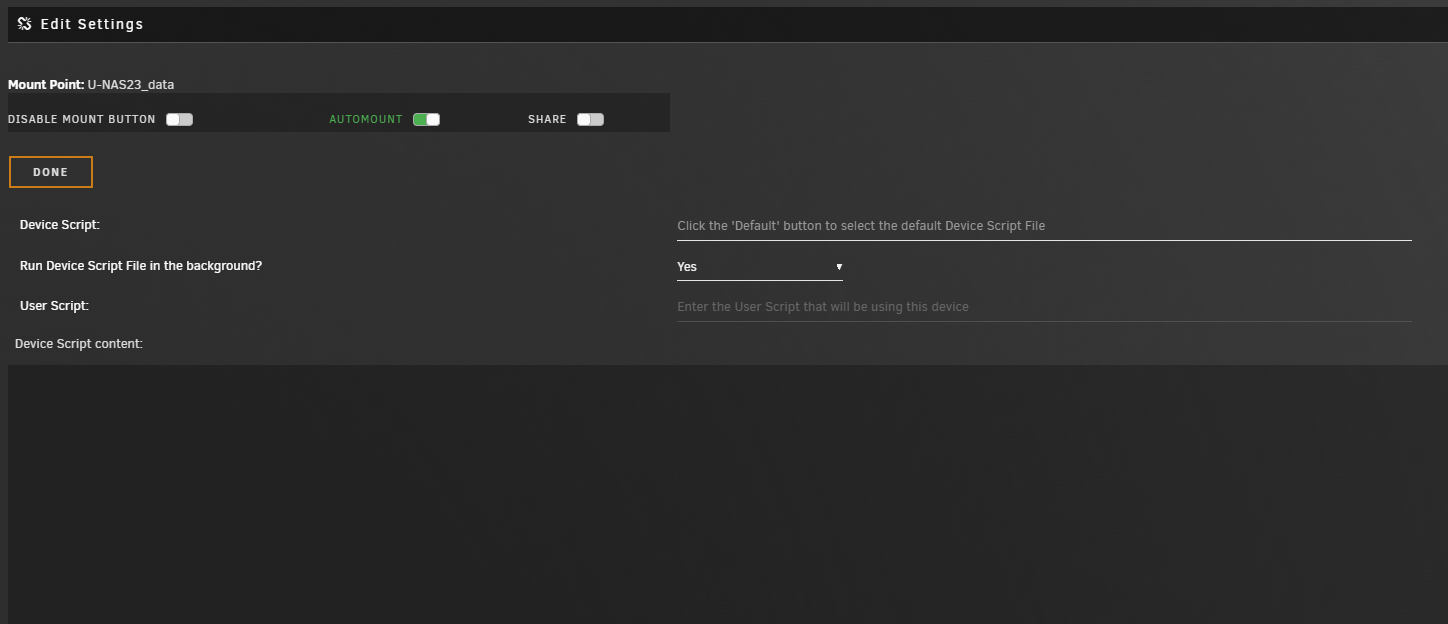

Hi Everyone! Here is the scenario: I have 2 unraid servers ("main" and "NAS") running ver 6.11.5 with the latest UD plugin. The share "data" was created on both servers and set as public. The SMB and NFS are enable on both servers and it is able to see and mount the share. The problem is that after enable the automount button the share does not load when any of the systems reboot. The mount button freeze (do no respond) and i am forced to remake the whole share. I have already changed all setting in UD but with no sucess ): The use for this shared folder is because i do not have more space in my main server cage and just have build another one as a "NAS" system. The main goal is to have access to all files in "data" folder in "NAS" from my "main" Unraid server. Can somebody please help me to solve this issue? Thanks everyone for the attetion! Braz.
