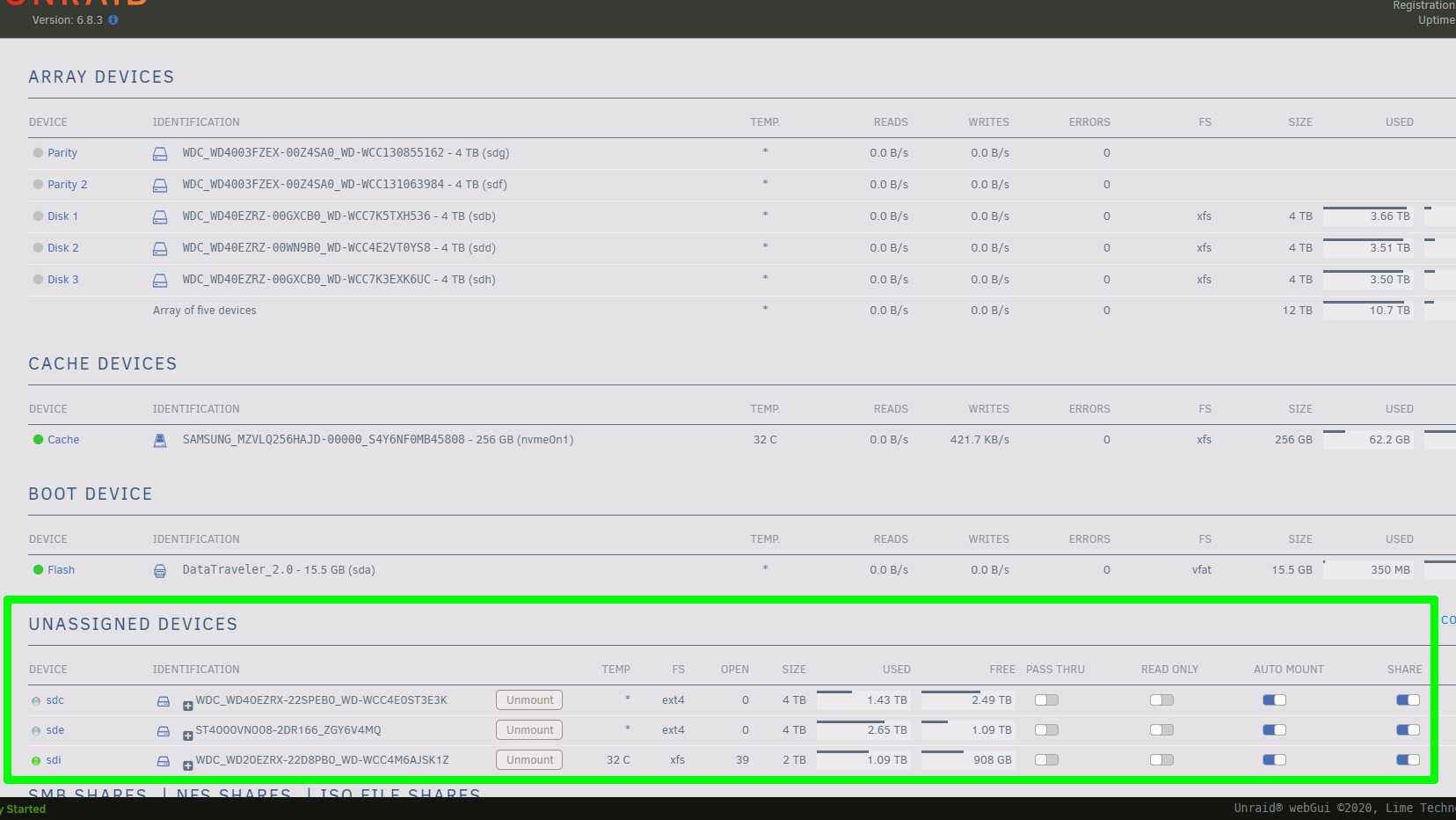

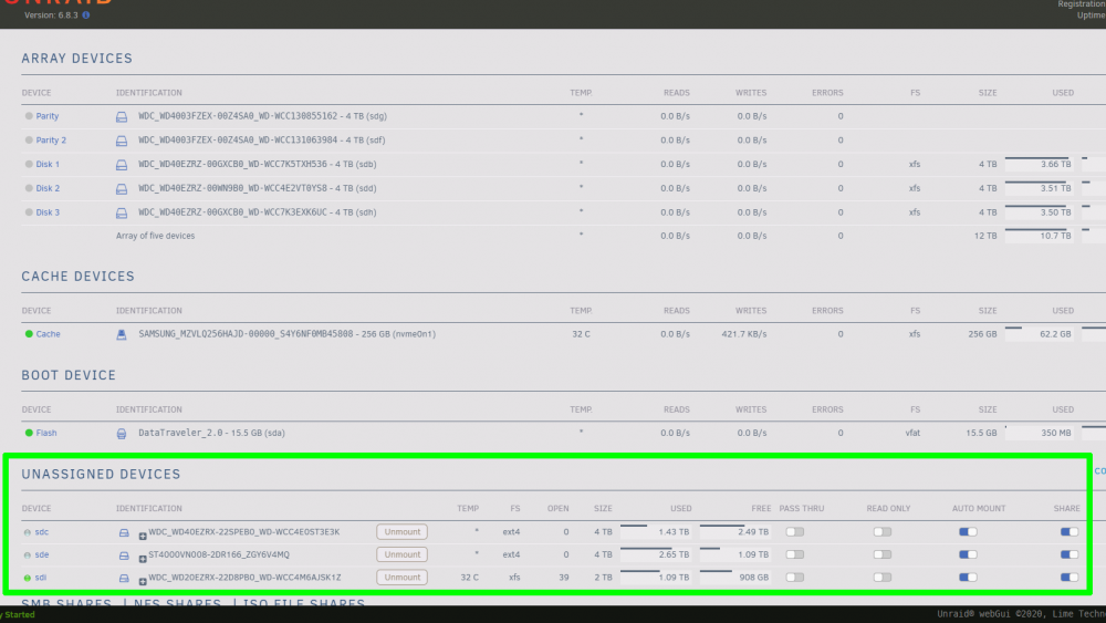

  7. Yes I get that you can set samba user access via the UI (for array shares and UD). The array shares won't force the "nobody" user on me tho (I attached a video for reference). All I'm wondering why UD has to behave differently in this regard? Why limiting the options for advanced users for no good reason? (or is there a good reason?) The unix group is "users" for everyone accessing via SMB if you want common permissions, why have a redundant "nobody" user that is of no use and just behaves differently than shares on the array? Why make administration more difficult? Why do I need a custom script that removes this unnecessary option and why can't I just check a box in the UI to do so? Don't get me wrong, I really appreciate your plugin. I just haven't found a good reason (nor did you give any) for why it has to be different. 2020-06-01 13-50-08.mkv
  8. I only use the shares in the local network but there are four people using them. That is just for the UD shares, not the ones on the array. I just want more fine grained control over who can delete files in specific folders. If I execute this: #!/bin/bash for file in /etc/samba/unassigned-shares/*.conf; do sed -i '/Force User = nobody/d' $file done (It also has some other logic to determine if the config was changed to then reload samba) I get exactly the fine grained control over the write permissions that I need. I can have a folder with 755 permissions that others can read but only I can write to.
  9. But it controls the Unix user used. I'd like not to use the "nobody" user but the username of the account that accesses the share. The regular Unraid shares also do it that way, so why use " nobody" for UD shares?
  10. How to disable the "Force User = nobody" option for SMB shares? I want to use the actual usernames on those shares (like with regular Unraid shares) and not the "nobody" user. In general more control over the SMB settings would be nice (e.g. changing the share name or permissions for individual drives and not all of them). Or am I just blind and not seeing those options?
