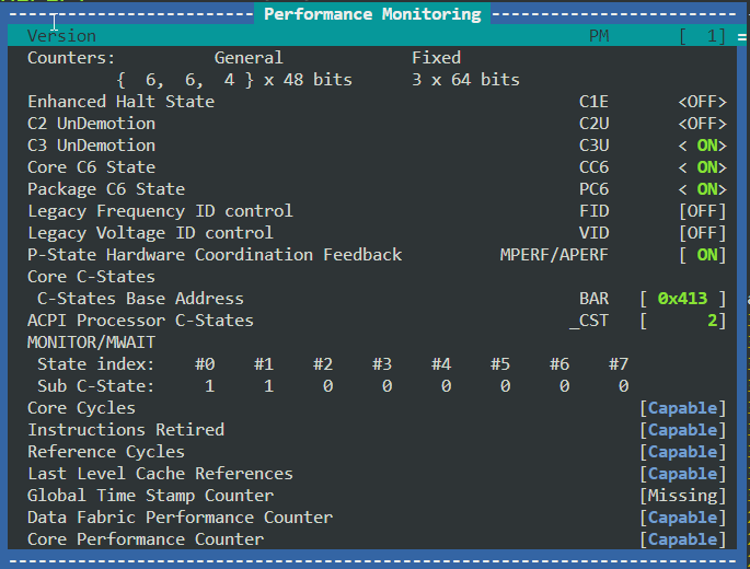

  6. how is your experience on that TUF series board? i managed to get power usage down to about 72 watts when full idle with 20 dockers alive and 4 HDs connected 1 spun down. had to update to the new 6.12 RCs to see if the new kernel would make a difference on the C state but so far nothing..
  7. I've enabled intel C-State and set it at C10, I've also enabled C1E support, and enabled Speed Shift.. all those changes enabled the extra C3_ACPI state, but i'm just scratching my head as to there only be only 3 c-states?

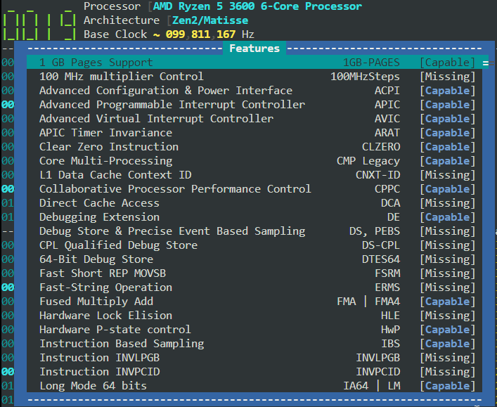

  10. hello folks! been reading through this entire thread and man is it a bunch of info 😂 I have managed to get C6 states set via the registering of the Governor, CPU-FREQ, CPU-IDLE, CPU-IDLE everything works well there.. i just have two questions: 1) how can i get these to be registered and set on start up? For now it seems i need to go into the corefreq-cli and register and set my c6 state capability every startup? anyway to get it to auto configure? 2) i have a 3600 matisse core and for all intensive purposes looks like i'm CPPC capable, BUT when i go into perf. monitoring i do not see anywhere where you can set CPPC like where @CyrIng mentioned above. I'm currently on the public 1.95.5 version and have the following kernel settings I have also done the changes to syslinux.cfg BUT have NOT enabled the modprobe amd_pstate since enabling that modprobe setting does NOT allow me to set CPU-FREQ driver to corefreq since its would already be occupied by amd_pstate. Funnily enough i also have an asrock B550M-pro4 board. I have tried the CPPC to auto AND enable no differences on latest 2.32 bios FW. If you need anymore info please let me know! -Syaoran
